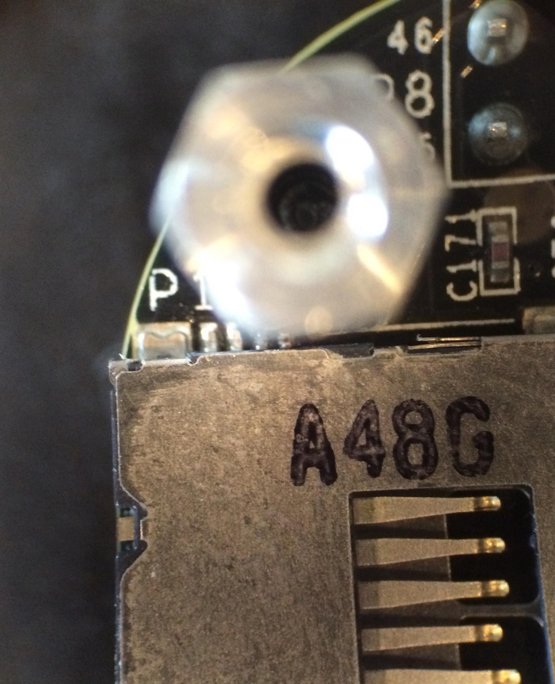

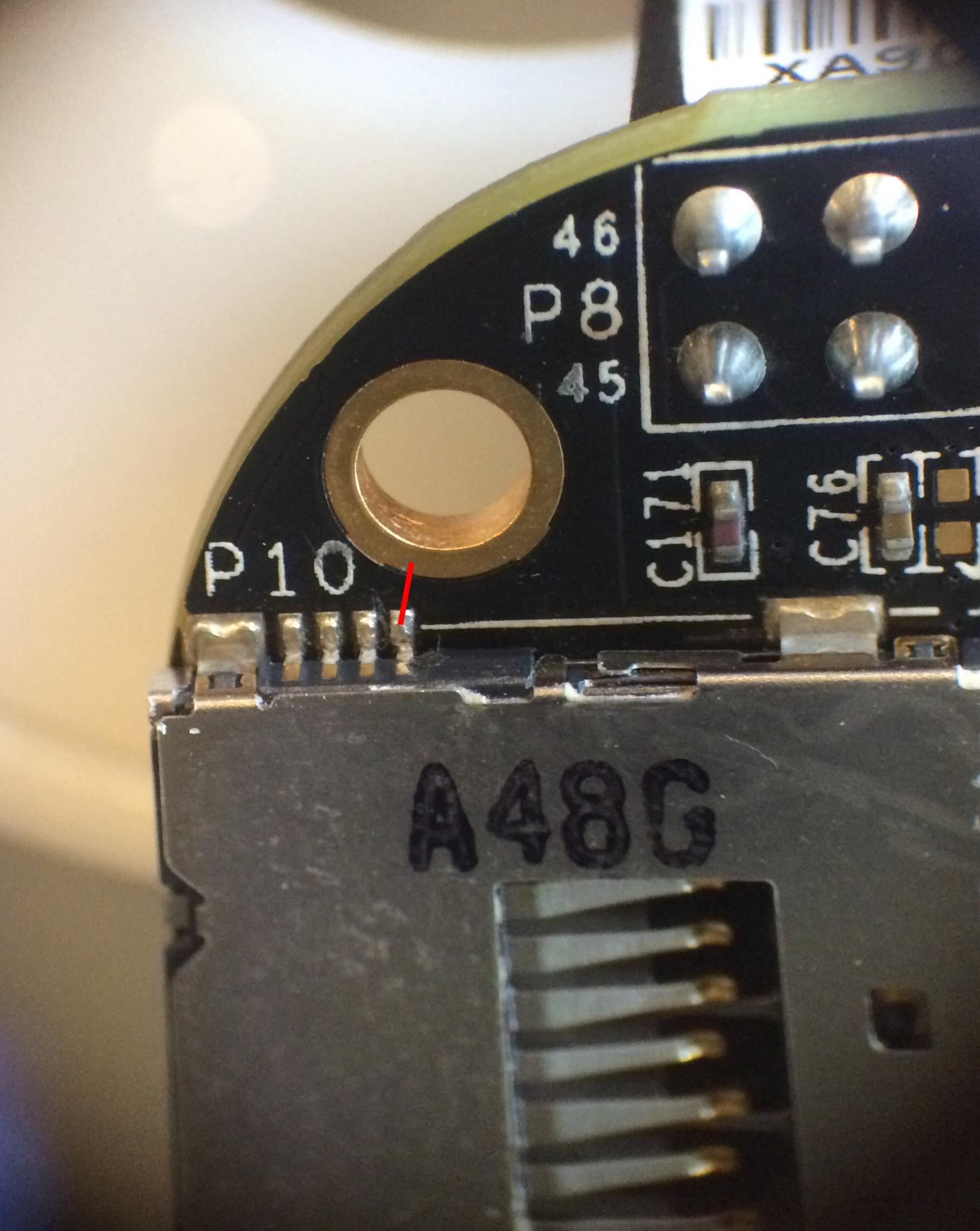

I believe the uSD card readers on 2 of my 3 boards are faulty most of the time, because when they crash it is after the blue uSD access LED has been on for an extended period.
Researching the microSD card issue, I checked the solder pads under a binocular scope. I was surprised to find physical contact had been made between one uSD card reader pad and the stock TPA aluminum standoff that was usually in place on the BBB. That would ground the pad. At worst, two reader pins could even be bridged, though I'm sure that didn't occur. So be aware of the standoff type/placement on BBB! :guilty:
