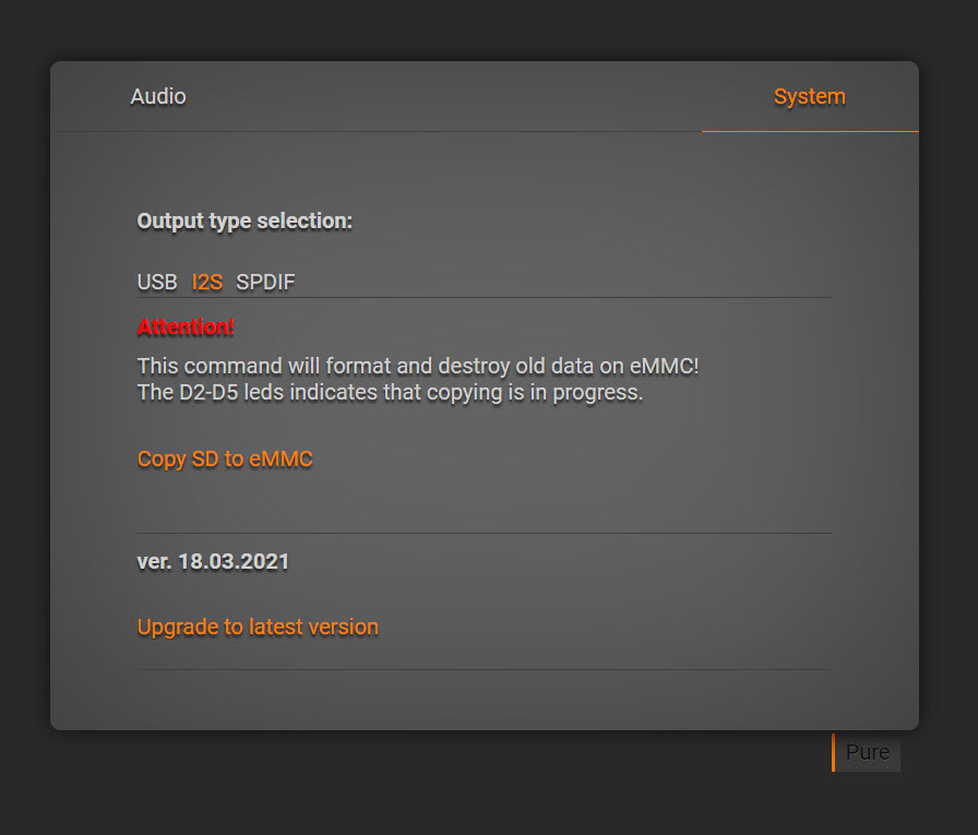

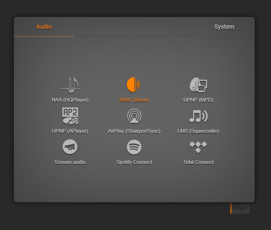

You can get acquainted with the beta versions: Botic7 — Yandex.Disk
Description and changelog in Russian. But for the release, I will prepare documentation in English.
Temporarily support for this firmware on the Russian forum:
Сетевой плеер на Beaglebone Black — чистое удовольствие - Цифровые источники - DA Stereo
In the near future I will make partial support for WiFi USB.
