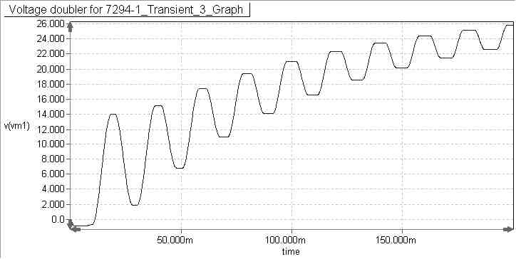

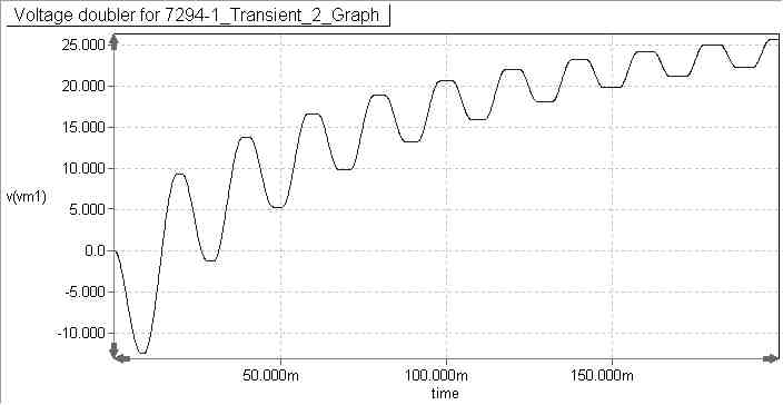

I'm attaching the voltage build up plot across one of the capacitors , C1.
Without the diode D5 and with the diode installed. Any ideas on that ?
Thanks.

You will find that as the supply switches on , the initial current flow through the capacitor C1 will reverse charge it ( junction with diode D1 and D3 will be -ve) by an amount depending on the ratio of C1 and C3 and the current flow. On subsequent cycles the capacitor C1 will get charged such that the side connected to the junction of diodes D1 and D3 will be positive. After that the voltage across C3 keeps ramping up till it reaches close to double the peak supply voltage. Subsequently C1 will always be positive at the junction of the diodes D1 and D3 .There are some drops in the circuit and other losses and so it will never reach the full doubled voltage. Any load comes in parallel with C3 and hence the greater the load ( more mA) the lower the output voltage. The circuit has it's uses and it's limitations.
Now the "question" was , "are the diodes D5 and D6 of any use ?".
On further reflection I think the appropriate answer is that it does cut out the reverse voltage across C1 or C2 to a diode drop for the first cycle or so. But since this happens briefly only at switch on and not after the circuit is operational plus it happens for just one or two half cycles ( 20 mS), it can be dispensed with. It shouldn't have enough time to cause any problems.
There the problem is solved .😉

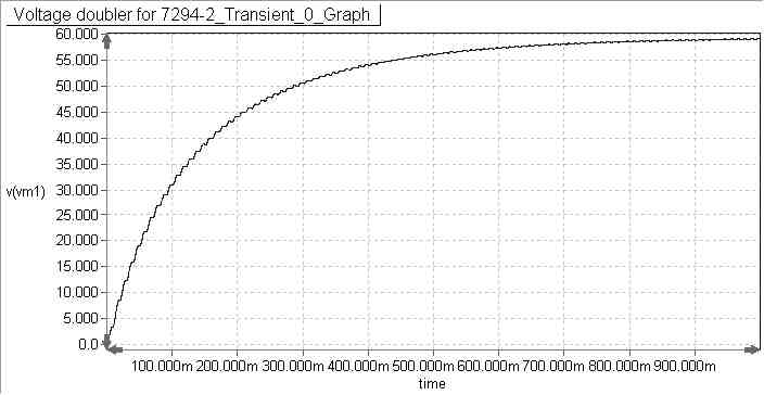

The attachment shows the voltage build up plot with a 30-0-30 V (peak) 50 Hz supply.

The existing supply is about +/- 35 Vdc .
The doubler circuit provides about +/- 60 odd raw volts . This is filtered and regulated to provide about +/- 37 V dc to the input stage.
The original unregulated supply is of course required to power the output stage . The input stage however now gets a cleaned up supply .
