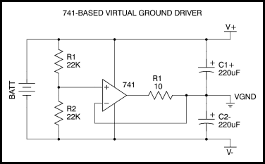

I want a dual supply from a single battery. In my previous circuit, I was very happy with the TLE2426 from TI, but now I'm searching a solution in SMT, which wil require few space.
Are there other (good) single chip solutions which can be used to power an op-amps?
The circuit to power is a stereo mic preamp and draws 6mA or less, with a voltage between +-1.5V and +-4.5V.

... If not, I think about using a simple circuit like the following, just with an op-amp with less current consumption. If possibly someone had hints on improving the circuit I'd be thankful too!

What is R1 for? Stability?

And, what R1 in the second schematic is for, I don't know, I found that circuit on the given site! I imagine that it is for damping the regulation.
I'd venture it is there to prevent oscillation; although I'm not sure what kind of oscillation could happen with a slow AOP in unity gain...

(R1 = 10 ohms) It's for some protection but makes also the opamp less sensitive against capacitve load.Dominique said:And, what R1 in the second schematic is for, I don't know, I found that circuit on the given site! I imagine that it is for damping the regulation.
