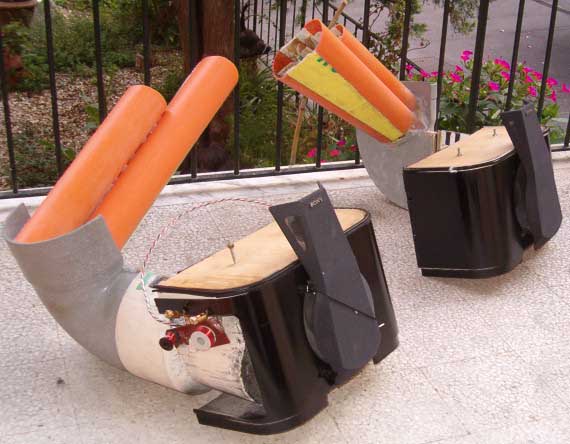

I was in a hurry...searching for the usb camera cable,resizing...the picture actually is a fake , the tweeter cable (oh!awesome) being put there for fashion,the right box with no crossover." Man! That inductance sucks ,less than 1mm diameter , surely crappy bass"
The back panel is covered with a lead panel , I did put 5mm bitumen panels in the main chamber last summer though I didn't listen to them yet , but surely that treatment is a BIG improvement , like my ego raising with this thread . At least I'm on the way of finishing them.
Happens to be in The Fullrange Forum , well , the tweeter was added after I damaged 1 of the 2 original Pioneer speakers , 4 ohm , voice coil scratching , then received 2 RCF speakers , more massive magnet and construction (not to mention the foam instead of treated silk ) same 6 1/2 inches. They know how to make vibrating a 4 mm plastic box .The box is tightened by the two long metal barrels ,from bottom to top , and the second part of the horn ( ok : I didn't know exactly what was I doing , I had TL in mind but more attracted by horns ) is detachable using the common tube insertions . They are very light indeed ,only 4 pieces to move !
Connected to a 100 w mosfet amp i bought in Bangkok (they should have put fuses in it!) they did , and I hope will , ROCK!
