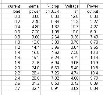

I would use the art0 tripath modules.
This would be my supply:
a regulated powersupply WDU12-1900 - TRIAD MAGNETICS - AC-DC CONV, EXTERNAL PLUG IN, | Newark/element14 Canada
then:
PSU Jack -> 3.3 Ohm -> 1,000uF Silmic -> choke -> 1,000uF Silmic ->
Supply to my amps DIY! HIGH END! AUDIOPHILE AMLIFIER BASED ON THE MOST ADVANCED TRIPATH 'S CLASS-T TA2021B CHIP!
What do you think?

ok, and I need more like 13v in the supply of the module to get the best performance right?With a 3.3R in the power supply line you will only ever get 10.9W from that supply.
I understand you want to add to the filtering but there is some math involved here.
see table

well the designer says to absolutely not give more the 14.6v to the modules... If I just drop the resistor, what should be the voltage? 12 v?
Yes, just get rid of the resistor.
However, I just checked the datasheet for the power supply you linked to.
There may be a problem using it on this IC.
It is an unregulated output. (I had thought it was regulated)
The open circuit or unloaded output voltage might exceed the 16V rating of the IC.
The output is 12V NOMINAL, when LOADED @ 1.9A.
To test, load it with a 200R resistor and measure the voltage.
I personally would not use it without safeguarding the IC to about 14.5V.

thanks for your help. Ill then get a regulated psu. is that what you would do? What voltage should I get if I go regulated?
