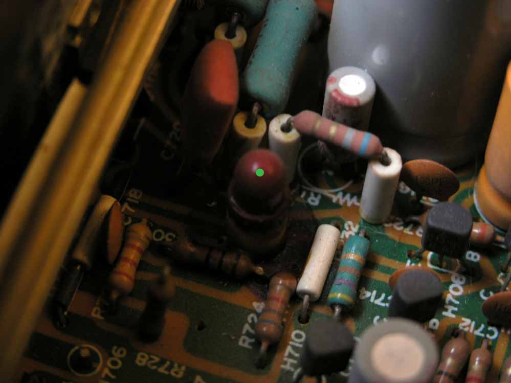

I have a very nice sounding superscope R-1220 reciever.
Just now, the right channel lost allmost all it's volume and sounded distorted.
After all the regular checking an measuring, I decided to play it with the lid off.
There was an unfamiliar component glowing orange inside.
I marked it with a green dot on the attached pic.
Anybody knows what it is and if i can replace it?
Thanks a bunch!

Hi beamnet,
I'm pretty sure that's a lamp. That is from memory as I have serviced many in the past. Not so many these days.
Your Superscope is a nice little receiver. They look nice when clean. They were a less expensive line to the Marantz line that Superscope distributed.
Anyway, on to repairing this. You have excessive current flowing through the lamp. Do not run the receiver any more. You need to repair the faults. I have never had to replace one of these lamps, so I can't help you with the type number. Probably a 40 mA bipin of some kind.
If you are not familiar with repairing equipment, proceed with extreme caution. It would be a shame to see this nice little set die needlessly. If you send it out for service, look for a tech who is familiar with Superscope. That tech will be 45 ~ 65 years old most likely and may work from home by now.
To service, test each and every transistor in that channel carefully. You need a good transistor checker, like a Heathkit IT-18 (measures both leakage modes). May as well replace the capacitors by now. Measure all the resistors in the output/driver section. Replace them even if they are only discoloured. Use a variable power supply or variac (variable AC transformer) to power it up for testing. This will prevent further damage. Don't even try to power it up until you have replaced the blown components.

Hi beamnet,
The lamps do not normally glow. An open filament is possible, but not glowing is normal for that circuit.
