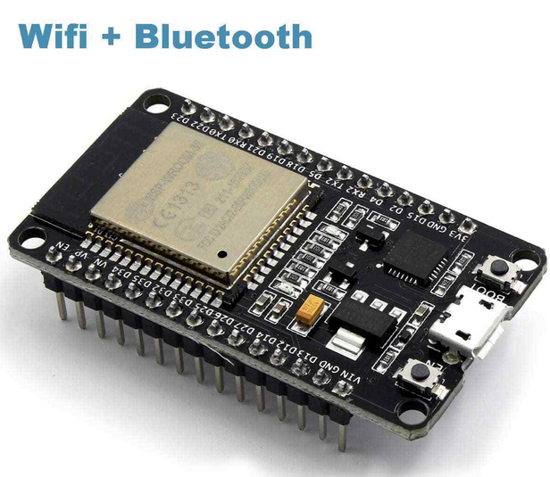

In meantime, TNT trigged an old idea i had making a wireless media/volume controller so i bougth this from Ebay; but hey it's offtopic sry...
Espressif esp32 Wifi Dev Kit development board Bluetooth WiFi v1 Factory 32 nodemcu | eBay
Let's see if i can make it a fun winter-project 😛
