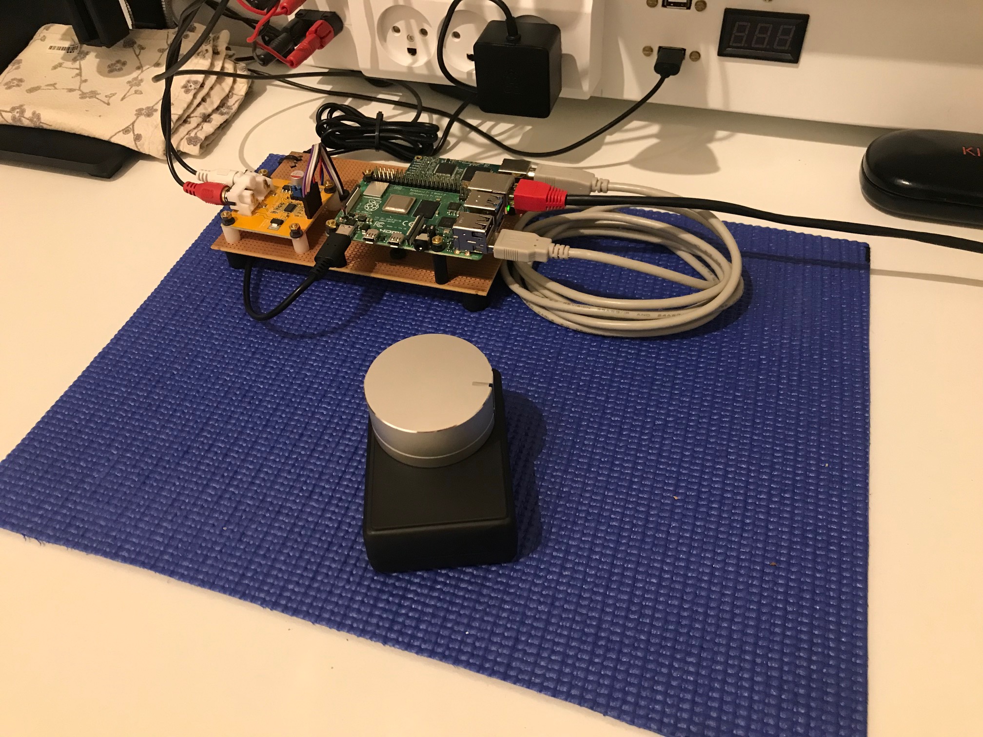

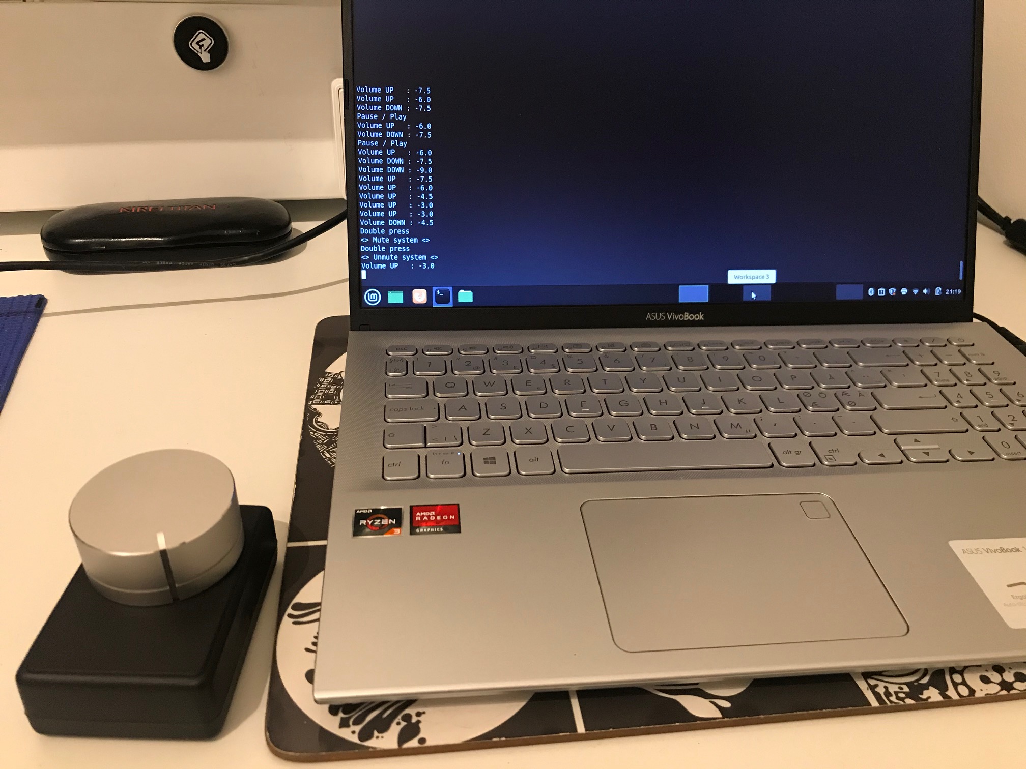

Hey all...
I'am developing a remote controller for the "SuperPlayer" or whatever used.
This is just a teaser, but i am testing it right now in "real life" for fun 😛
Thing's which are working ::
Batterypowered ESP32 (this is a very good gadget!) Adafruit HUZZAH32 – ESP32 Feather Board ID: 3405 - $19.95 : Adafruit Industries, Unique & fun DIY electronics and kits
BLE (Bluetooth low energy) is sending volume up/down (either lms volume or camilladsp volume), play/pause with single click on encoder & double click toggles mute/unmute.
It seems to be working very stable, with battery... I don't know how well this works for long time testing yet. - The ESP goes into "deep sleep" mode after 1hour of operation. - Still lot's of things to work with 🙂 ... But sure it's fun to do!
Jesper.
Jesper.

As it is now, the following thing's are working ::
A) Pretty fast - actually very good responce when turning volume up/down, pause/play and mute.
B) ESP goes to deep sleep after 60min when not used - Working good enough.
C) When pressing a "long" press, remote is sending play/pause + the voltage of the battery. - Also work's as expected
D) Every time the ESP32 is awakened after sleep a counter is triggered and the number is pasted in the homedir. (This can be read along with the battery voltage by sending a ssh remote command, which i do from my phone and see the results) - Works good as i intended 🙂
