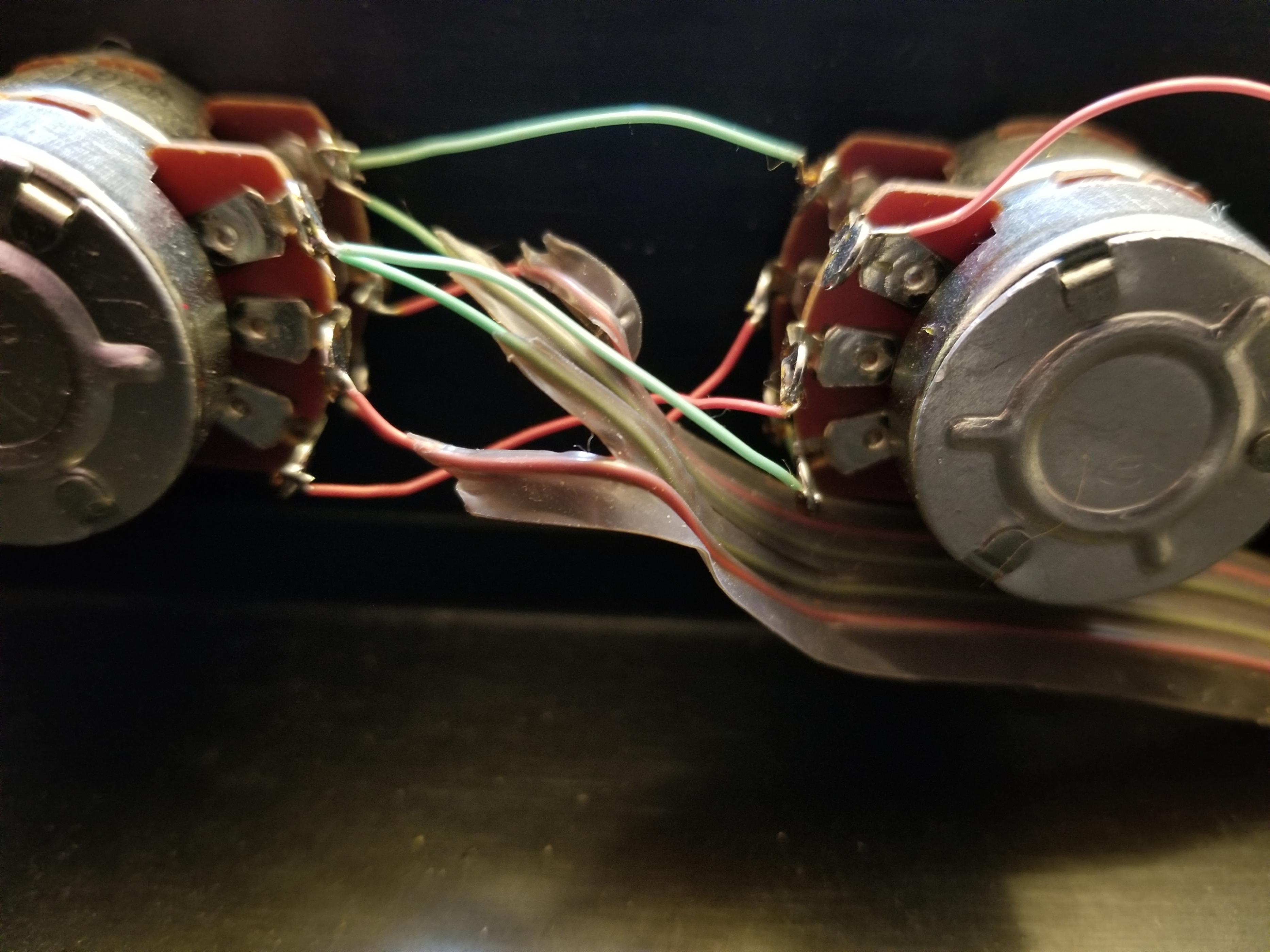

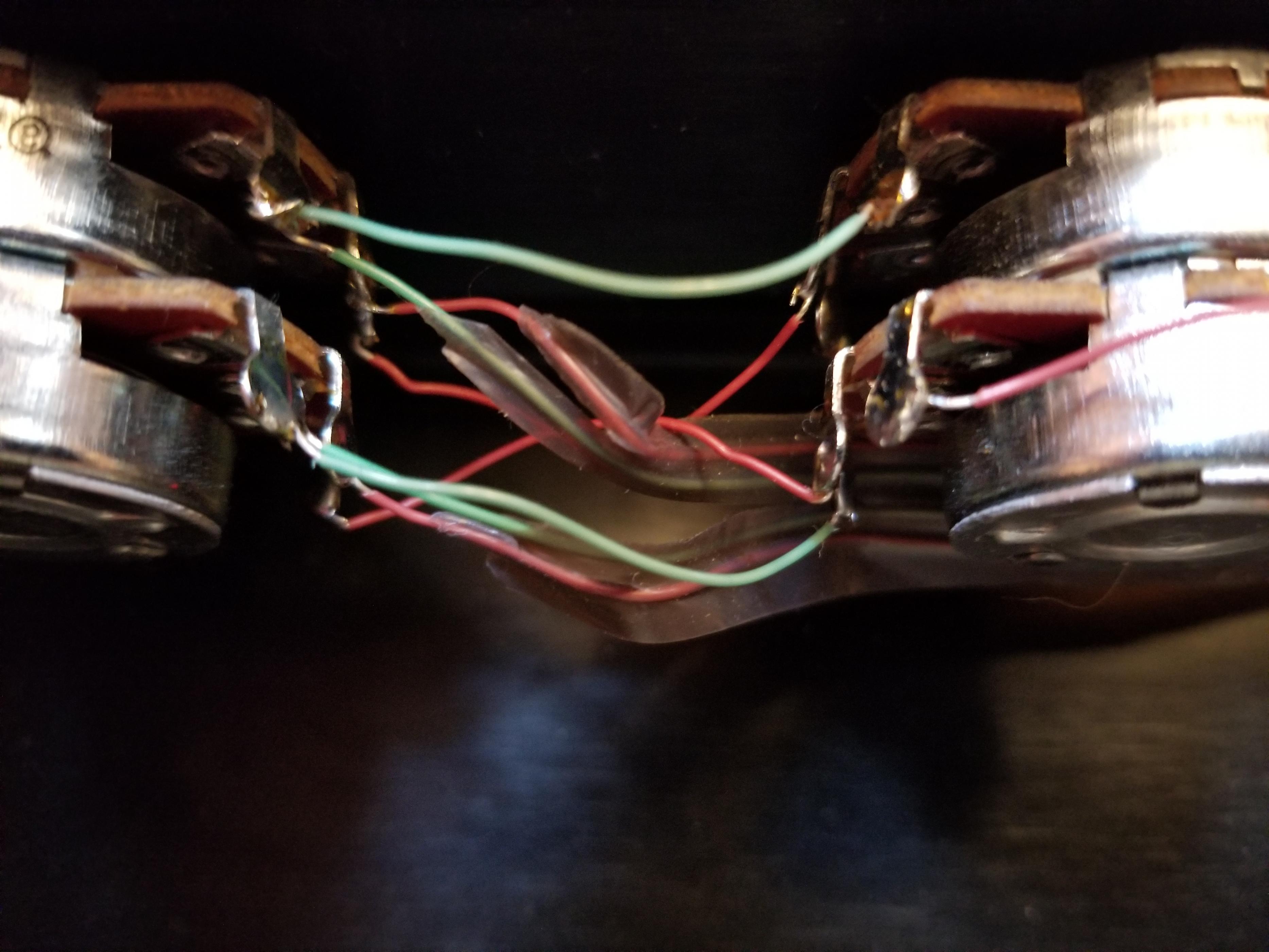

With the stock volume control my volume was set at 9.30 and was very sensitive, hard to set and get the balance right.
I was always fussing with it and I did not like to change the volume for this reason.
Now the volume goes up to 7.00 and I have it set at 2.30. Changing the volume is a snap, just a click up or down balance is perfect.
I first purchased stepped volume controls with blue non dale resistors off eBay, out of china for 25.00 with shipping. The right volume had to steps that were wide open so instead of fighting over 10 bucks I just ordered the dale resistored ones off eBay instead for 25.00 with shipping, I noticed a big difference right away. much better.

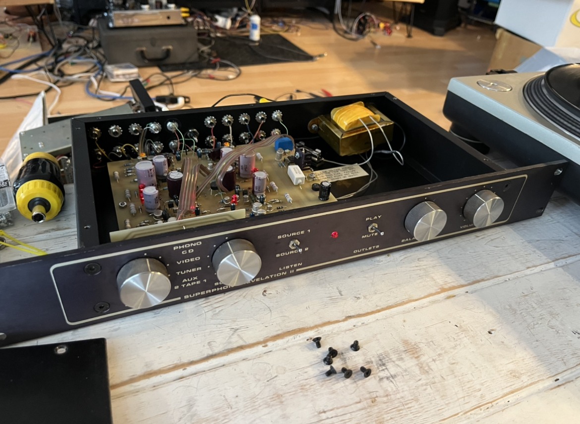

Hi, I just serviced a Revelation II with some new electrolytics for a client and I am shocked at how good it is. I was sad to see it go! I came here looking for some schematics to see if I could make my own but i guess the semiconductors are now hard to come by 🙁
- Superphon Revelation MK II PreAmp
