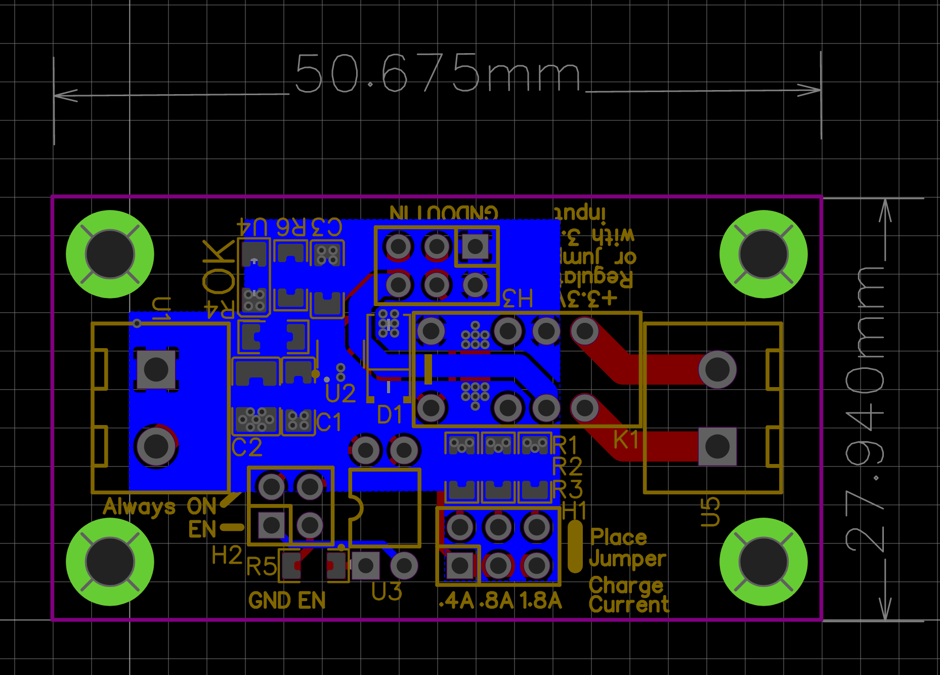

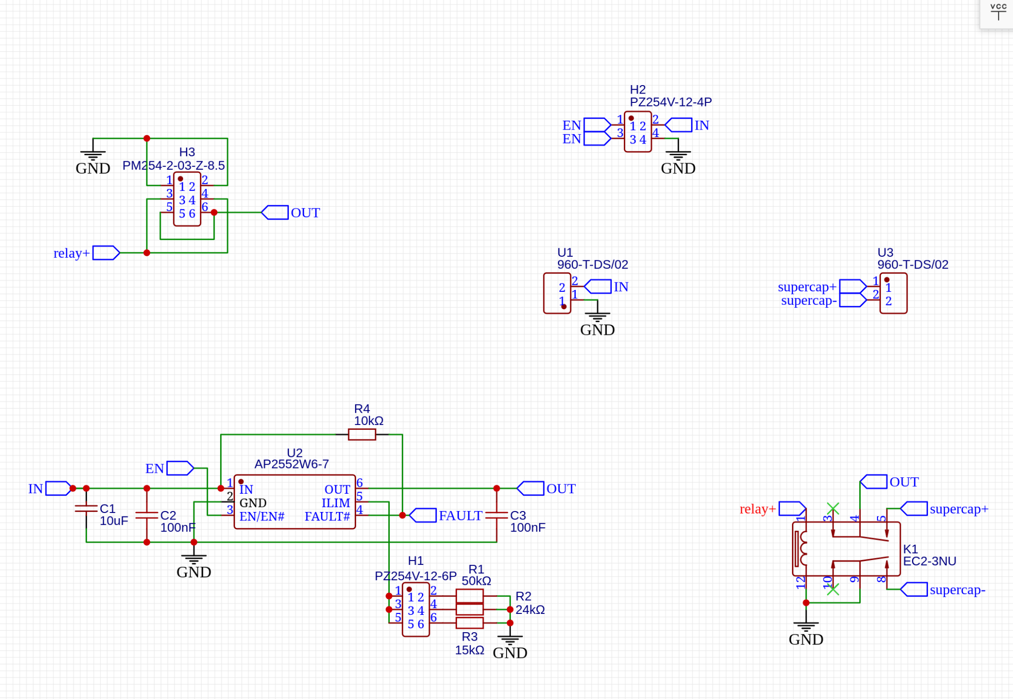

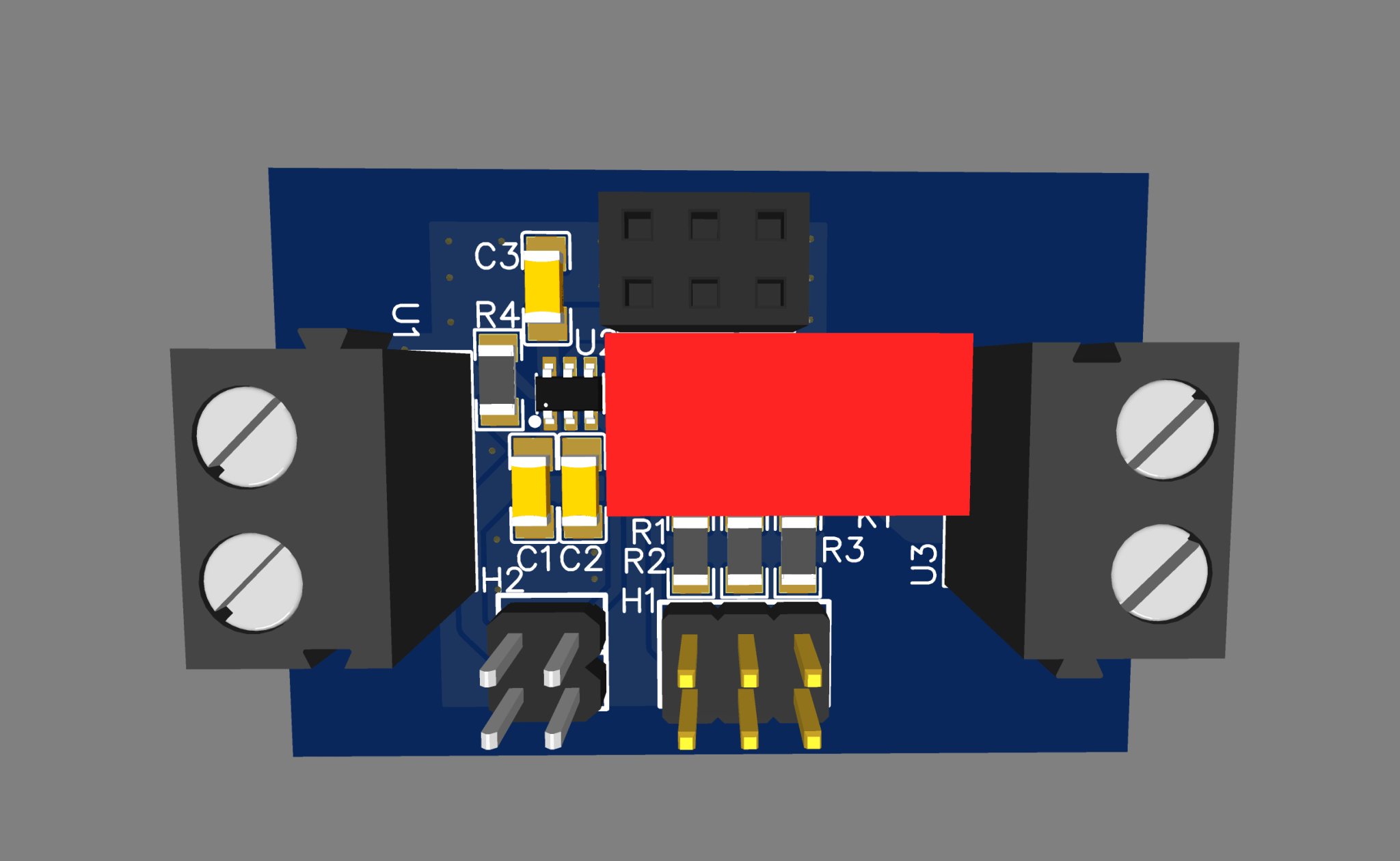

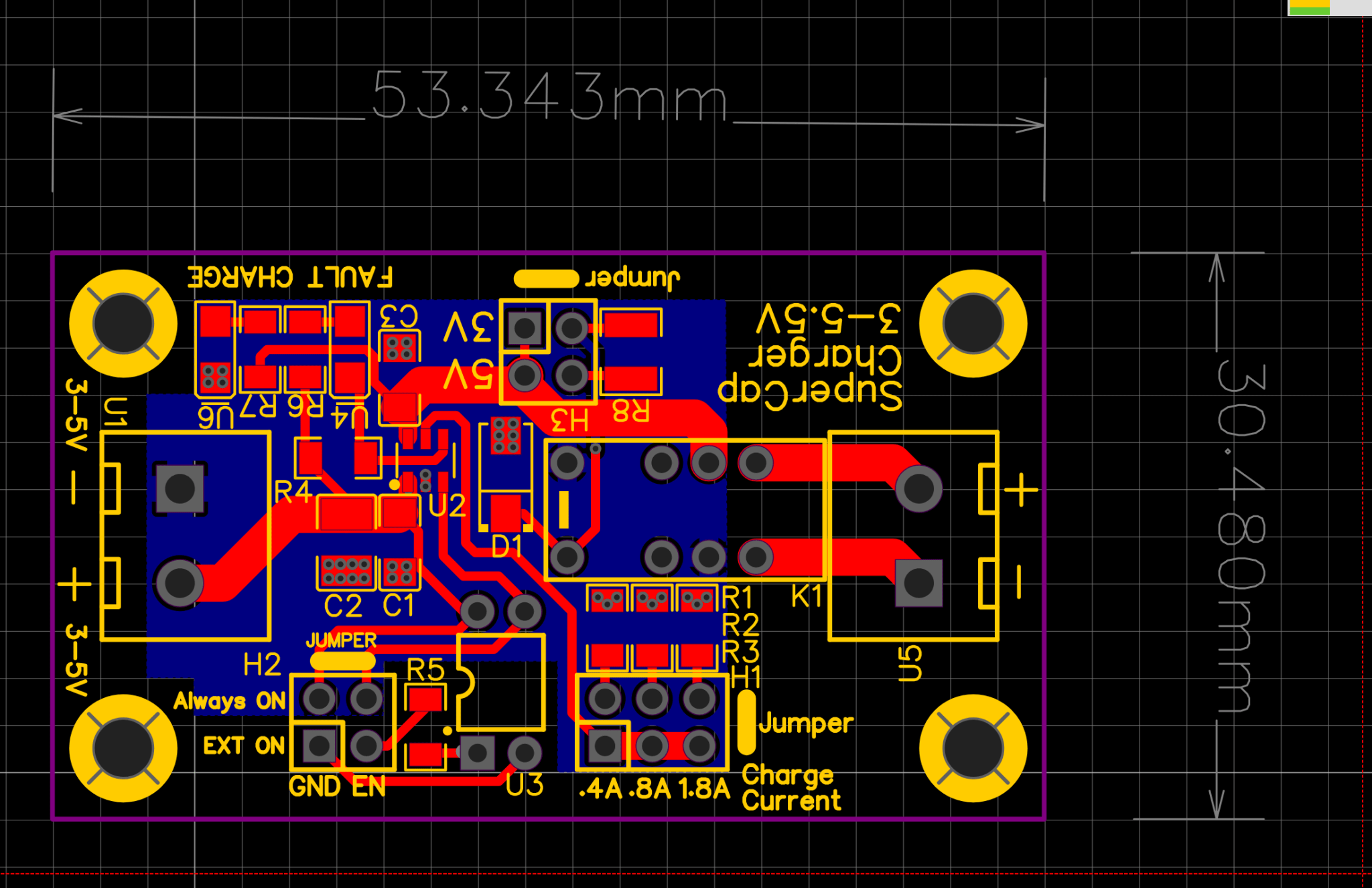

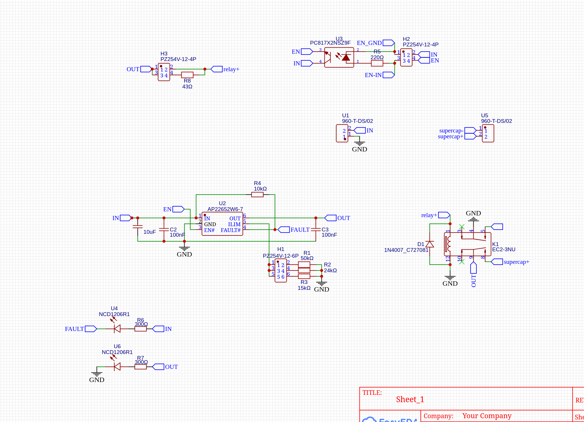

i made a small circuit with a AP2552W6 (which is 3,3V and 5V combatible) and an 3V kemet 2A 230V signal relay (both available at lcsc.com)
its not complete yet, im kinda unsure what todo with the fault pin
there is a socket for my regulators, to regulate the possibly 5V down to 3V for the relays, for 3,3V input there is the possibility to use a jumper inplace of the regulator
also there is another 2x3 pin header for setting the charge current, i used resistors that roughly equal 1,8A, 800mA, 400mA, for 2A,1A or 500mA regulators
then there is a 2x2 pinheader that 1. lets you set a jumper to make the circuit always active, for when you just wanna hook up supercapacitors to a power supply, and 2. the other two pins are EN and GND ... to control this board via a external signal

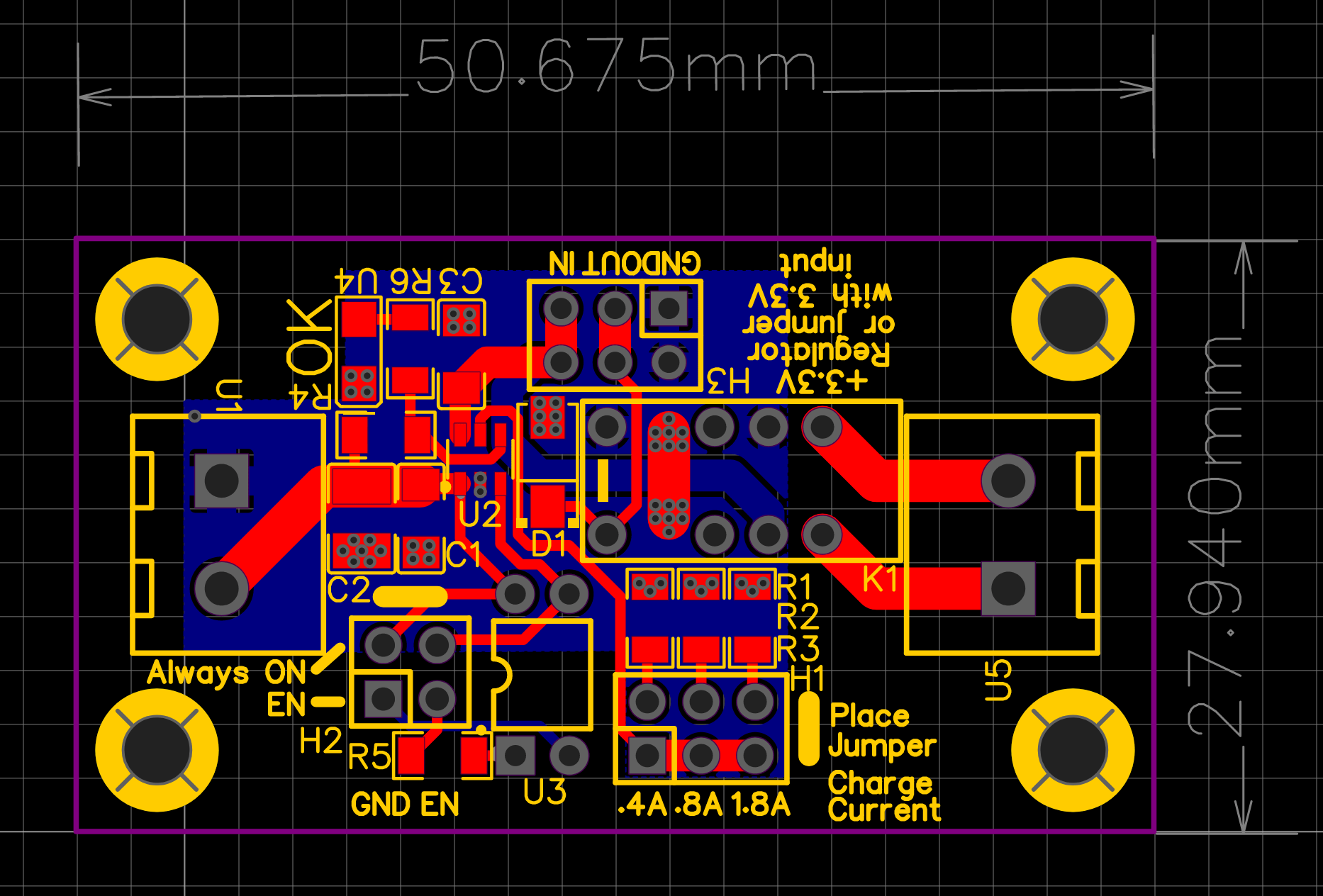

1. i added a 1N4007 flyback diode on the relay coil
2. switched the AP2552 against the AP25562 counterpart, i saw on the mouser datasheet that the AP2552 is not recommended for new design anymore..

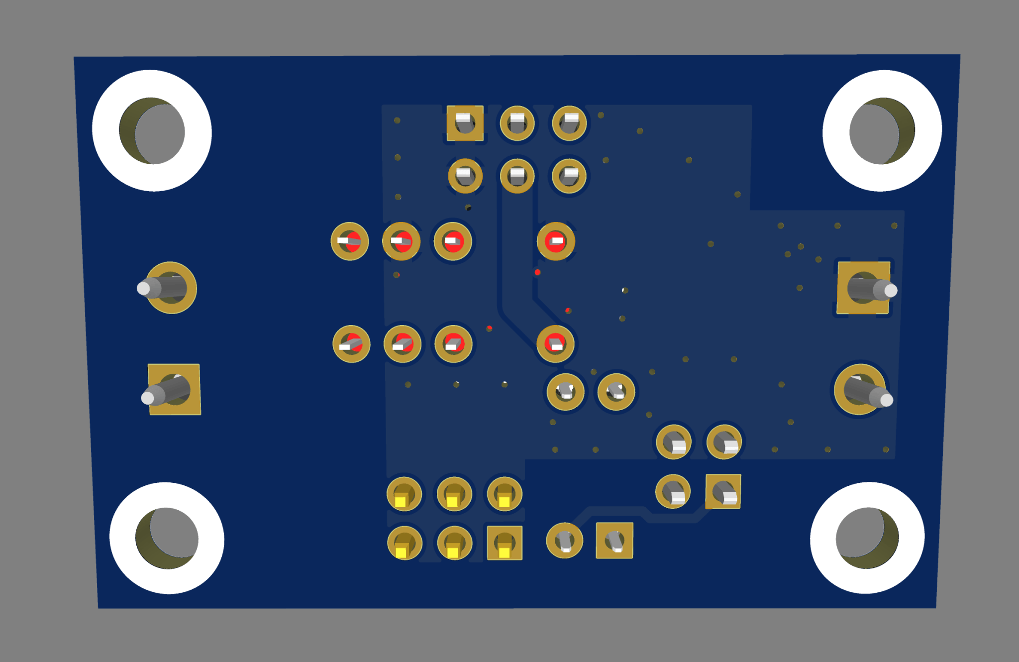

3. changed the ground scheme, unfortunaly because of the one trace still suboptimal but i stitched a bridge over it
could someone say something about my previous ground scheme vs the current one? i feel like the new one is better and less errorprone lets say..

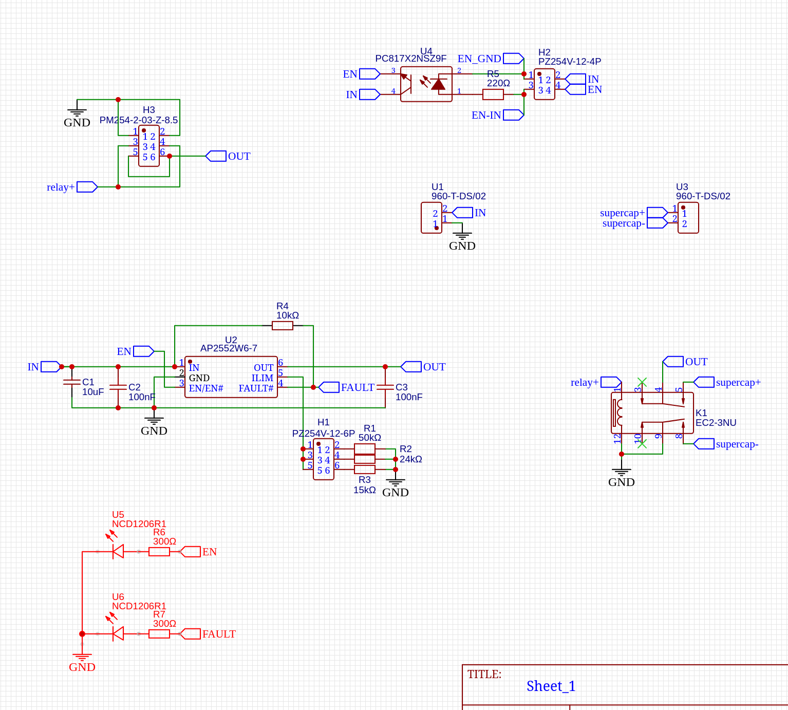

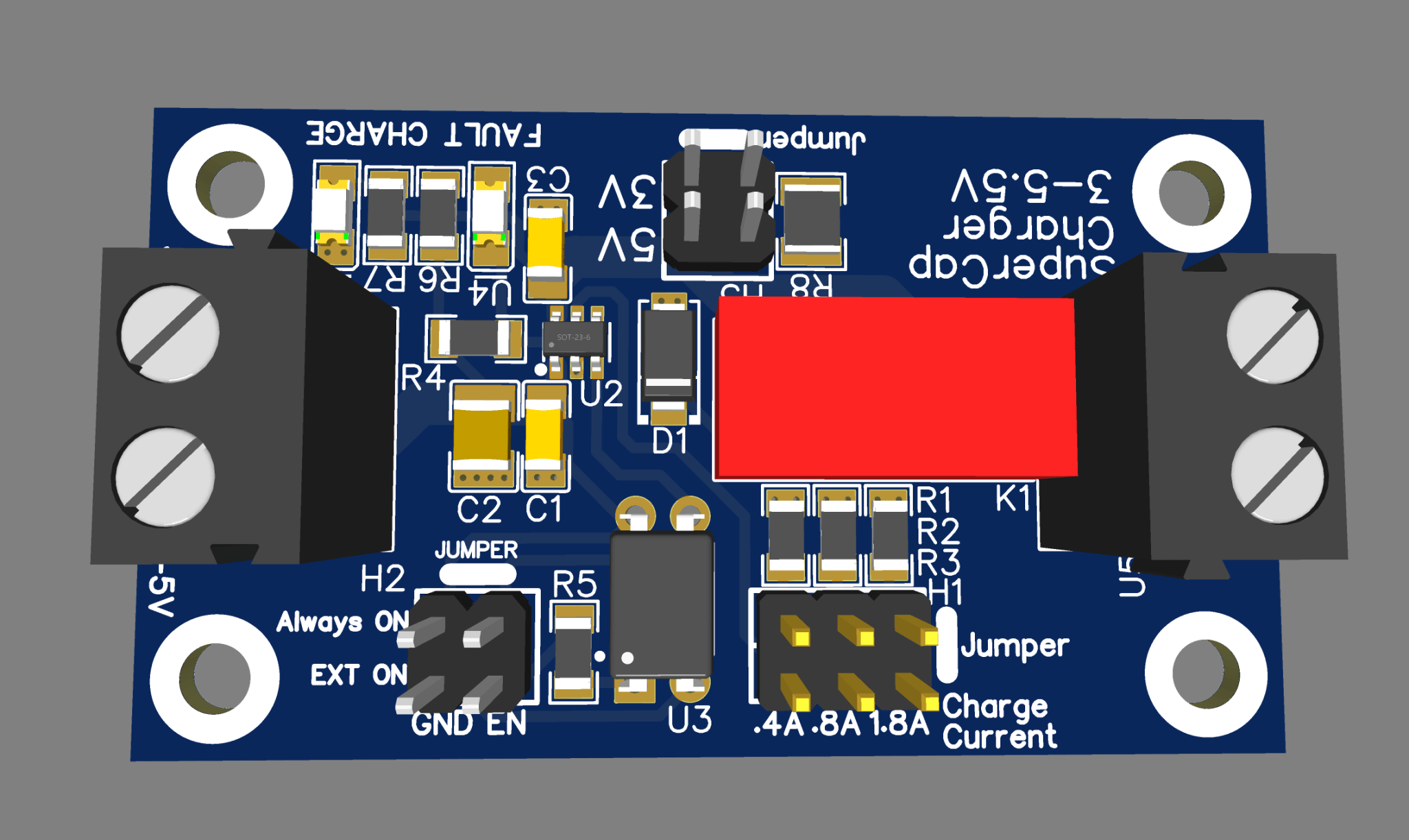

i think i had the led wired wrong before, since its wired now in such way that it only light on fault condition of the power switch IC i added a charge led
and major upgrade i had completely forgotten about... i exchanged the regulator slot for a simple resistor for 5V for the 3V relay
i think its getting close

hmm i just had a thought, while the supercapacitor is charging it will trigger the current limit... does somebody know what happens to the attached load if the supercap essentially trys to charge with 1,8A with a 1,8A current limit? essentially there would be nothing left for the load right?
in theory the power switch could be also switched out by a resistor this would actually also allow for a more effective DC filter ....
it would be probably around 10-20x lower corner frequency, but in the end its 0,0001Hz (6 ohm) vs 0,002Hz (0,2ohm, your usual wire resistance...) with a 500F pack
i kinda like the resistor because we can get rid of the power switch... but it would definitely waste alot of power while charging, tho im also not too concerned about that...
downside is waste of power and the power resistor would need to be adjusted for charge current, voltage etc, but its probably still possible to calculate one resistor for 3,3 and 5V use
