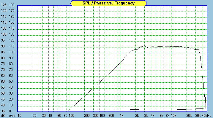

You really need to check out the manufacturer FR plot for the ribbon to see how high a frequency it is capable of as some are no greater frequency extension than some conventional done tweeters or your full range / extended range driver. Also check the impedance for matching your main driver. One good thing regards ribbons is they are generally impedance flat so if they are rated as nominal 8-ohm load you can use a adjustable L-Pad to balance the output of the ribbon and I would recommended this. But this all adds to the cost and complexity.

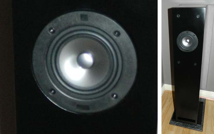

Hi Chris, after finishing the Pencil build I had some free time on my hands so was looking at some reviews on the Townshend Maxim super tweeters plus the Tannoys, Fostex etc. I thought they may work well with my newly built full range drivers but as discussed the burn in process for the full range drivers is still in the early stages so top end improvement will no doubt come into effect. Dave said earlier in this thread there's also a chance super tweets may have a negative effect on stereo imaging which is absolutely what I want to avoid - so alot to think about. Cheers Chris, thanks again for your advice during my Pencil build !! All the best, Steve.

Well, I finally took a closer look at photo posted in Pensil build thread, and I think the size & texture of bezel ring suggest Alpair7.3 - a driver (and enclosure) with which I'm quite familiar.
I'd wager that money would be much better spent on the front end of source / signal processing for any system running these with sub-woofer support than on super tweeters.
I concur with Chris, A7.3 Silver. Attached pic from Steve's post in the Pensil pics thread.
