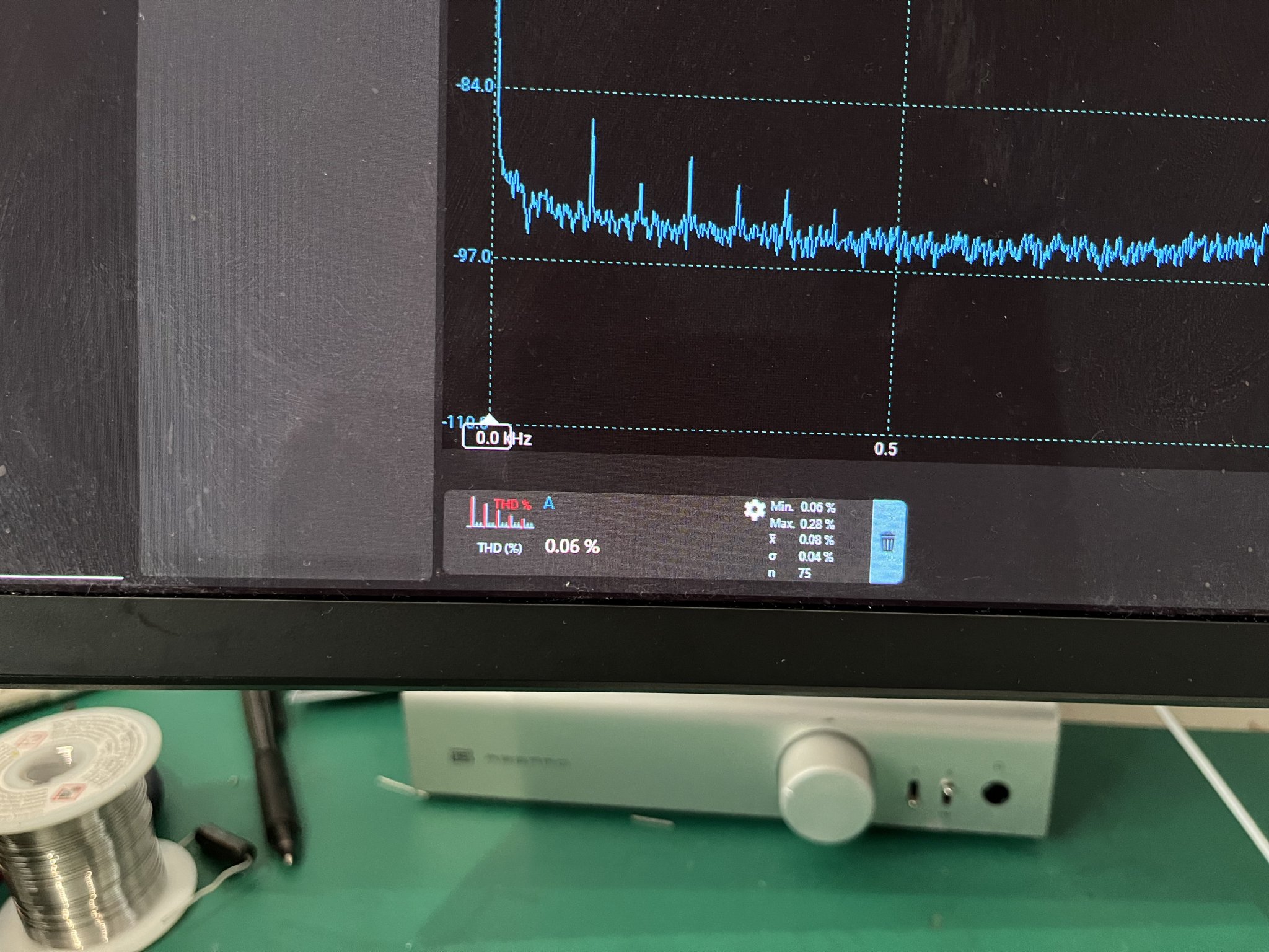

And finished. FFT to follow..

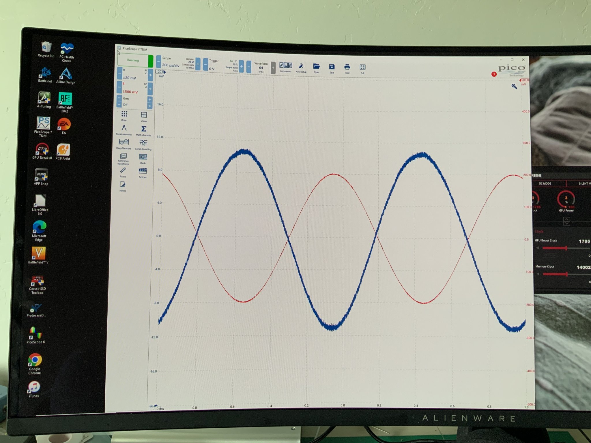

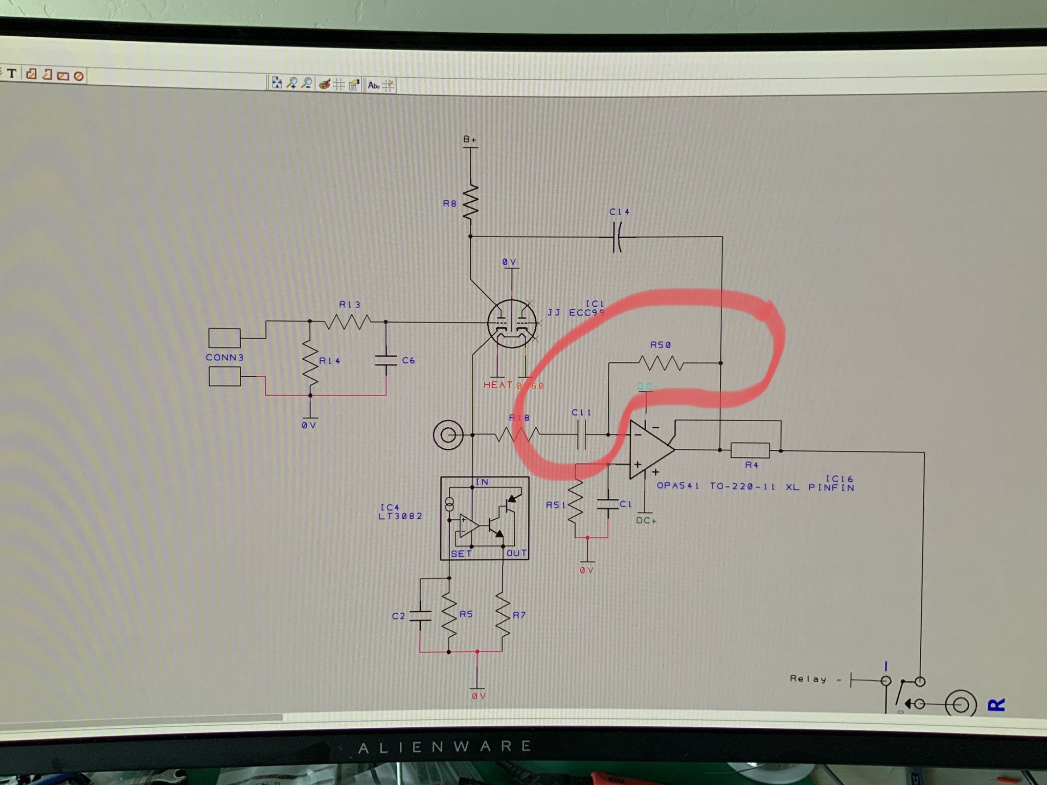

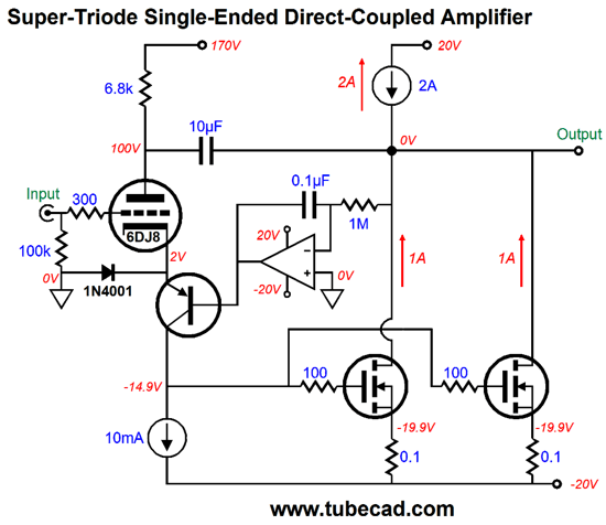

the power is limited by the pin fin heatsinks. 6-8 watts is the upper limit which is enough for me. OPA549 is nice looking but no FET inputs. The DC Servo for the output offset requires a low input bias current otherwise the dc coupling cap would become fairly large.

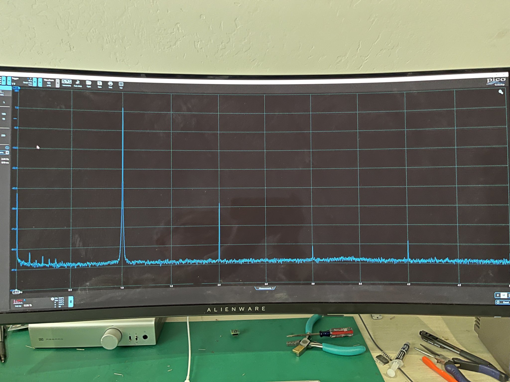

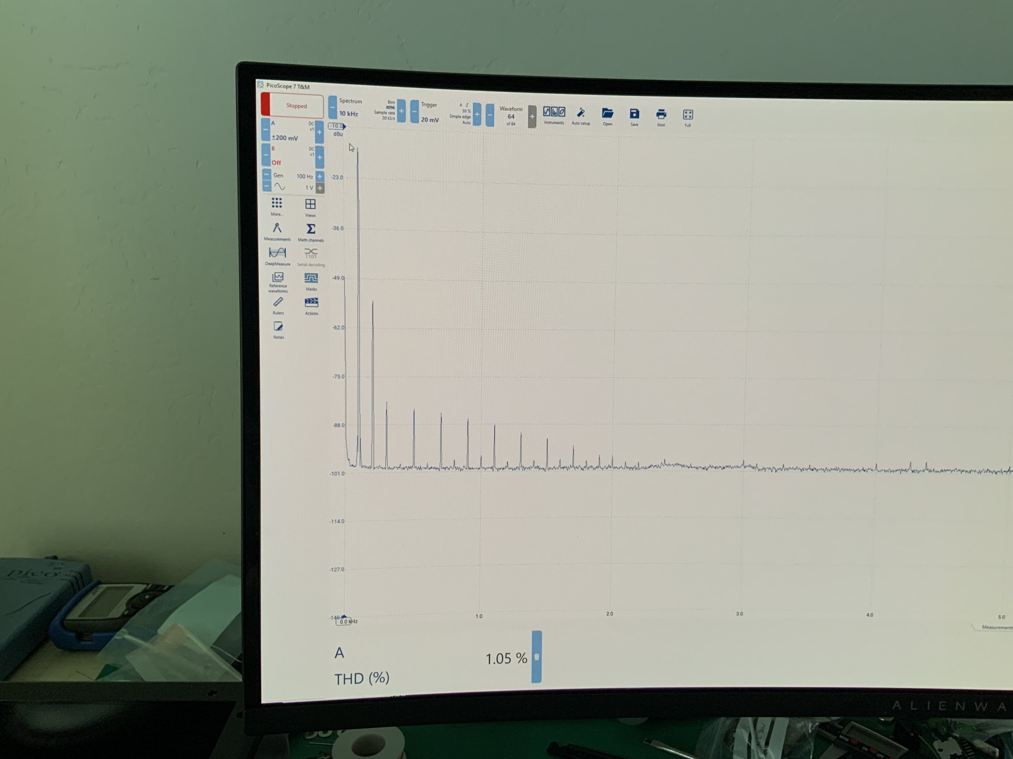

Here is the FFT. 100hz @ 1w @ 7R. A healthy does of 3rd order. Mr tubecad has designed an AC coupled I to V converter. The cathode signal is tiny compared to the plate and the circuits needs serious gain (@ 200) It’s my mistake for not picking the error out. there is no way this circuit will operate as ‘shown‘ in TUBECAD. Gonna change directions again with a dc coupled super triode pcb. It’s a beast.

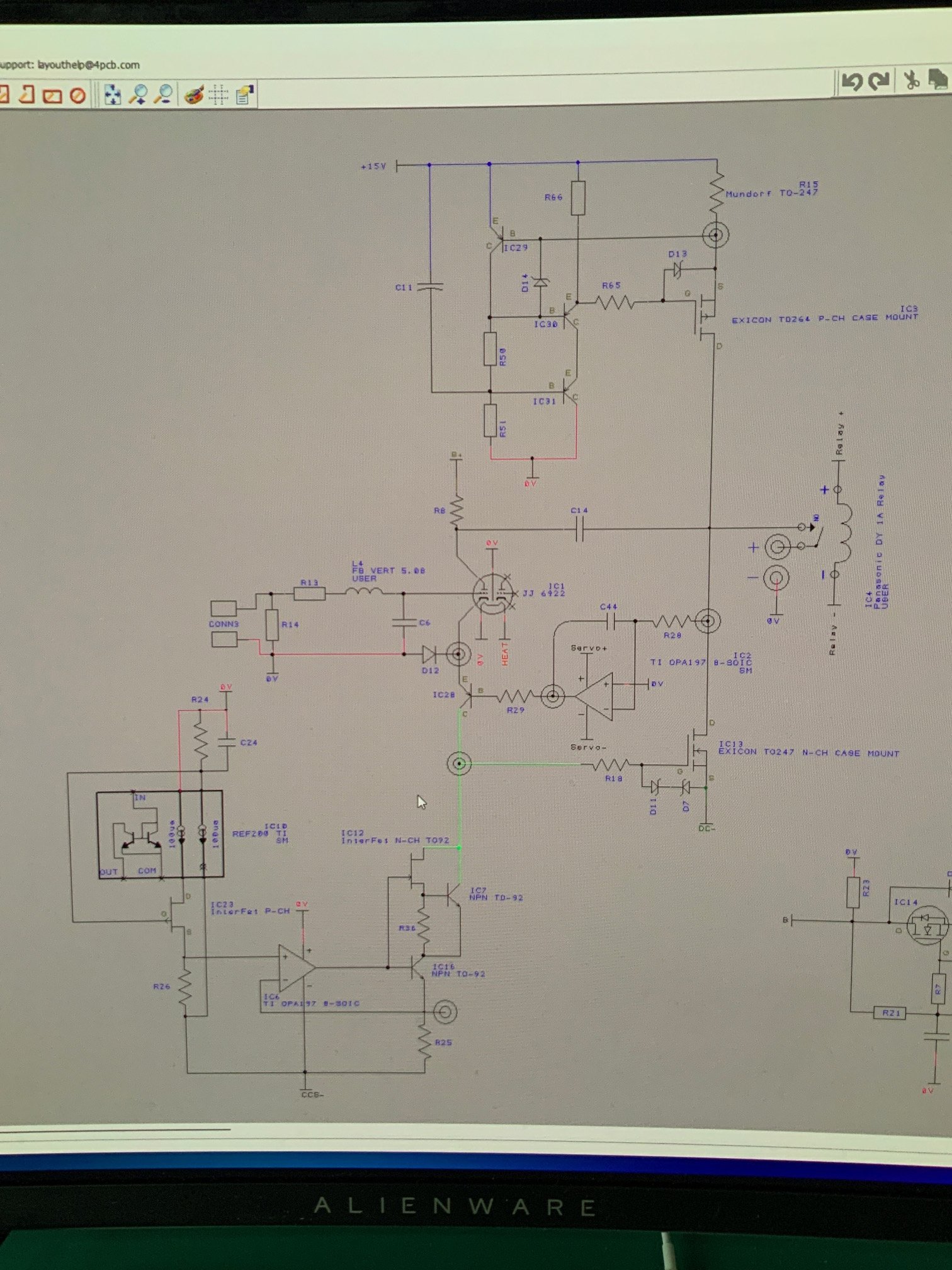

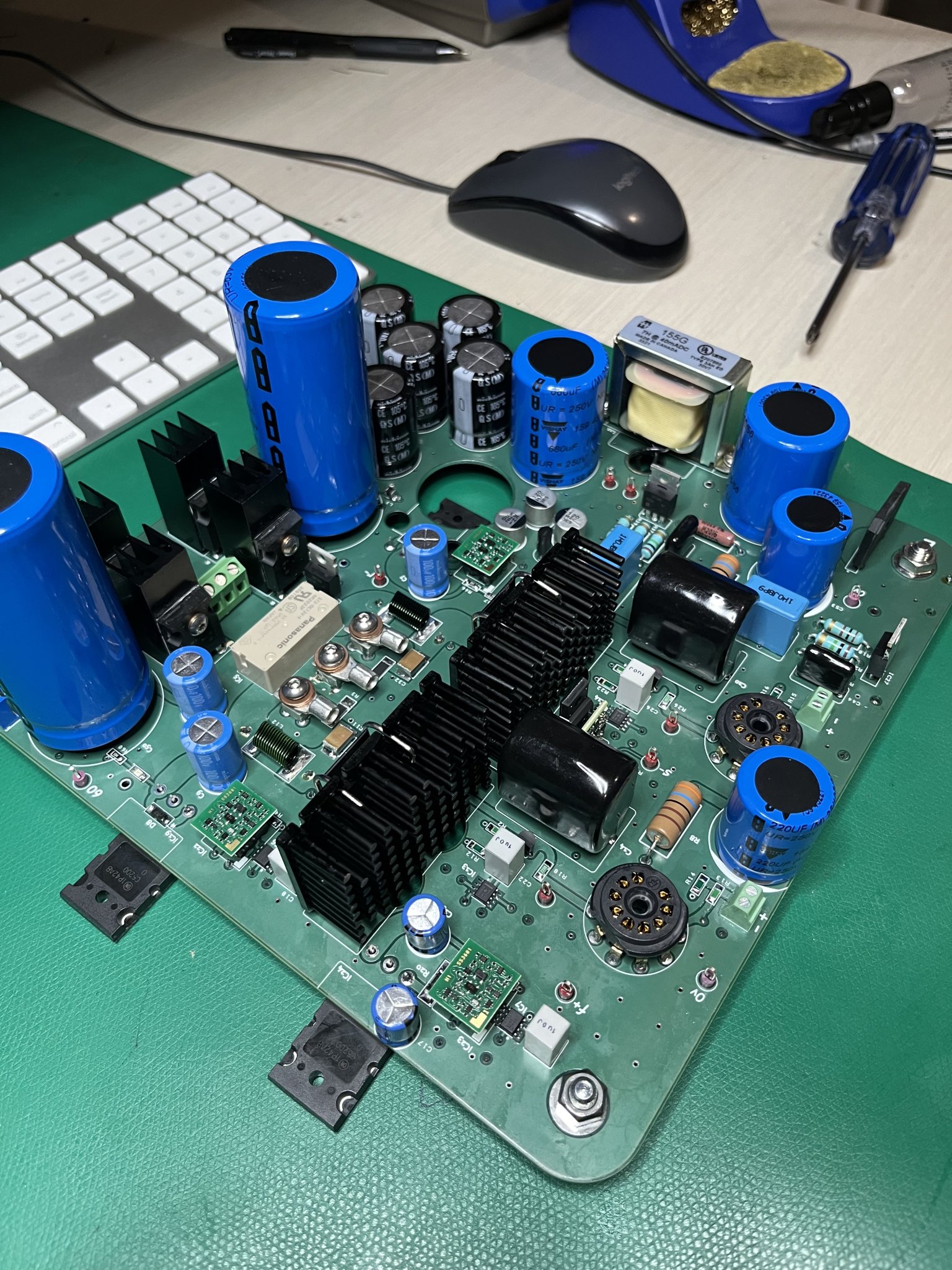

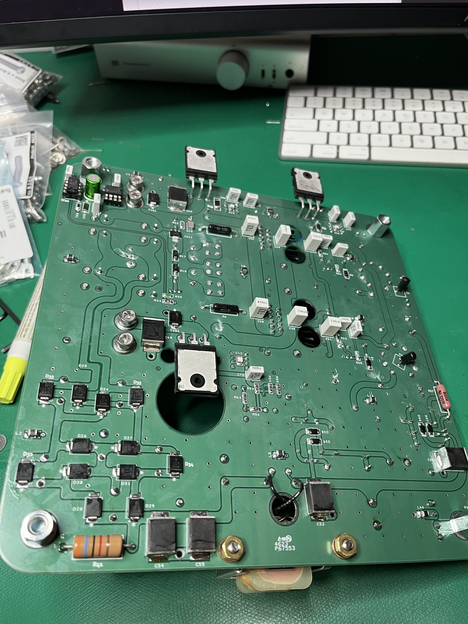

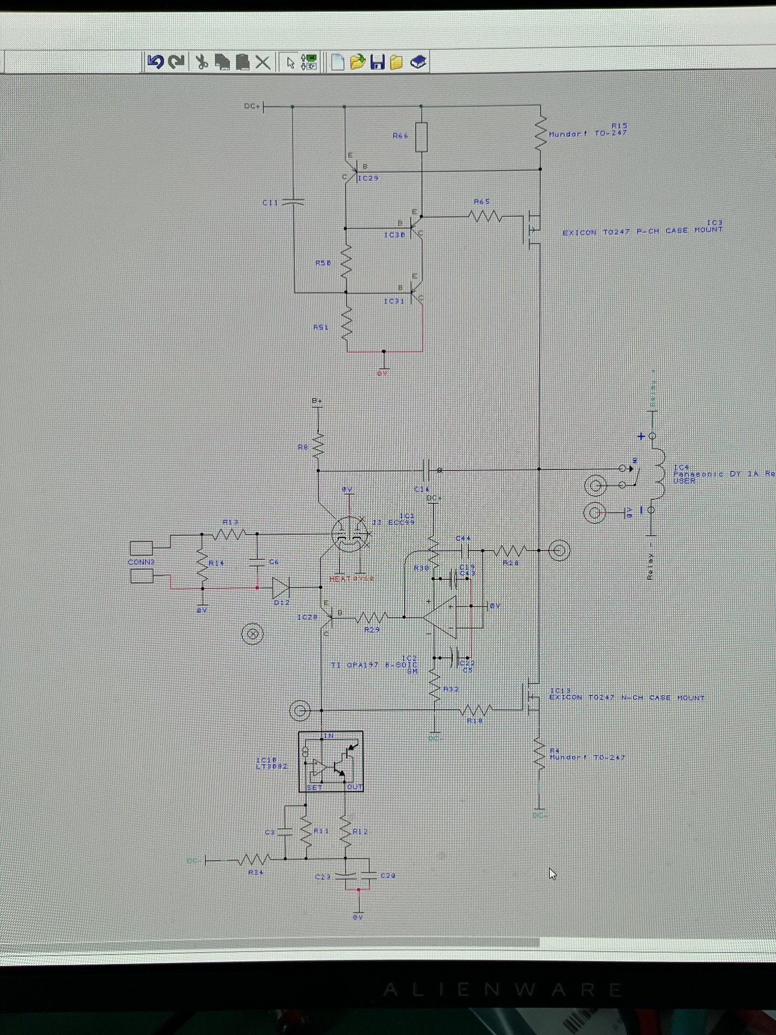

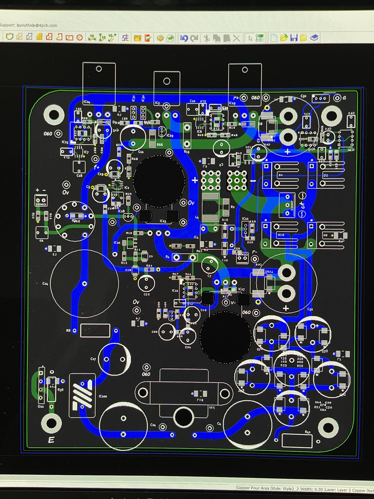

Here is the latest and greatest.. solid state load, bipolar regulated ps, dc servo ( no blocking caps ). based on the 6922 (100v/10ma) tube and a single to-247 exicon (+-18v@2a). Mono block design. I have been delaying this approach due to its complexity. Go big or go home 😉
dwight

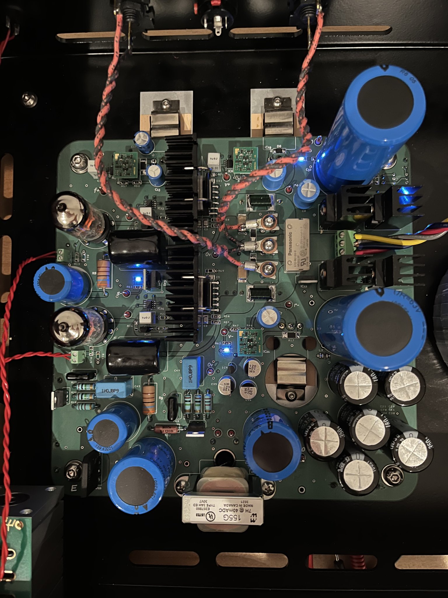

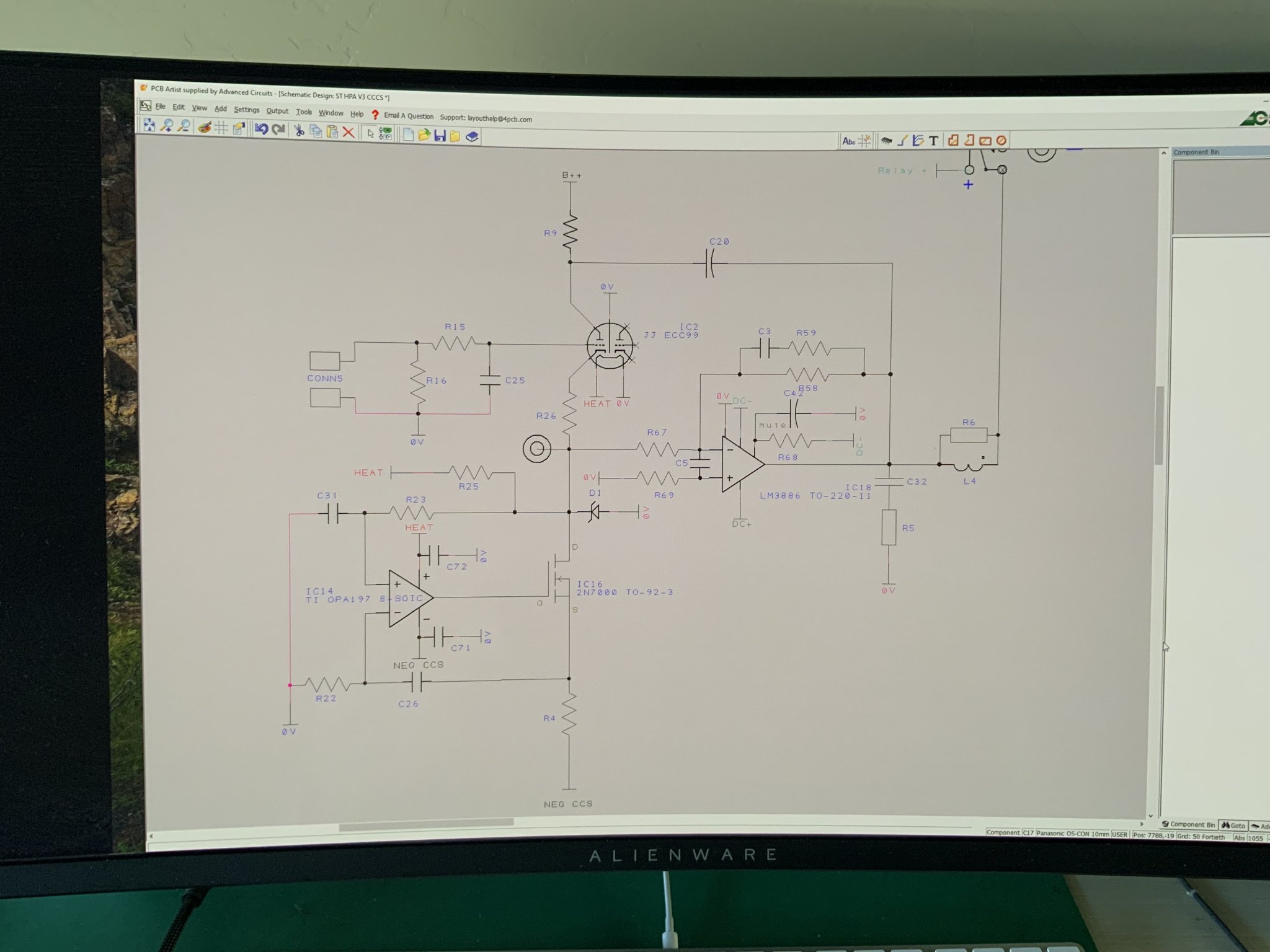

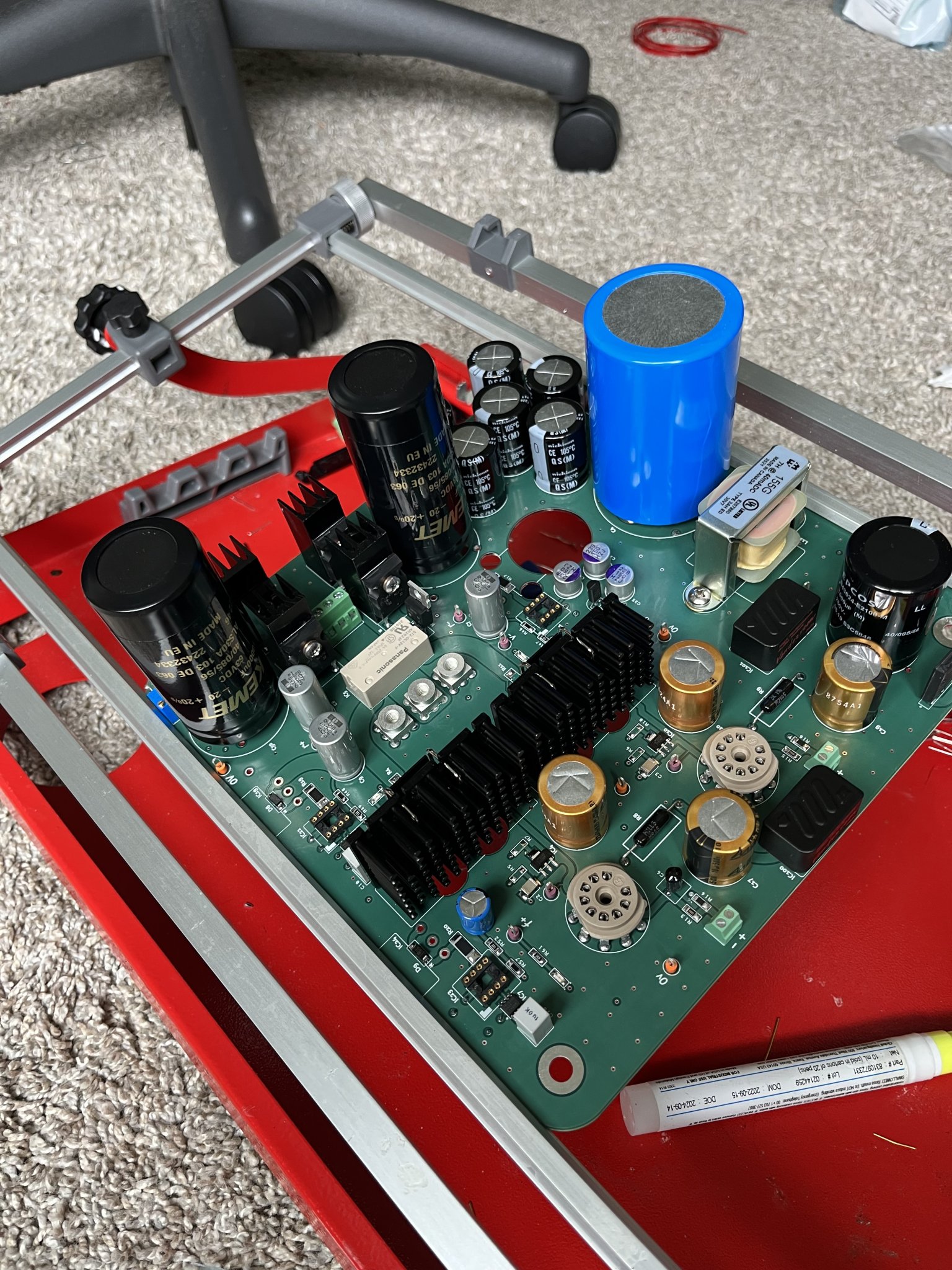

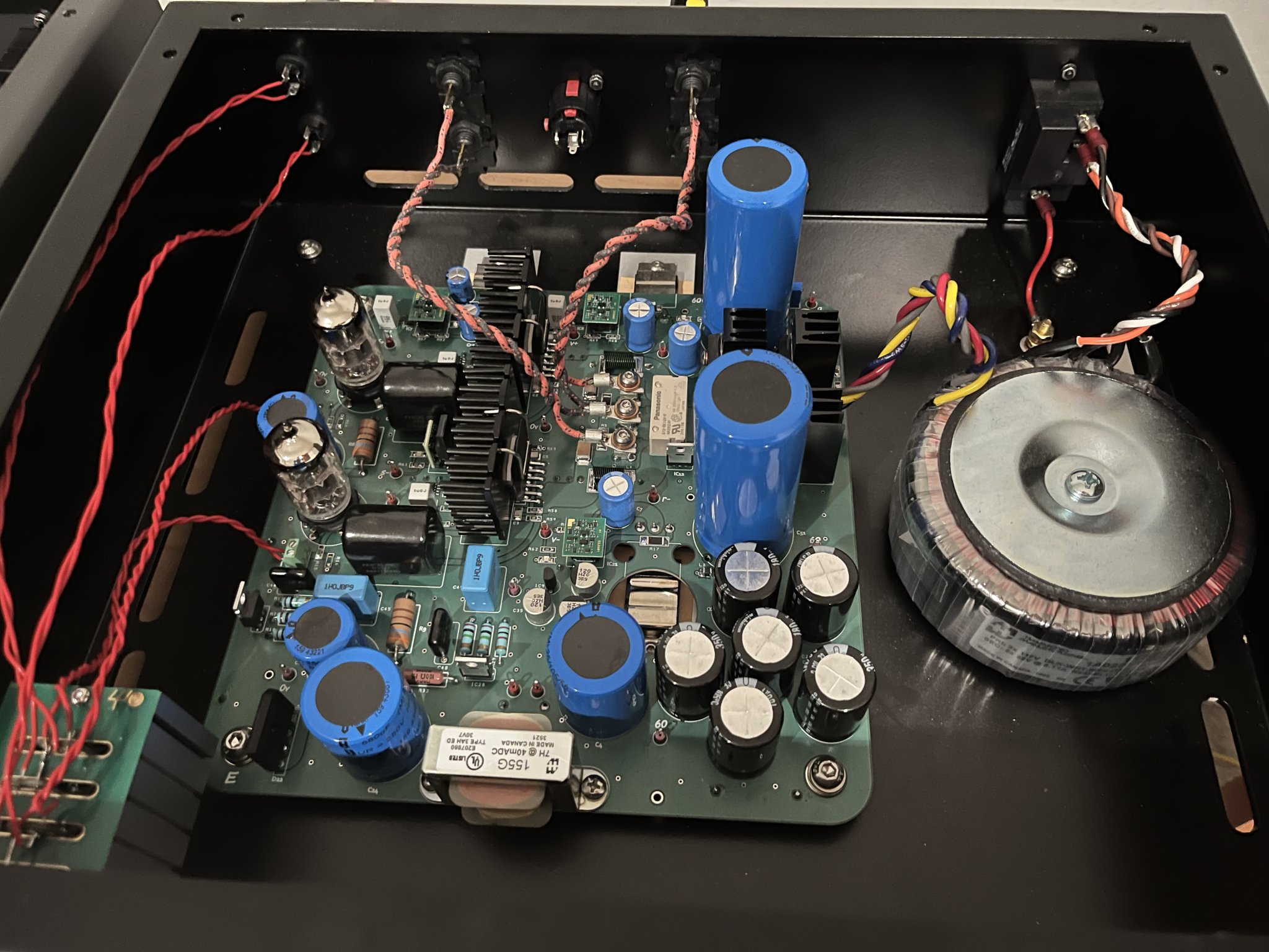

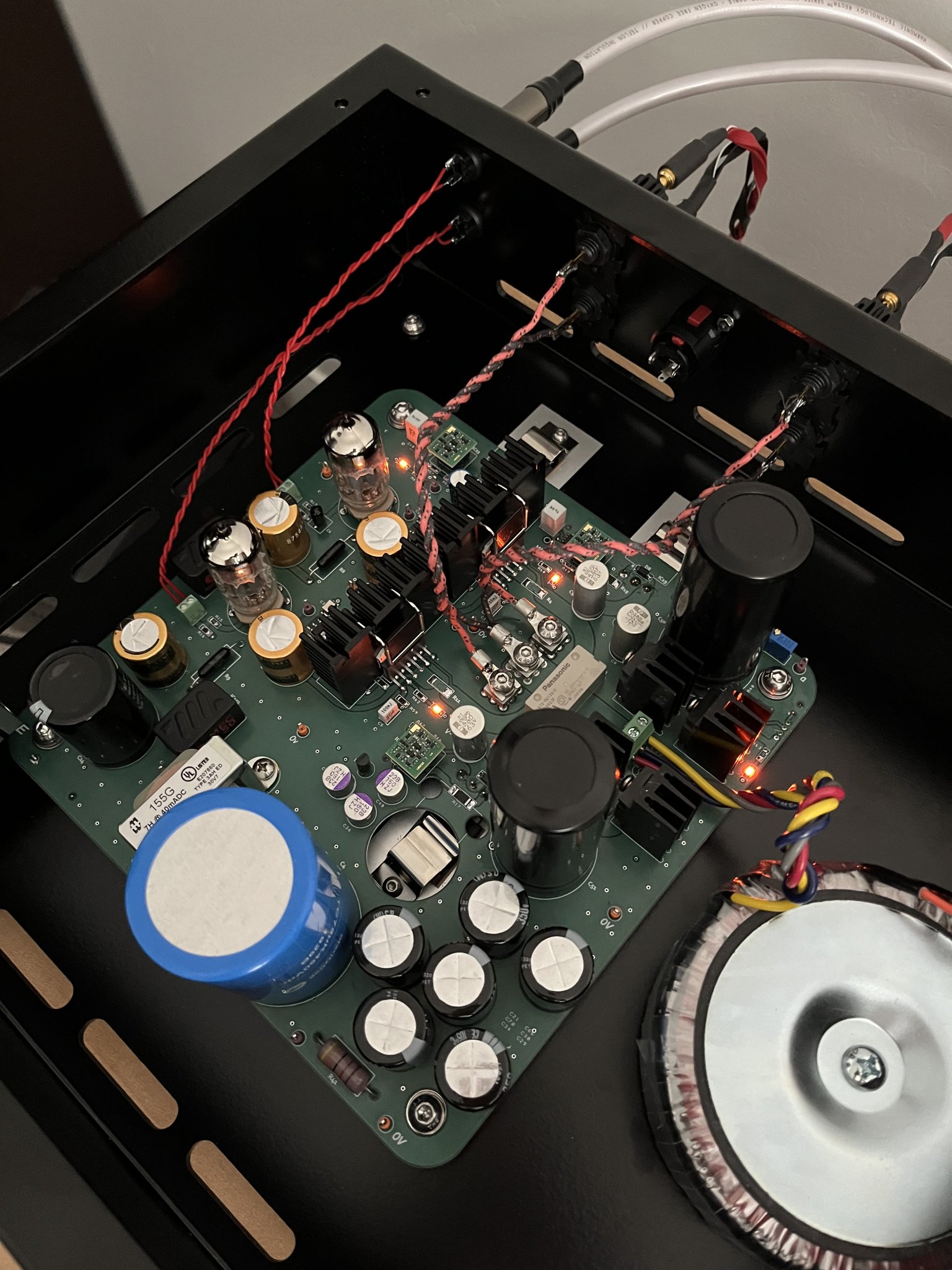

Ok. I ended up switching directions. One more attempt using an 6922 / lm3886 In a super triode configuration. The cathode follower servo circuit is from tubecad. Look up ’no gain, no pain , tubecad’. I have also built a couple preamps on this circuit. See attached. the to-264’s are for the regulated power supplies (+/- 20v & 6.3v). 8w @ 8/4r. This creature is designed to replace 2a3 and 300b tube amps. I luv the EML 2a3 but it is expensive !

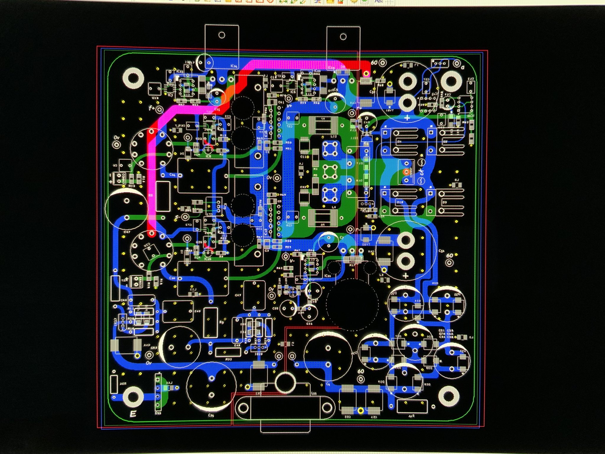

Revisiting da Super Triode Direct Coupled concept -

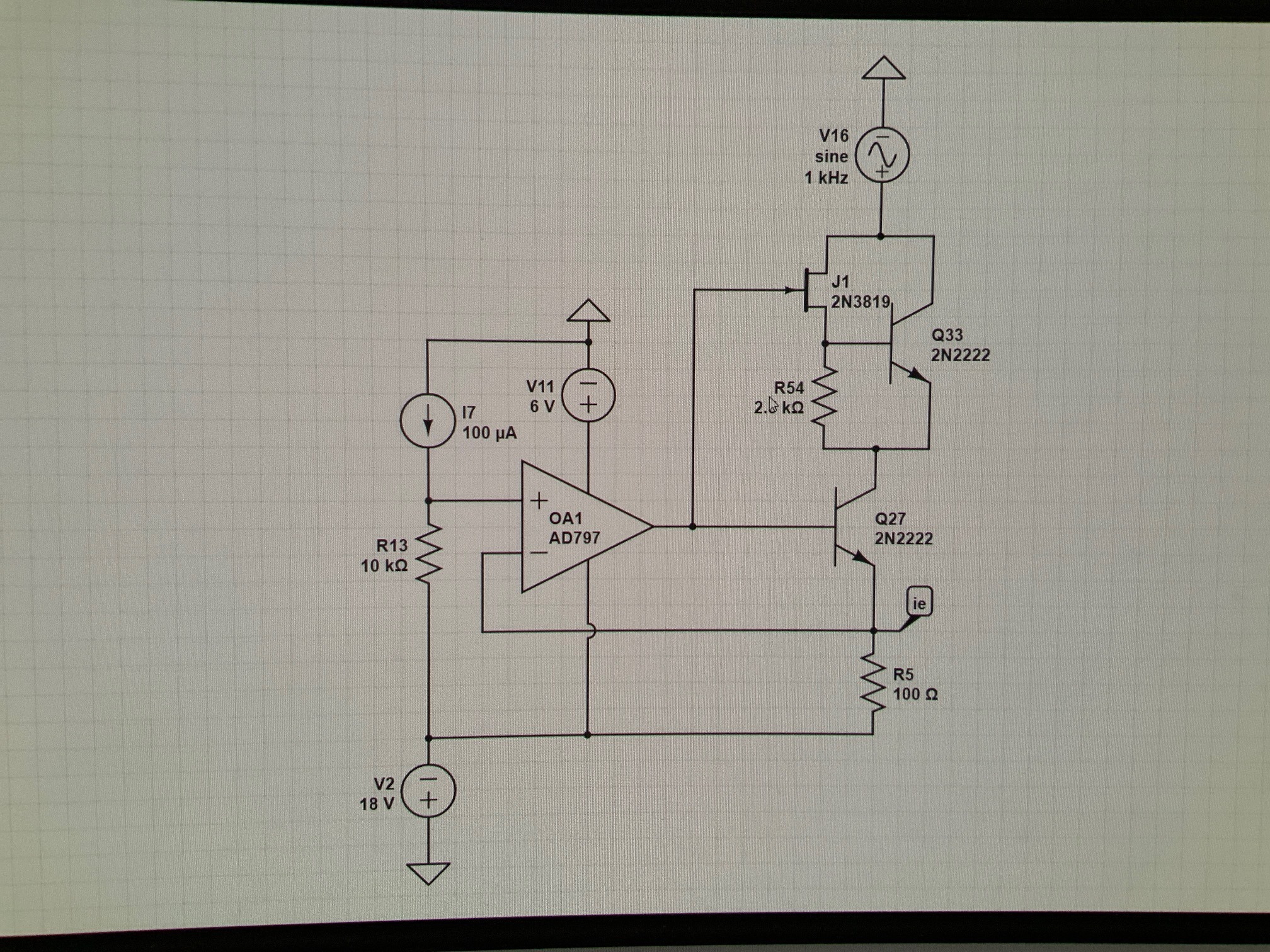

supertriode circuit requires 3 design points (per tubecad) -
the circuit driving the load inverts
the tube does not contribute to the load

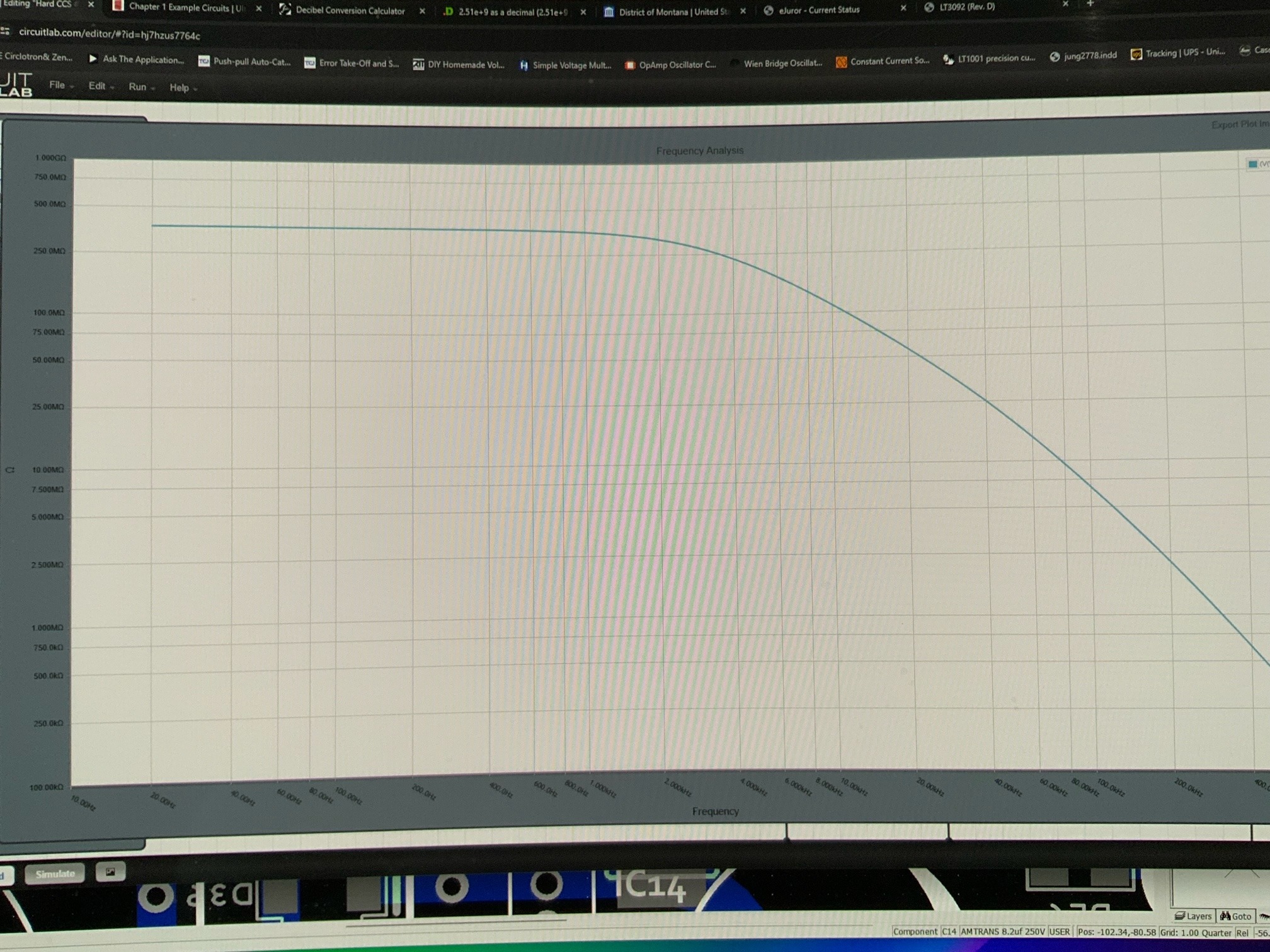

a ‘stiff‘ ccs so the plate resistor can act as the local negative feedback path
my 1st layout was based on the lt3092. 10k @ 10khz leaves to much noise @ the plate.
it was suggested to design a cascode ccs circuit. Found an article from Jung on the subject. See attached
dwight
Reactions: decramer
