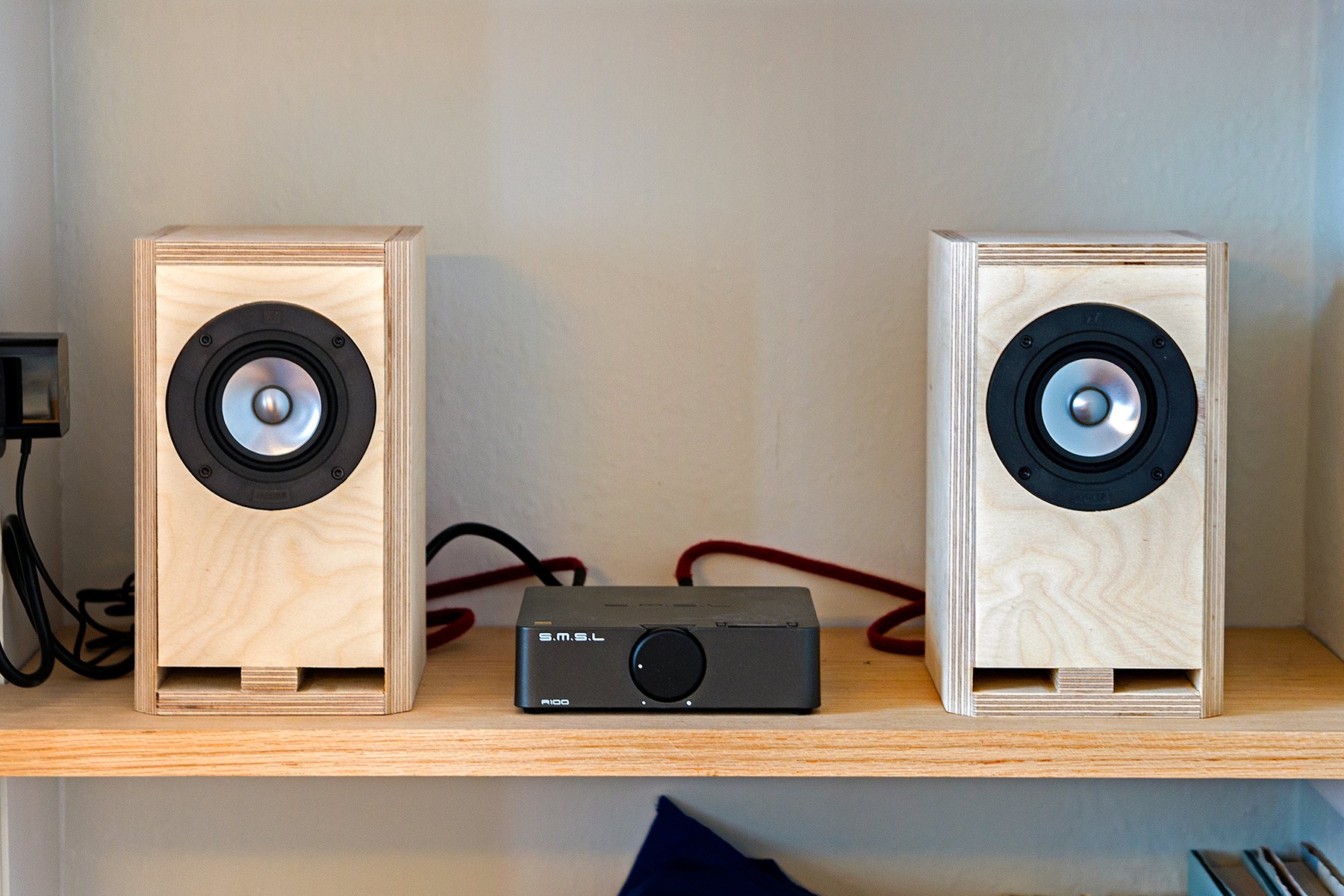

Hello! I'm looking to make some very small, budget speakers as part of a 2.1 system for use with the TV. I'm very limited on space and will likely need to angle the pair and house at least one near a wall due to the TV being in the corner between a window and a fireplace.
Something like the nScan-Ken would be perfect, though it wouldn't necessarily need to be quite that miniature, but the £100 per driver cost puts me off.
I recently (poorly) made a pair of µMar-KenPlus and these are likely a little too big (though objectively small) and normally live in the dining room anyway. Photo is attached, for reference. Previously made a 2-way set using SB drivers based on a Troels design (with adjustments) but they were comparatively enormous.
I've been looking at the CHN-50P as a potential cheap and cheerful driver, but most of the plans I've found are larger than I'd want and I'm not sure if I could just "make them smaller" and lose some bass (as a simplification).
Any sage advice? Am I overthinking this? Maybe underthinking (and not doing any heavy lifting in terms of modelling a cabinet myself)?

How limited the space is? If you go very small, cheap and simple - TV speakers will be much much better in pretty much everything: bass, power, dynamics, quality etc.
You have to decide either go for very very cheap fullrange option or go 2-way. For second option go for cheap and tested drivers, like SBA PFC series as woofers: https://sbacoustics.com/product-category/drivers/midwoofers/pfc-midwoofers/ or Dayton RS125P-180P, depending which one you can source sheaper, and some cheap but still good tweeter. Search for final project or design your own one. Smth like Mechano23 with cheaper tweeter.
Forget PS95... they are VERY good, pleasant to listen, but not adequate improvement over TV speakers. They are for tabletop speakers. Closer to 2,5 inch.

Can compare them to many 3 inch speakers, and they are more or less on the better side of bang-for-buck. If comparing to PS95 - more bass, more everything, they are just bigger more powerful and are of another size level, but are inferior with timbre, smoothness and overall not as pleasant to listen. YMMV as this is subjective. I will go for PS95 on tabletop speakers, BR of ~80Hz tuning or closed boxes with subwoofers somewhere under table, but not for speakers dedicated to whole room. 3fe25 are just more powerfull.

Very few 3 drivers that fit a smaller box than the
µMar-Ken, it can be squeezed a bit smaller. Sealed won’t go as low but could be smaller.
With a small speaker these small, materil thickness is a significant contributor to gross volume. Using 3mm Al or similar is worth considering.
CHR-/CHP-50 are fantastic bargins, I’d choose them over the Scan any day
The Faital Pro can be sqeezed into a µMar-KenPlus size box but would prefer a larger box

Very few 3 drivers that fit a smaller box than the µMar-Ken, it can be squeezed a bit smaller. Sealed won’t go as low but could be smaller.
How small are we talking? Sacrificing a little bass wouldn't be the worst thing if adding a sub of some kind.
Also, is there a reason you seem to avoid the CHN-50 in your plan sets? Or do they swap in/out in place of other units?
Also also, if the µMar-Ken are supposed to be paid plans and I've found them on the internet somehow let me know and I can buy them retrospectively.
