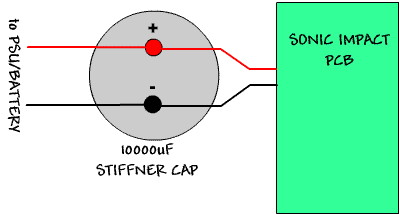

I ordered the Super T-amp, some Jantzen input caps, a 10,000uf stiffener cap, and a 100uf NP electrolytic cap to put across the power supply.
When you mentioned putting a 100uf cap across the power supply, were you thinking an electrolytic or something nicer like the Jantzen? I didn't get the Jantzen just because it was over $20, and so I figured it wasn't what you intended for your 'under $25' mods. Maybe if PartsExpress carried Panasonic caps I could have found something more appropriate.
Can you give me a pointer as to where the stiffener should be connected?
Thanks for your help, Ian

swett said:When you mentioned putting a 100uf cap across the power supply, were you thinking an electrolytic or something nicer like the Jantzen?
The 100uF across the power supply was an electrolytic placed right on the power chassis connector where the DC comes in from outside. Sort of a "Head 'em off at the pass" strategy. I used a Panasonic FM, but I think any good electrolytic would work just fine. You might even double it up with a small value film cap.
See the image below for an idea of how to connect the stiffener cap. Try to get it close to the amp board. The 100uF cap would be upstream of this.
Best of luck! Let is know how it goes.
