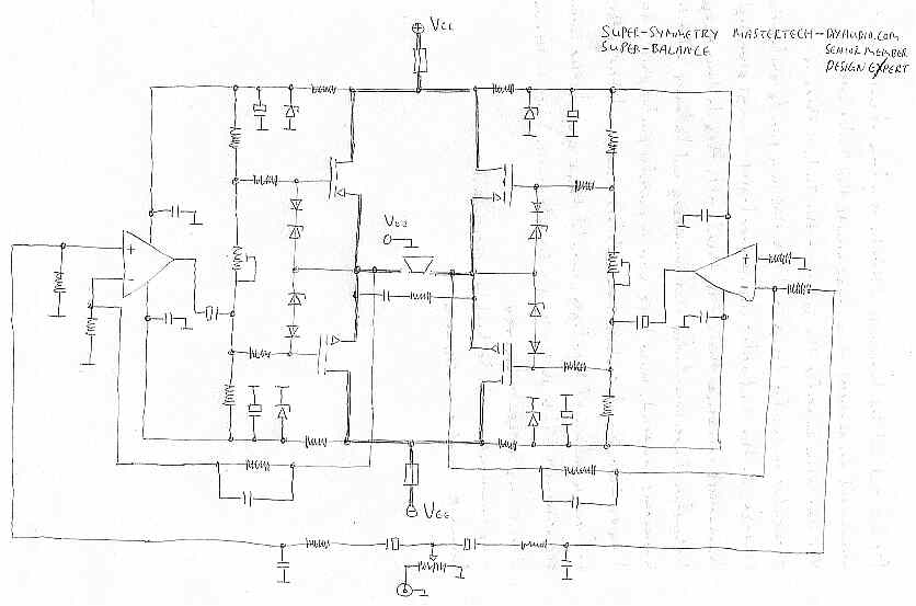

Mr Pass 2nd and 3rd harmonic distortion is a form of noise,unwanted frequencies that contaminate the audio spectrum ,yet you seem to prefer the 3rd over the 2nd, is there a particular reason for doing so, i ask this ina purely philotechnical context, do the 2nd harmonic circuit topologies always give higher harmonic content than the 3rd ones, they do dont they, i therefore have concluded relatively that symmetry and balance offer less harmonic content, now i ask you a purely philosophical question, i take two similar class-b monoblock amps and bridge them to form a balanced topology, would that give better harmonic performance than just using a single monoblock on its own
here is my super-symmetry and balance
any comments would be highly appreciated

Assuming that by 'higher harmonic content' you mean higher distortion, the answer is maybe. It depends on the rest of the circuit. You cannot blindly assume that a circuit exhibiting primarily second harmonic distortion will have higher overall distortion than a circuit that has mostly third. Or vice versa.
As to whether second or third harmonic is preferable, the answer is again maybe. You seem to be seeking an absolute answer to a relative question. That's a recipe for angst and frustration.
If you're going to try to "X" an opamp circuit, you might do well to check Nelson's threads on X chip circuits. There are several of them.
Can you improve two class-B amps by creating a bridged circuit? Maybe. It depends on your criteria. Be sure that you have sufficient bias to power the load, though.

If you bridge amplifiers or operate two output stages as a
single balanced one, you tend to get cancellation of 2nd harmonic
and addition of 3rd. At higher harmonics, it quickly becomes
unpredictable.
If you bridge two output stages with 3rd harmonic character
(standard push-pull, for example) the bridging usually reinforces
the 3rd harmonic. If you operate two single ended stages
balanced, you can get a lot of cancellation of their 2nd harmonic,
and the result is generally 3rd harmonic.
So, if I am planning on hearing 3rd harmonic, my favorite method
is to balance two single-ended Class A stages.
2nd Harmonic or 3rd - they are different, but I have no problem
with either.

To the extent implied by the trademark "SuperSymmetric",
your circuit does not fit that description as it does not have
a cross-conducted error cancellling mechanism. That's not to
say it wouldn't sound good - that would be in the details...
