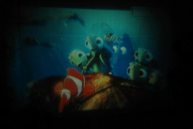

How large is that screen? Its kinda hard to tell from the pic, but the quality looks pretty good; especially for a 5" lcd.
Nice project. Could you post some pics of the rest of the setup?

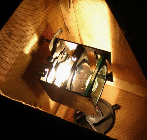

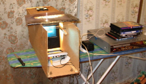

My setup
I didnt start yet
I am engaging to collect and I already havy
1>Lilliput 318gl 70tv/monitor
2>Philips focusline projection lamp 24v 250w
You can watch it in the thread called bulb information
3>3M OHP Lense 70mm FL 9.5"
4>OHP Fraslense
Still not get condensor I will search it in the photographic shop may be they used to sell it for Photo enlarger machine.
This bulb is only for test purpose after that i will go to MH
cause this bulb is very limited life time 50hrs
One of the major problem is for my monitor because it has short ribbon cable and for tv tuner it is slitely more complicated.

hi, here are my results, screen is 6ft wide
