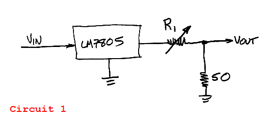

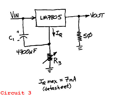

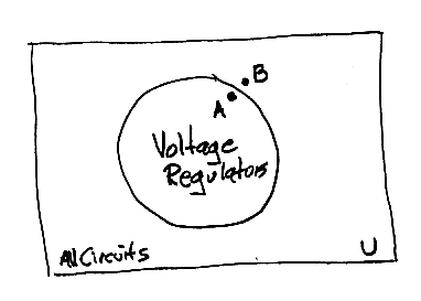

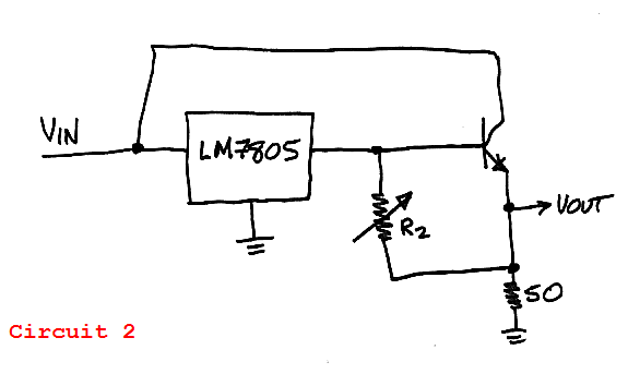

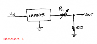

Jan, I think that's quite an interesting topic! If we divide the universe U of all possible circuits, into two sets: (i) the set of all Voltage Regulator circuits; and (ii) the set of all circuits which are NOT Voltage Regulators, we get the attached Venn Diagram.
And this suggests a fascinating question: Of all Voltage Regulator circuits, which one is closest to the borderline? Which Voltage Regulator circuit meets the membership requirements with the least excess? Suppose that is circuit "A" on the Venn Diagram. It is the worst possible Voltage Regulator that is still a voltage regulator.
The converse question is fascinating too: of all NOT Voltage Regulator circuits, which one is closest to the borderline? Which NOT Voltage Regulator circuit just barely misses the membership requirements by the smallest deficiency? Suppose that is circuit "B" on the Venn Diagram. It is the best possible NOT Voltage Regulator that is still not a voltage regulator.
Can we interpolate between A and B? Can we invent a continuum of circuits that stretches from A to B, allowing us to get even closer to the borderline (on either side)? Can we find a circuit that is exactly ON the borderline?
I suspect that we can. I have drawn up three possible continuums of circuits; they are attached below.
The schematic labeled "Circuit 1" most certainly is a voltage regulator when we set R1 = 1 microohm. Circuit 1 most certainly is NOT a voltage regulator when we set R1 = 10 megohms. But what about in-between? What setting of R1 produces point "A" in the Venn Diagram, a circuit that is in the set of Voltage Regulators, but just barely? What setting produces point "B"? Can we tell, just by inspecting the schematic, whether the point "A" circuit1 is, or is not, a Voltage Regulator?
The schematic labeled "Circuit 2" most certainly is a voltage regulator when we set R2 = 1 microohm. (This shorts out the NPN, making it irrelevant). Some people might argue that Circuit 2 is NOT a voltage regulator when we set R2 = 10 megohms, because it has below-average Load Regulation. But what about R2 values in-between? When we set R2 to produce point "A" in the Venn Diagram, can we tell, just by inspecting the schematic, whether the point "A" circuit2 is, or is not, a Voltage Regulator?
The schematic labeled "Circuit 3" most certainly is a voltage regulator when we set R3 = 1 nanoohm. Circuit 2 is NOT a voltage regulator when we set R3 = 7 ohms, because it has no Line Regulation whatsoever, at 60 Hz. But what about R3 values in-between? When we set R3 to produce point "A" in the Venn Diagram, can we tell, just by inspecting the schematic, whether the point "A" circuit3 is, or is not, a Voltage Regulator?

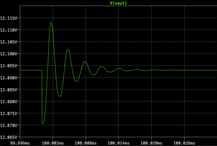

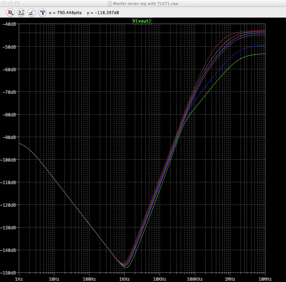

Firstly, if it isn't appropriate to continue to explore a high quality, high current Mosfet series pass regulator here please let me know and I will start another thread in the power supplies section of the forum. It would be good, however, to have the participants here contributing there.

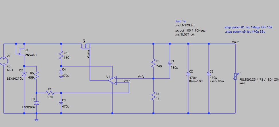

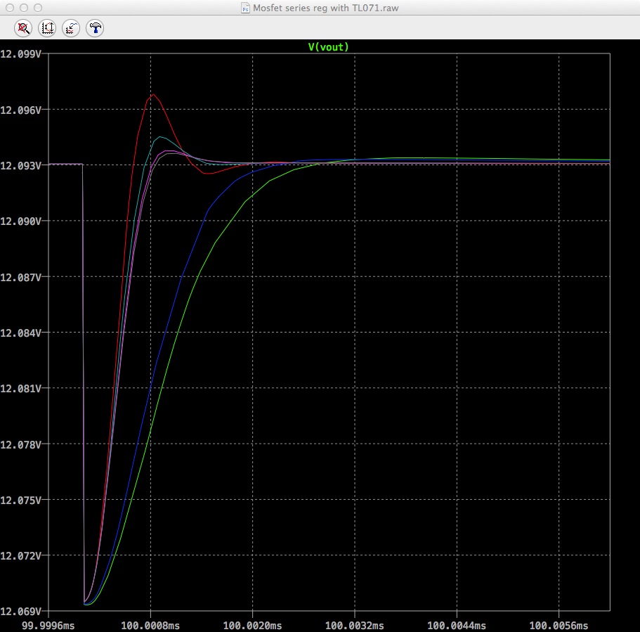

Here's a simple reg circuit. Nothing original here from me. Vref and Vs for op amp from Vin. Mark's circuit for Vref. I explored using the LTC1150 as the op amp but it oscillated with a step in load so this uses a cheap 30p part instead. Performance is, I guess, good but not nearly as good as the Jung/Didden regulator out past 1kHz.
How to improve from here:
1. Better current source for the Vref zener?
I tried, unsuccessfully, to apply some of the guidance from "The Art of Electronics", namely bipolar transistors make better current sources than JFETs. I haven't yet tried the cascode suggestion. (BTW it was odd, to me at least, that with the LTC1150 as the op amp, the noise rejection of the Vref circuit flattened at -160dB rather than continuing to decline.)
2. Vref from Vout?
The use of a MFET for the pass device would seem to make this rather challenging. And then there's Mark's warning with respect to compounding negative and positive feedback circuits. Much to be gained here?
3. A different op amp?
As Mark might say, use a "man's" op amp? This cheap'o op amp has a GBW of just 3MHz and CMRR and PSRR of 100dB. It benefits from a low pass filter to its supply (whereas the LTC1150 did not). I'm still struggling with my attempts to drop a AD797A or AD825 into the circuit but will try to get that nut cracked today.
4. Run the op amp supply from Vout?
As with 2, this would seem challenging. In a different thread Mark had suggested a circuit which allowed the op amp to start with Vin and switch to Vout when it was up and running. I tried this with the LTC1150 and couldn't get it to work. I'll try again with this op amp.
5. Dampen the transient response?
Mark will perhaps highlight that Vout's reaction to a very large kick in load looks like an underdamped control system. I will have to get out my notes and figure out implied zeta and phase margin. But how to manage this in this sort of circuit?
6. Implement Kelvin sense capability
7. Other?
cheers
Steve

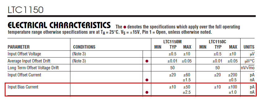

In a chopper stabilized opamp like the LTC1150 that SGK is using?U1 sees different DC resistances on it's inputs.
-IN sees 740||1k||120uF
+IN sees 3k3||470uF
This will lead to an increased tempco as well as an output offset.
The tempco will change the offset.
Rthev_neg = 425
Rthev_pos = 3300
Voffset = Ibias * (Rp - Rn) = 2.9 microvolts
I just realised I had the wrong transistor in my previous output charts. It's also interesting to compare the noise regulation of that circuit with different transistors, observing that the one which produces the best noise rejection doesn't have the best transient response (Iload kicked from 0.25A to 5A). Here's some new charts.
Lots more work to do...
