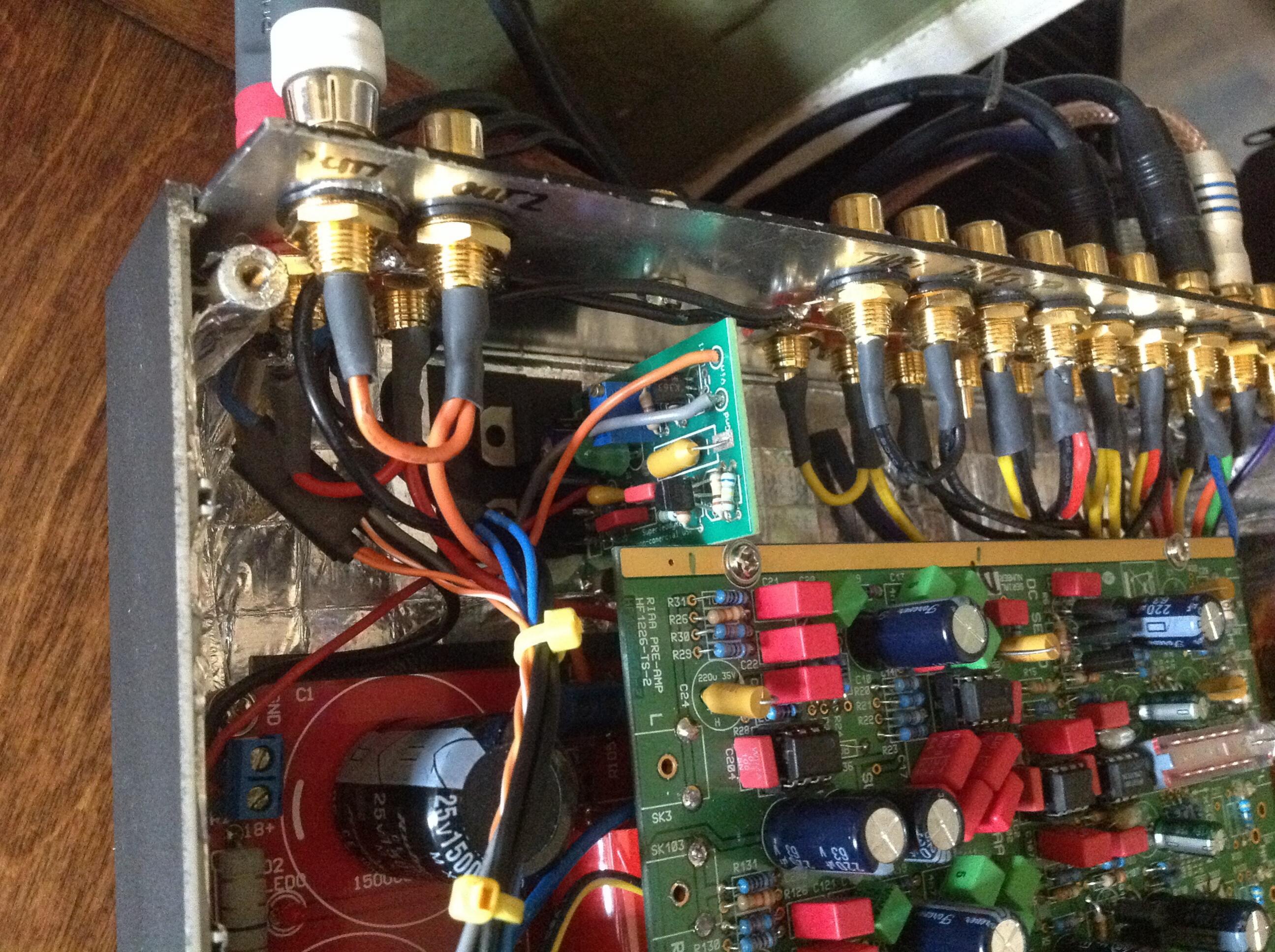

I apologize, I think we may be talking about different "super regs" I have tried to attach a pic with this reply. It says super teddy on it.
I was thinking of adopting one of these to put in a box with a PD gainclone.
At the moment they are in line with a phono stage rated at 15v
Perhaps better to build a new one from scratch?
My ears are bleeding -- the SuperTed scores very poorly on the FFT test:
Yes maybe not the best money can buy, but still better than nothing. I'm sorry to hear your ears are bleeding 😉
