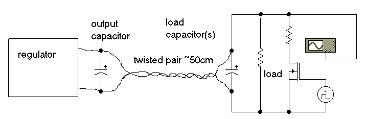

Dear Christer and Peranders,
This is how I test regulator dynamic behavior from the output side during last 20 years. May I recommend you to do the same with any regulator, starting from three transistors types to precision one. You will be astonished and will forget about dc uV and use Peranders C.
dimitri said:Dear Christer and Peranders,
Of course you are astonished. You thought you were measuring the regulator, but in effect you have been checking the dynamic impedance of a cap with parallel inductance with DC offset. 20 years you said?
