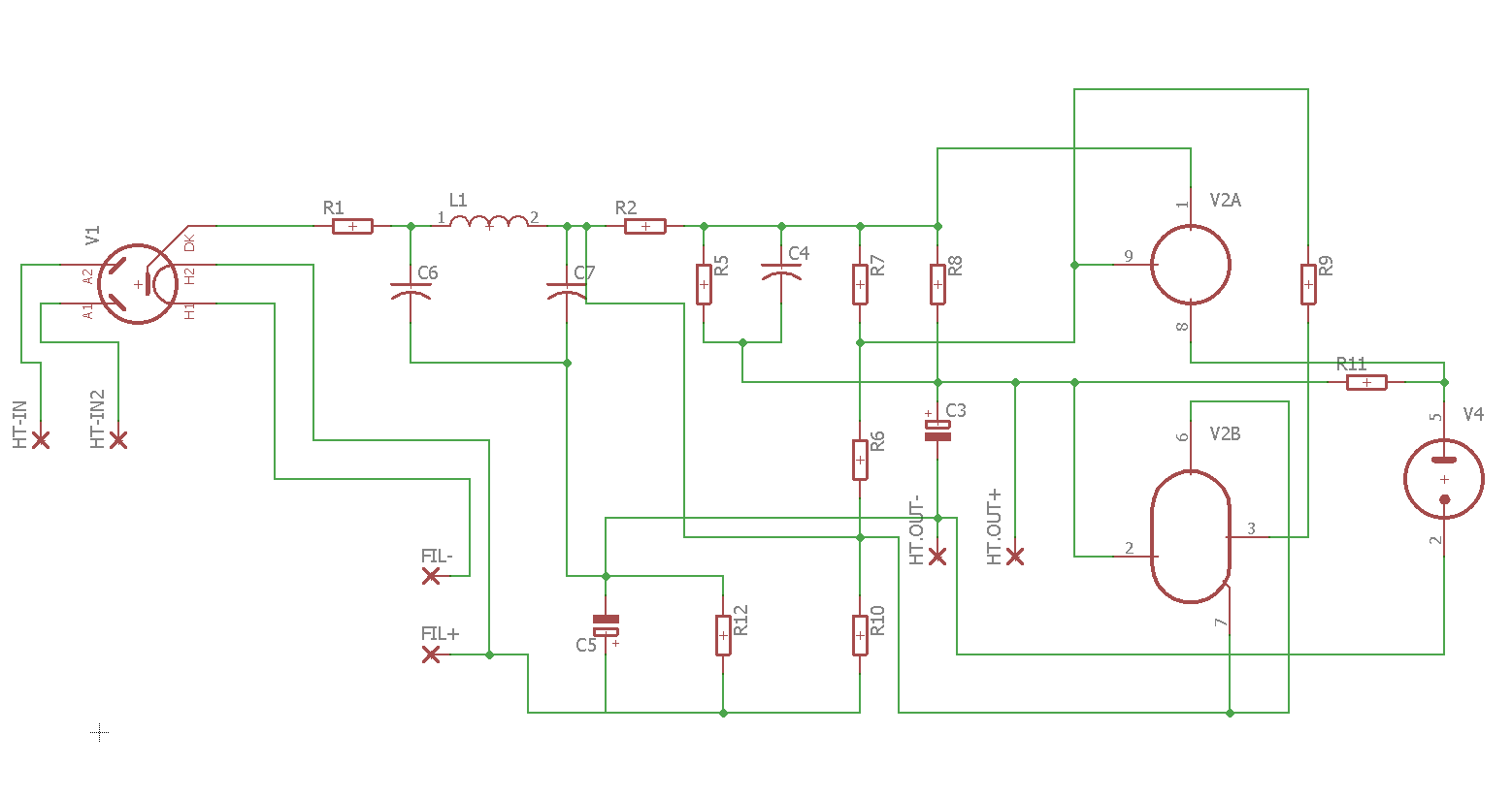

Hi, I had the opportunity to have in my hands a phono stage with a disproportionate cost, my nature of copying and self-building things led me to copy the very sophisticated power stage, which according to the manufacturer is also patented, yes it is a rectified and stabilized all tube power supply, since the power supply is the important part of a construction I would like to replicate it for my various pre and phono electronics mainly. For the avoidance of doubt and problems, I do not name the manufacturer or the model for the moment, the attached circuit is without the value of the components that I will add later, I only tell you the valves: V1 6x5gt, V2 ecl82, V4 ob2, before I want to know what you think and if it really is worth as much as they pay it.

More than sophisticated I would say very expensive, sophisticated calls it the manufacturer, given how much it is sold, not knowing much about the world of tubes unlike a solid state stabilization, I think it's not very linear or am I wrong?

TUBE power supply? Sorry, but what century are we in? As usual, I dare not second guess Jan as he knows more about audio in his little finger than I will ever and half what I know I learned from him and John Curl!
What are your requirements for voltage, current and noise? For a very few bucks we can buy SS regs with noise in the low uV. If your noise floor is -130, what else do you need? If you need HV or HC, follow them with a MOSFET. Only good thing I see above is a pi-filter.
Clearly, I am not in the tube mystique world. The tube amps I built I converted to ss power and it improved them both. These days, the only tube I still use is my microwave and old scope. Cant afford to replace the scope.

If You made circuit 1:1 as original, the circuit from the schematic does not working at all because You didn't connect ground plane. And it is dangerous, could cause damage...

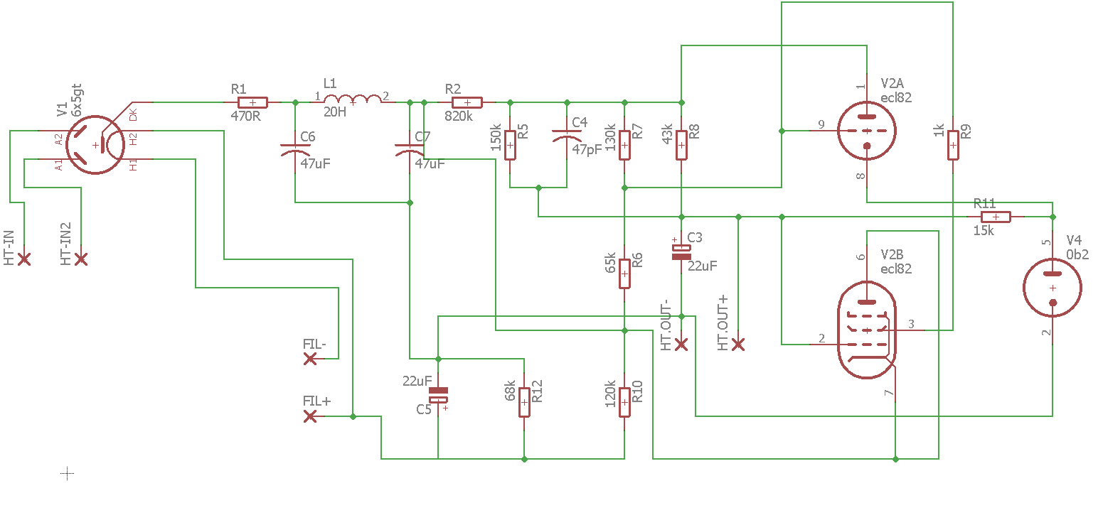

As promised here is the parts list:
R1-470R
R2-820K
R5-150K
R6-65K
R7-130K
R8-43K
R9-1K
R10-120K
R11-15K
R12-68K
C6 / C7-40uF
C3 / C5-22uF
C4-47pF
L1-20H

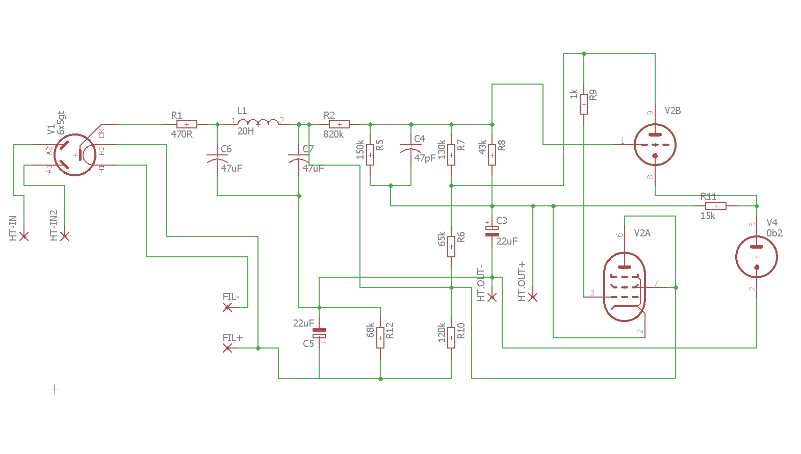

Now here's my question, this power supply works with 370v input, if you want to change the output voltage, which components need to be replaced? in input I will use 300v

You will get a lot more faster replies if you show a schematic with annotated values. The way you throw all this up means a lot of work.
