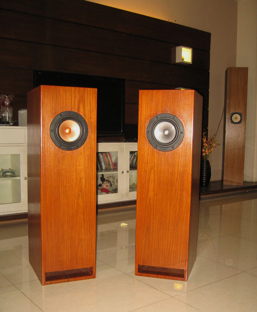

Zia,
Wow! Those look amazing! Beautiful cabinets!! Just wait till you get the stuffing in and backs on, it really brings everything to life and gives it solidity. You'll love them even more 🙂 Until then, enjoy!!
Scott
Thanks Scott and UL. I was lucky to find some really nice Teak veneer. The workman did a great job with the finishing too. The Mark Audio Alpair 12 drivers are really beautiful - they look wonderful in the cabs.
I am sure the stuffing will make a huge difference - will get that done hopefully within the next few days.
Scott, how are your Super Pensils playing? Have you got the baffle fixed?
-Zia
UL,
The veneer I had was very thin and pretty flexible, so we went for wrapping the veneer around the front of the baffle right to the edges of the sides. So there are no joining/edge marks at the front.
The top veneer came out of separate pieces, but again maybe due to the thinness of the veneer, there are no perceptible edge marks.
-Zia

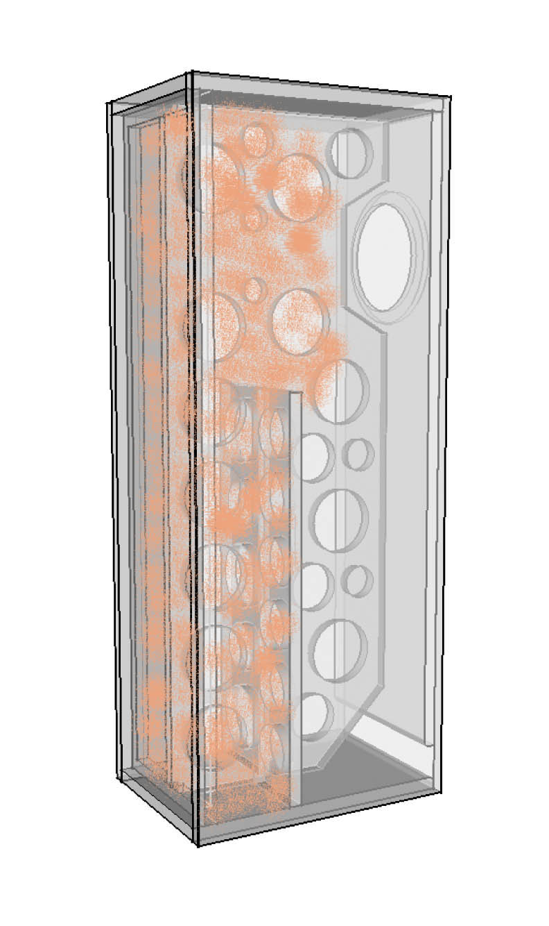

Started to experiment with the damping.
I have attached a picture of how I have my cabinet filled with hollow fiber fill - is this the right way? Or am I missing something?
Initial listening impressions - it's handling what I'm throwing at it pretty well - again very detailed, excellent imaging, got decent bass with weight too. The bass is very tight, bit different from typical woofer bass.
Treble is nice and transparent, but I am not finding it harsh in any way. I remember one magazine showing some charts that indicated treble harshness, but the top seems smooth to me. I am listening slightly off axis.
Playing it with a 5 watt/channel SEP. Plenty of SPL, but my experience tells me that the speakers will really like something with more watts.
-Zia

Zia,
I doubt you're doing anything wrong with the stuffing but I'm no expert 🙂 I have mine evenly distributed throughout each of the cabinets and it works great but would it be better doing it your way, I dunno! I'm sure Dave or Scott will chime in.
As far as power goes, I've got my Onkyo TX-SR805 receiver powering my Supers ... with 150wpc. Yeah I know, its a receiver and they're usually WAY over rated but there's been lots of independent tests and they show actually MORE power than the 135wpc claimed by Onkyo. Its not the cleanest amp in the world but its pretty good overall. I'm sure with the tubes you have they sound fantastic though!! I'd love to do tubes ...
Scott

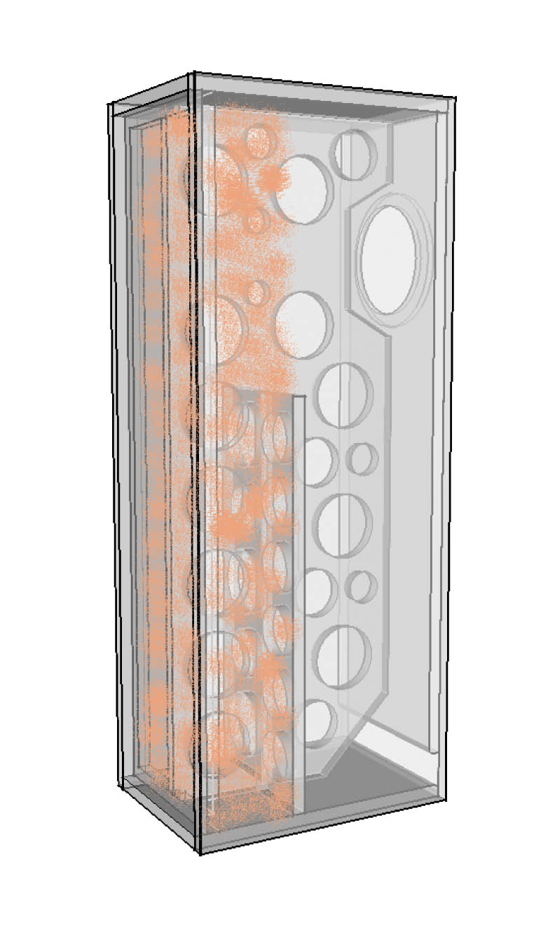

Scott,
I tried all four chambers - it starts sounding compressed, smaller - probably due to the quality of material I have. My Acousta-Stuf should arrive early next month. Then I can explore this in more depth. When I opened the cab to adjust I found some fluff closer to the driver, so it probably looks more like the attached image with this post.
However that still leaves a lot of the line open - I think this is less than ideal.
Strange thing is that cones hardly move. I've thrown some pretty bass heavy stuff at them, but don't see them agitated in any way.
-Zia

There are no chambers in the Pencils. If you have any, something is wrong somewhere.
Damping is specifically intended to be adjustable to allow the user to tailor things as they wish. That's why they have the removable backs. Default is a uniform density throughout appropriate to the desired system response.
Hi Scott,
Sorry for the confusion, the holey braces kind of divide the lower section into 4 parts - I was referring to that only - definitely no separate chambers! I built the Super Pensil 12 exactly according to plan 🙂.
The hollow conjugated fibre fill that I have is very light and springy - I haven't had much luck with this :headbash: - seems to mess up tuning all the time. I have ordered some acousta-stuf and that should reach me in early August.
