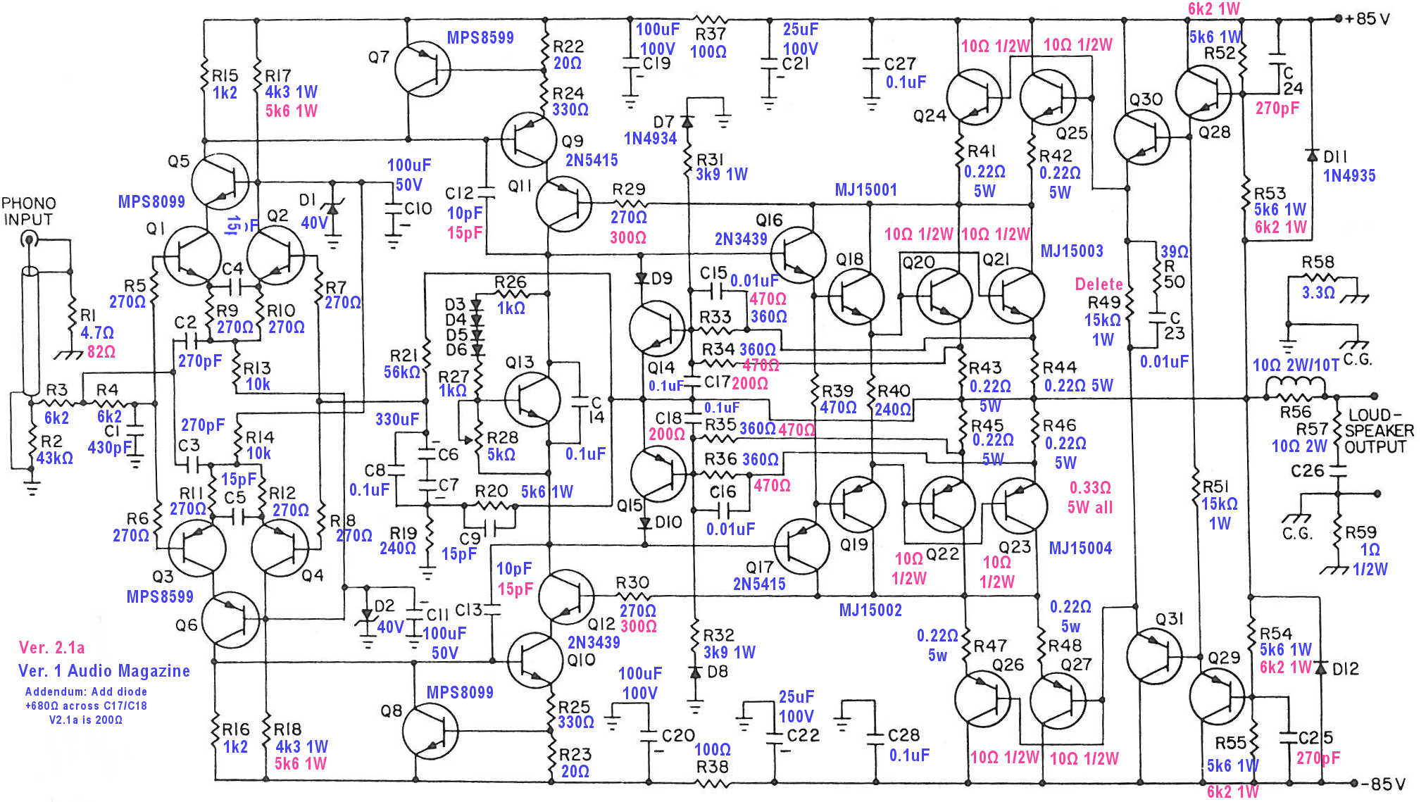

Unfortunate that this requires boosted rails for the front end:
http://www.diyaudio.com/forums/soli...100-mkii-single-ended-folded-cascode-vas.html
The Leach followed Otala's formula of high diff pair degeneration, and wide open loop gain -
VAS degeneration. This leads to lower loop gain available for overall distortion reduction.
I already made the VAS more Self Blameless like through the addition of the .5uf cap.
You could lower the diff pair degeneration making it very close to a Blameless concept,
and/or as we've said try different compensation schemes, Miller inclusive or TMC. I've not
tried TMC in practice and not heard from anyone if there are any issues.
I think that the oscillations that people saw in the Leach was local due to wiring inductance,
since you are planning all one PC it should help keep wiring inductance to a minimum.
I don't have a strong preference for an alternate topology. I'm planning to do something
with JFETs in the front end soon, but only to try something different.
People seem to like the Slewmaster but I've not take a close look at the schematics. His
designs are usually based on other favorites - nothing wrong with that.

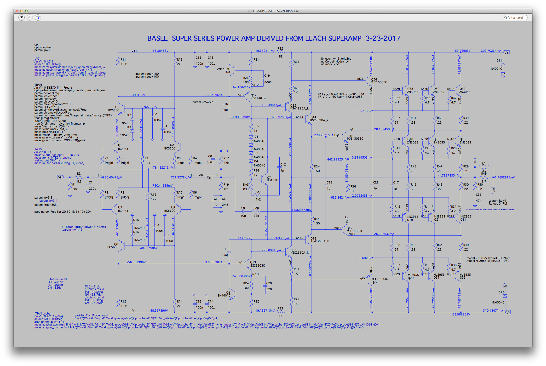

Well this is more complicated for the psu, but not too much of a show stopper. If it really helps, why not?
Yes, and I remember working on a few amps back in the late 70s that were designed with Otala's concept in mind. They were fully symmetrical, which I liked, and they all had degen and local feedbacks all over the place, reducing the open loop gain.
I more recently did a few sims on those old designs, and they all have that same thing in common, as with the leach designs, the thd is high. So the goal of reducing tim lead to much increased thd. Exchanging one type of distortion for an other. It seems tim is much harsher on the ears than hd is, and I guess that's why the high thd doesn't seem to disturb many people, who find the leach low tim better to listen to.
I think with the newer designs, both reduced tim and low thd can be achieved and without resorting to too much degen and reduced open loop gain.
An amp with fast enough slew rate and just enough degen to avoid input saturation should be able to avoid the apparition of tim, even if the open loop gain is much higher.
I already made the VAS more Self Blameless like through the addition of the .5uf cap. You could lower the diff pair degeneration making it very close to a Blameless concept,
Why not! I see nothing wrong with Self's blameless concept, and it shouldn't leave too much opening for tim to occur.
and/or as we've said try different compensation schemes, Miller inclusive or TMC. I've not tried TMC in practice and not heard from anyone if there are any issues.
I tried that on this superamp, but at the time I didn't remove the inner feedback loop, and going tmc didn't bring real improvements.
I'm wary of touching that inner loop, with too little understanding of it. So short of removing it altogether, I just don't touch it.
Lately I tried tmc also on our latest design, and it was about the same as regular comp, so perhaps the inner loop is also preventing the full effect.
I think that the oscillations that people saw in the Leach was local due to wiring inductance, since you are planning all one PC it should help keep wiring inductance to a minimum.
That's probably what was happening, especially since most of those builds were done using the old methods with wires going to power devices and the likes. Too much long wiring and connections, that can bring more troubles.
And that's also why I don't like the diodes for the thermal comp. I would change that, even if it takes using diodes with cases that can bolt on a sink.
No SMT, and no wires.
I don't have a strong preference for an alternate topology. I'm planning to do something with JFETs in the front end soon, but only to try something different.
I always favor fully symmetric topo, and I never liked any kind of fets in the signal path. Just a personal preference. So no mosfet amps for me.
I might consider fets in the current sources for example, but I'm not hot on using fets for other things.
People seem to like the Slewmaster but I've not take a close look at the schematics. His designs are usually based on other favorites - nothing wrong with that.
Nope, nothing at all. It works quite nicely.
Ok, now I remember looking into this before, and saved the forum pages. I will have to re-read all that. But I don't remember finding a full blown solution that satisfied me.
You might be surprised with the distortion if you drop the diff pair degen to 0 or 10 ohms,
100 ohms might be a good compromise.

You might be surprised with the distortion if you drop the diff pair degen to 0 or 10 ohms, 100 ohms might be a good compromise.
Not so surprising, with a bit more open loop gain.
I dropped the base res to 100ohms along with the degen ones, then adjusted the compensation to keep enough margins.
The thd at 20k is cut in more than half, just below 0.02%, and at first, before adjusting the compensation, it was down to just below 0.0184%, but there was only about 22deg of phase margin, so not enough, and I adjusted this.
I couldn't get the margins as high as with 300ohms, but still about 60deg/24db, so not too bad.
I adjusted the value of the big cap on the feedback, to drop the thd at the low end to decent values compared to the rest of the spectrum. With 2200u there is no increase of thd at 20hz in regards to higher frequencies, so it's not so huge a value, with a low voltage cap like 6V3 or so, those aren't so big, and we can add diodes in parallel with it to protect it.
I ran stepped frequency sims and here's what we get:
.step freq=20
Total Harmonic Distortion: 0.002998%(0.000000%)
.step freq=50
Total Harmonic Distortion: 0.003018%(0.000000%)
.step freq=1000
Total Harmonic Distortion: 0.003270%(0.000000%)
.step freq=5000
Total Harmonic Distortion: 0.005883%(0.000000%)
.step freq=10000
Total Harmonic Distortion: 0.010580%(0.002547%)
.step freq=20000
Total Harmonic Distortion: 0.019972%(0.017832%)
thd is climbing fast beyond 1khz, but we're maxing out near 0.02% by 20khz, so not so bad.
I would be tempted to do this compared to the 300ohms version.
The drop from 300 to 100ohms degen gives about 10db more of open loop gain.
The lower base res values also reduces noise.
This is at 4ohms resistive load. Simulating for worst case 8ohms complex load.
A modern Leach with less degeneration, and MIC compensation:
http://www.diyaudio.com/forums/solid-state/306159-ati-amplifier-schematic.html#post5040817
I looked this over and besides the 3EF output, I'm not seeing it much as a leach. The front end isn't even cascoded and it uses current sources, so nothing really in common there besides the fact that it's symmetric ltp.
There is no inner loop from the predrivers either. But that C2 cap???
And those HF loads on each ltp output, I've seen this on bryston amps.
Those back to back diodes on the ltp inputs, with the amount of degen present, may be more a cause for clipping the fast input transients. I've simulated ltp stages with varying degen values to see how much headroom is gained, and unless there is no degen at all or a very small amount of it, the diodes can only get in the way instead of doing any good.
Those diodes can be useful with no degen, as they can prevent overloading on the ltp. Once the degen gets a little heavier, there is far more than enough headroom and it takes a lot more to overload that ltp, so then diodes there are just forcing an early clipping.
Among those test sims for ltp degen, I tried varying the base stoppers, and didn't find them to make much difference. What are they really good for then? If they're just acting as plain base stoppers, they don't need to have a high value.
One other odd thing is that bias spreader with 3 trannies, instead of the diodes based leach spreader. Is it really necessary to have such an arrangement? Wouldn't a single tran spreader be sufficient?
Interesting diode protection that you might want to try.
I must say I don't quite understand how this thing really works, and what is the role of those 3 diode strings.
For one thing, that type of protection can't be soa, and it doesn't act on the drive signal. The way I see it, this schematic is incomplete when it comes to protections, and something is left off that pertains to what it actually acts on.
I'm suspecting some type of clamp or crowbar or something of that nature. That "PRO" output looks like an all on option...
Plus that Q126 thingy looks like it must be trying to DC detect, sort of...

I notice the feed-forward loop is different on Ver. 1 compared to Ver 2.1a for the Double Barrelled Amp.
Takeoff was on the O/P of the 1/2V dividing triple and Dr. Leach moved it to the O/P of the first transistor of that triple.
Do you have a schematic to post for comparison?
I'm only looking at the latest version, and the inner loop looks the same on the regular and super leach, with the pickup being made on the predrivers.
I view the diff pair cascode on the Leach being their mainly to allow the use of lower voltage
devices, yes it is also a cascode. Comp diff, VAS with no beta multiplier, triple output are
what say Leach to me, dont care where the diff pair tail current comes from.
All the other differences, MIC etc. might be good to consider.
The back to back diodes are to protect the amp from massive overload of the input, 10V or
something like that.
I did not look closely, but the diode strings are probably like the protection diodes on the
JE990 which was a common method for very simple output protection, right not SOA.

Schematic for original Double Barrelled amp
Here is my schematic for Ver. 1 (as I call it) of the Double Barrelled amp, from the original Audio Magazine 1980 article. Added mark ups for component value differences with Ver. 2.1a
I note the feed-forward takeoff is different, and like early Low-TIM's, main NFB is only to the output (no HF NFB from the driver).
I built this amp in the 80's and decided I need to retire it and build a new one.
Researching Dr. Leach's updates and mods to use fT 30MHz O/P transistors... This is why I am interested in your sims. I can't afford to troubleshoot oscillating triples, lol.
