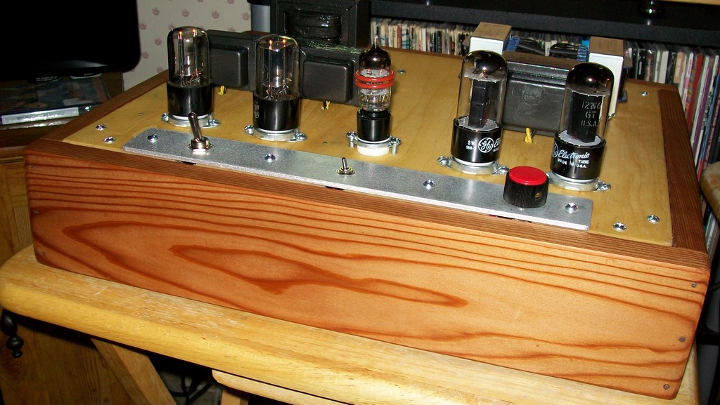

Aldovan since this thread has come back to life, I would like to show what I built using your faith in the 6w6 variants. I posted this already in the gallery, but I got the idea to try these tubes from you and your YouTube video.
I went a little beyond simple in the power supply/filament area, using a well filtered/isolated voltage doubler with a rectifier/filter section for each channel. My "voltage doubler" ended up putting around 350 volts with no load, so I had to do some modification and got the voltage down to around 325. I also have separate supplies for the various filament requirements.

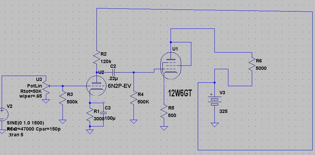

The amp circuit however is as simple as can be. I tried the LED biasing, but in the end I liked the resistor better. I also went from originally, a 12AT7, to a 12AT7B, and finally a 6N2P-EV.
I used simple Edcor 5 watt transformers. The transformers spec from 40 to 18k. I forget the number, but they are listed in the 10 watt section because of their expanded low end over their standard 5 watters.
The only tube amp I have to compare it with is my Tubelab SSE amp, and though different it compares very well with this amp. The 12W6 is sweater in a good way though. I have picked up over 30 of the tubes for less than 2 dollars each, so I now have a supply on hand to last me quite a while.

I used DC on the heater voltage for the preamp tube, so its easy for me to change voltage from 12 volts to 6. Needless to say I tried the 12AT7, a Chinese 12AX7b and 6n2p, and the 6N2P-EV. I originally simmed the amp in LTSpice with the 12AT7, but when I built the amp the 12AT7 was slightly lacking in gain. So I started playing around with the other tubes and resistor values, both in LTSpice and with my ears until I got a combo I liked best.
What you see in the circuit is the about the 3rd version and final values I settled on. Its been a few months since I built the amp, so I've forgotten the exact measured current and voltage values. If you want I can run the spice program and give you values from that.

Very nice amplifier !
But I prefer use a driver with good current capacity.
For me, the 6N2P do not is the best chice
In mode triode, a pentode need more current in grid, because the input capacitancy is high.
The 6N2P do not work fine with a led, because you need more current for linear operation of LED, normally 10mA or more.
In my opinion, if you use the 6N6P with 10-15mA, you amplifier will sound the best.
