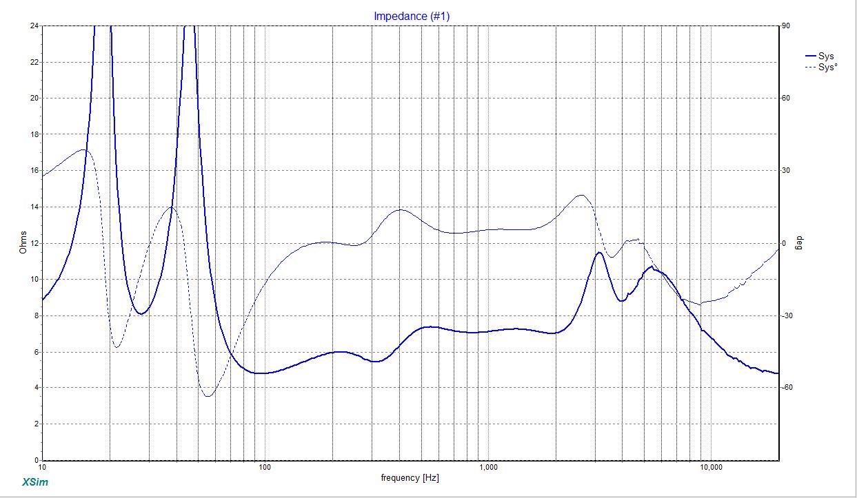

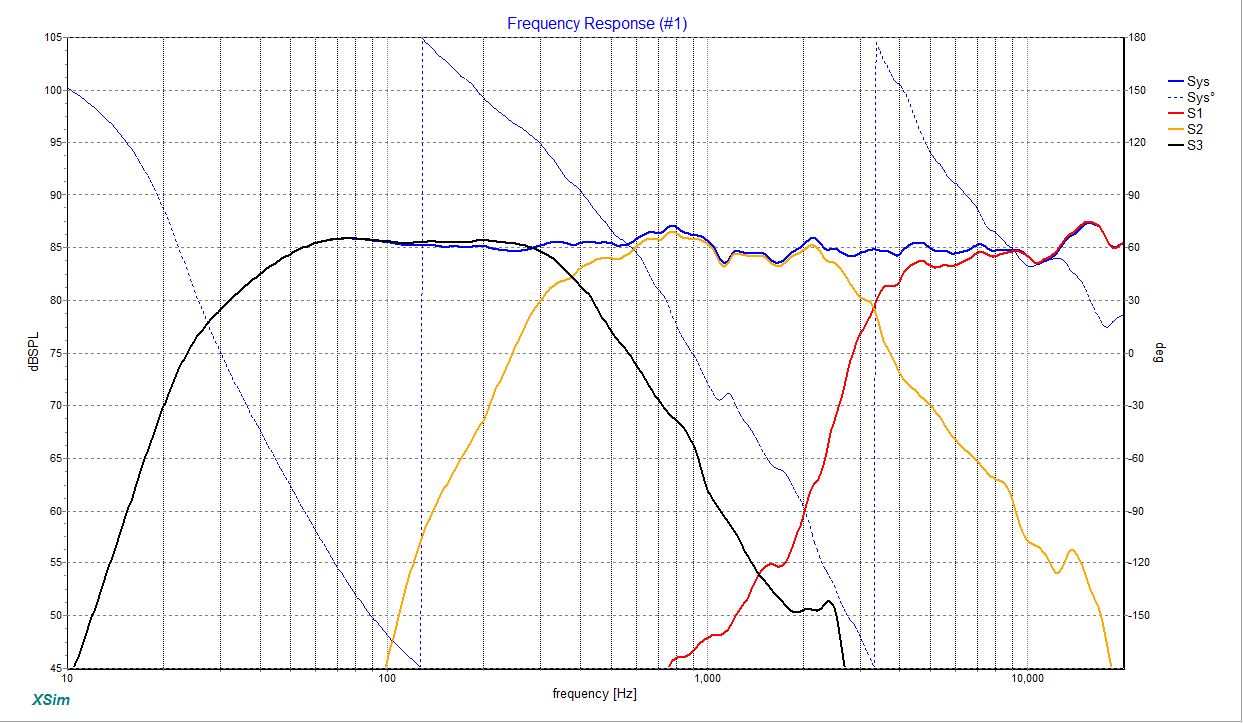

A simulation of TMW
Seems sensitivity of each unit matches well for a simple 3 way box. Woofer/mid XO point BW3, the other one is more like LR4. 80 litre vented box with baffle step included. Everything was prepared in Excel spreadsheet Response Modeler. Included is also approximated acoustic offset of drivers in a flat baffle. Drivers are SLS10, TC9 FD18-8 and XT19 TD00-4.

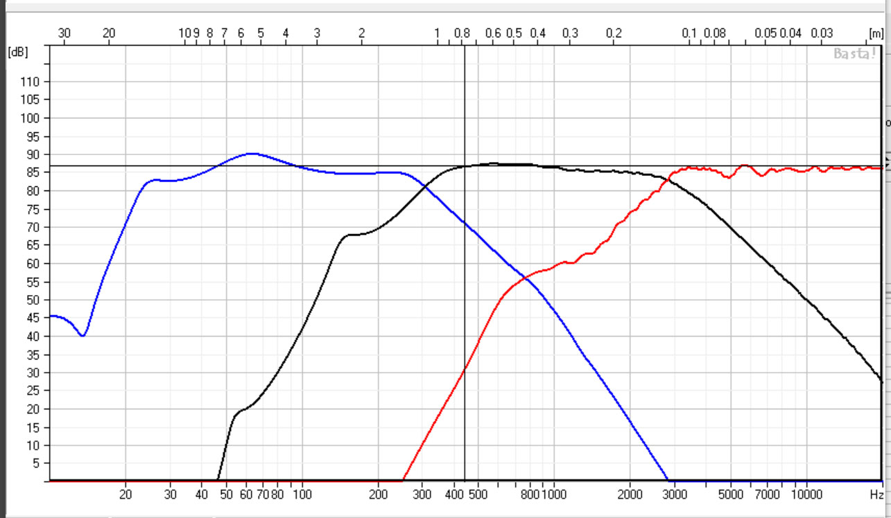

I played around with my three drivers in the Basta! software (which I think is amazing after first use.....very detailed/complex but an idiot like me can use it intuitively) and here is my first result. The system uses no L-pad and crosses over at 300Hz and 3kHz. If I enable room gain the lower base is a bit more elevated.....but i will use the speakers in a room with many large open windows so i just disabled room gain in the model.
@Lojzek. I used exactly the opposite. BW4 for the bass/mid and BW3 for mid/high. I don't know why thoug. just looked prettier on my graph i guess. I should read up on the differences between crossovers.
