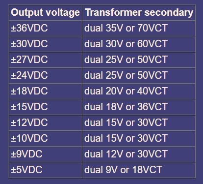

I'd like to refresh the theory behind the choices we/I went through, on the BA-3 thread more than one member suggested to raise the voltage as to minimise distortion and better couple the preamp with the power amp which is gonna be a FW F4, now this is pasted text from your's above reply:
"We established that you are in a 220VAC country, and Toroidy specifies their transformer output voltage with a 230VAC input. So, you adjust a little bit. It is very nice that Toroidy has so many selections. Many companies do not.
Example if you bought a 30VAC Toroidy: 230/30 = 7.6666666... => 220/7.6666 = 28.7 which is a bit lower than you want. You'd want either the 31 or 32VAC secondaries. It's a regulated supply so either would likely work very nicely. I'd err being a bit higher. It will not hurt.
So a transformer with - 2 x 32 VAC secondaries"

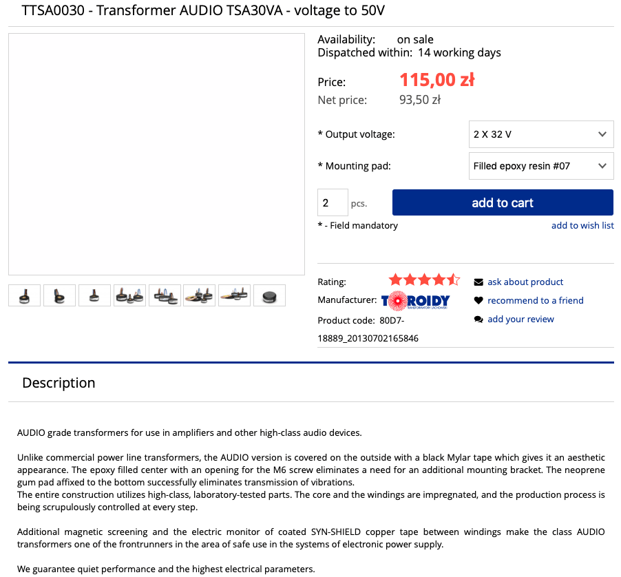

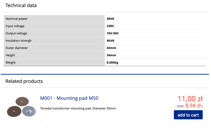

Let's see if I got the transformers correct, here attaching a print screen.
Question here being, once the Sigma 22 are fed with 32VAC we should get the circa 24VDC given the voltage drop estimated in about 8-9V, am I correct with this (sorry but can't retrieve exact info on voltage drop of the Sigma 22), 24VDC is what they all suggest for the BA-3 and in my particular need to feed the F4, correct?

Patrick would you mind repeating to me the calculations as to reach the desired 30VDC out of the PSU to feed the front end?
Transformer wise I got it, 230VAC vs 220VAC, from 30V secondaries to 32V ones to compensate the slight drop, you made the calculations and I do really appreciate.
Now I am going through the Sigma 22 description and (finally) found this out which explains how to dimension the transformer given the desired output at the regulator's end:
"a rule of thumb for this PSU is that approximately 8V-9V drop should be maintained across the pass MOSFETs under load. This allows for the 4V Vgs of the MOSFETs plus about 5V of headroom to allow for line voltage fluctuations. Using the ±15V output as an example, the pre-regulator voltage should be 24V. Accounting for a couple of volts drop across the rectifier diodes, that figure goes up to 26V. The transformer voltage should be 0.707 times that of the rectified DC voltage, so 26V * 0.707 ~= 18V. Thus, a dual 18V or a 36VCT transformer should work well."
If I use the above and want to obtain the +- 30V output and follow the rules by adding 9V (as per above +-15V plus the 4V Vgs + 5V headroom) we get up to 39 to whom 2V gotta be applied as rectifier does drop we get up to 41, 41 x 0.707 = 28,987
Where did I go wrong?

Sure, happy to try again. 😀Patrick would you mind repeating to me the calculations as to reach the desired 30VDC out of the PSU to feed the front end?
CorrectTransformer wise I got it, 230VAC vs 220VAC, from 30V secondaries to 32V ones to compensate the slight drop, you made the calculations and I do really appreciate.
You didn't go wrong. You're just not quite finished. You calculated the desired AC input from the secondaries in order to achieve the 30VDC output from the power supply. Now you need to determine what transformer to buy that will give you (as close as possible) to that output under a load.Now I am going through the Sigma 22 description and (finally) found this out which explains how to dimension the transformer given the desired output at the regulator's end:
To finish - 28,987 * 230 / 220 => 30.304 to compensate for your mains voltage and the fact that Toroidy transformers are spec'ed for 230VAC at the primaries for their output voltage (like you have mentioned above). If another manufacturer specified their transformers at 220VAC, then you would not have to do that last step. Hope that makes sense.
Earlier, I had simply looked at the table on the Sigma 22 parts list where it shows 30VAC for a 30VDC output. Then I simply did the mains voltage adjustment vs. doing the math the longer way as you've done above. 😀
30 * 230/220 => 31.36
Either way, the results are a close estimate. Your PSU has an adjustable range (within reason), so you will be able to set it precisely. A "31VAC" or "32VAC" secondary transformer from Toroidy will do nicely. Many companies do not have such small increments.
Hope that helps.
