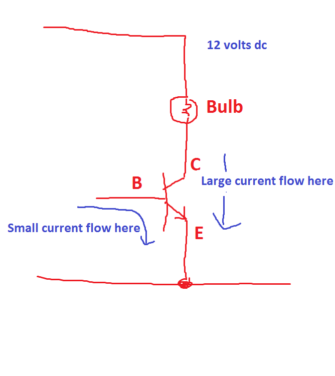

The saturation voltage can be thought of like this...
Imagine a light switch that's turned on. Because its mechanical (two contacts that close) there is no voltage "lost" across the switch when its on. Its a perfect conductor. If that switch were a transistor, and we forced it to conduct as hard as we could, there would be a small voltage "lost" across it. That is the saturation voltage. Its small but in really high current applications significant because that voltage, and the current flowing through it, equals power lost which in turn equals heat generated and a loss of efficiency.

Here is an NPN transistor being used to turn a bulb on and off. By passing a small control current through the base-emitter path we cause a large current to flow in the collector-emitter.
Once we force the transistor fully on, if we measure the voltage across the collector and emitter we will measure the saturation voltage.
The voltage between base and emitter will never exceed around 0.7volts no matter how much current we try and force through.
If we reduce the current through the base emitter junction the transistor will only be partially on and the bulb will dim. The voltage "lost" is now over the collector and emitter. The base to emitter voltage will still be around 0.7 volts.

Thanks.
