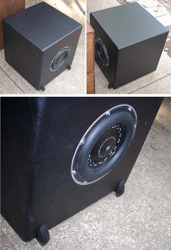

I was hoping for some more detail on the Super 8. Dimensional drawings would be extremely helpful, as would a frequency response.
More than those, however, I would love to see a validation of the .157mH Le spec, which is extremely low, particularly for a driver of this type. If it's verifiable, then these jump up on the desirability scale by about 6 notches.

Badman, I have an cheap and I do mean cheap meter that typicaly is off about 20%
using that meter I get .289 mh then using the CHEAP woffer tester from PartsExpress
I get .45mh so that .157mh may be a little low. One strange thing about that driver
is it has a rather wide bandwith. It's been a long time since I measured it but I think I
rember it going to above 10K but having said that it does have a rather nasty peak
about 2k but in subwoffer use that shouldn't be a major concern. Let me say again
my measurements may be off a country mile....

Low Le tends to mean a few things with respect to motors. 1 is that the Le(x) typically will be much flatter with a very low Le. This is source of distortion, though more high-frequency oriented. It also tends to be an indicator of certain characteristics in motors, mostly desirable. In this case, it may only be that there's a lot of clearance in the gap, to allow a little rocking during extreme (approaching Xlim) situations, though there is a chance, given the (impression of) build quality, that there's some shorting in the motor. It's likely a single-layer coil, too, and in whatever case, the steel seems like it'll be saturated under all conditions, which is obviously desirable.

It's been a few years, but I built an active sub using the Super8 and the full-range amp from ApexJr. The driver seems to be a true sub, in that it did not have much usable upper frequency extension. My experience is different to yours.
i Disected one of the Two Super 8's i bought...the Woofer is a Monster and the build quality is excelent....the Voice Coil was a 2 Layer 2" Coil on a Kapton Former...the Pole Piece was Extended,i dont have any means of Measuring to gather real numbers...but the Super 8 does play well into the midrange...however it is not particulary clean,and by ear it sounds a bit Peaky,and nasal...the bass extension is it's strong suite...despite the rather Stiff Suspension and Highish FS (Posted around 47 Hz) the Super 8 Plays Deep,and even subsonic notes Easily...(that Large Magnet must make a Very Strong Motor)....being advertised as an 8" Sub the Large Surround on the Super 8" means the actual cone area is more like 6.5",not a big deal considering its low bass capibility.

I've been quite happy with my push-push Super8 woofer. I have measures but that doesn't include Lvc

I now have them in my mains (with RonHorn A126, XO set to ~50). They don't intrude, integrate pretty well, and add nice weight at the bottom.
