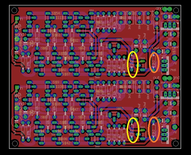

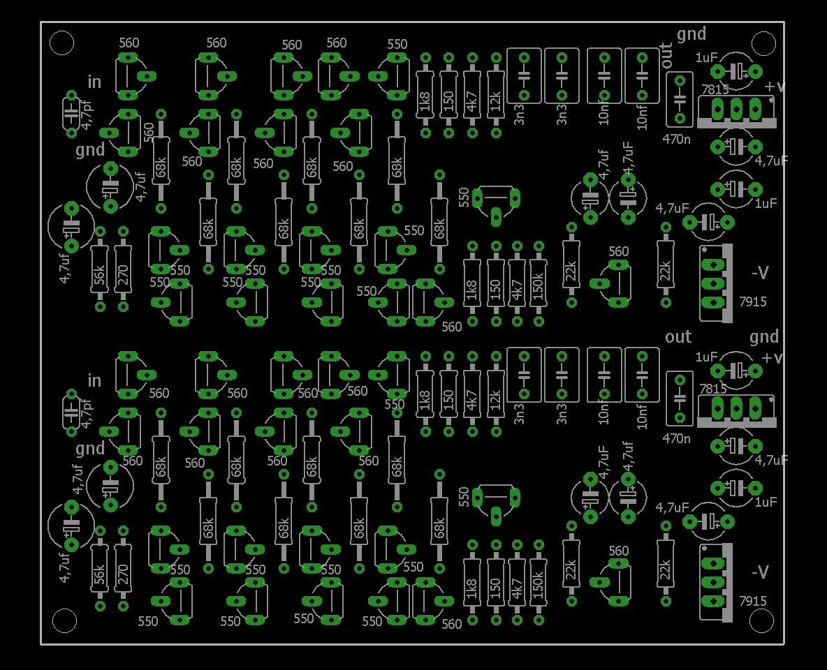

I'm still trying to clarify the board with the schematic. I count (3) 4.7uf caps on the schematic per channel. The red board shows (5) 4.7uf/ch?? Specifically what value cap goes in the position right next to the labeling "7815"? Also the transistors labeling is not that clear. Can you clarify please. Do you have an updated schematic that matches the board?
i update the boardI'm still trying to clarify the board with the schematic. I count (3) 4.7uf caps on the schematic per channel. The red board shows (5) 4.7uf/ch?? Specifically what value cap goes in the position right next to the labeling "7815"? Also the transistors labeling is not that clear. Can you clarify please. Do you have an updated schematic that matches the board?

Here is my MOUSER order:
Transistor :
BC550CTA
BC560CTA
Resistors :
MBB02070C4701FCT00
Caps :
c1=4,7pf
Replaced by 330pf to match with my cartridge
FKP2D003301D00HF00
c2,c3,c9,c10,c11,c13=4,7uF 25v.
UFG1H4R7MDM
c4,c6=3,3nF
FKP2D013301G00HSSD
c5,c7=10nF
FKP2C021001G00HSSD
c8=470nF
didn’t fit well, but wanted to try Nichicon MKP
QXP2E474KRPT
c12,c14=1uF
UFG1H010MDM1TD
Not populated for the moment.

Congratulations Mr. Scafus on an excellent sounding Pre! Just breaking in and sounding very good so far.
Very happy with the result ! Thank you Scafas for the pcb.Congratulations Mr. Scafus on an excellent sounding Pre! Just breaking in and sounding very good so far.
