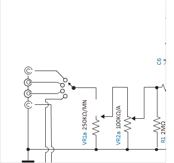

Question for the forum regarding to the Level control on the Preamp:
At the beginning of the thread Victor posted: "Input Volume: Yes"
Is his post in reference to the Level control acting passively into the gain stage.
Or does the Level control increase output voltage - dB? (i.e., What does the Level control actually do?)
I don't see another pot that would suggest the Preamp is able to adjust both the source input and output.
Given my question I'm sure it's apparent that I've never built a component.
Thank you for your patience with a relative newbie to amplification.

From looking at your diagram and the pics of the inside of the preamp it looks like the Level control is active rather than passive. That is, the Level control adjusts the amount of amplification (volts/dB) that is sent to the RCA outputs rather acting as a passive volume before amplification adjusting the input of the source.
Hence, it appears that the Level control directly affects/regulates the amount of volts/dBs that are sent to RCA output.
Some preamps I've seen have adjustments for both passive input (source) and active output (adjusting how much gain is added to the output into a power amp). One of the posts above suggested to a member that they swap the Level control for a passive stepped attenuator (at least that was my understanding), which created further questions regarding what the Level control was actually adjusting.
Am I understanding correctly?

WardAR, Post 44 shows the input jacks, the input select switch, the balance control, the volume control, then through a resistor to the grid of the input tube (not shown). (Or maybe it's the volume and then the balance, I forget which it's been years since I built one.) This is the typical layout of most line stages i.e. the gain of the circuit is fixed and what the volume control does is adjust how much signal is applied to the input of the active circuitry. Hope this helps.

The wiring runs from input selector to balance pot to volume pot, then to the circuit. The issue you might have replacing the pot is that the chassis hole for the supplied pot is too small for an Alps or a stepped attenuator. You would have to drill it out. For my build, I decided not to bother.
