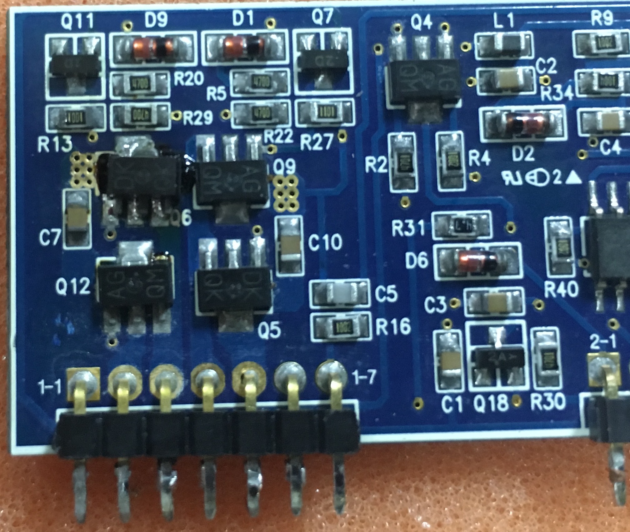

Hello, I have an SAZ 1500 in front of me I bought as an experiment to see if I could fix it. I have a little tech background, but this is my first time in a 12v amp. I bought this amp, replaced all the output mosfets, and immediately blew all four 40amp fuses, as well as some of the new mosfets. I removed all the output mosfets, and used a bench supply to turn it on, but the supply would go into protect and not feed any more than 8 volts. While poking around the unit, something labeled DK QK (looks like a transistor?) on the daughter card smoked. I am curious if anyone could explain to me what this card actually is, it's function, and if this burnt transistor could have caused the previous issue as well as its own demise. Should I just replace the DWM1216FV or is there something else that could have cause this and the rest to fail?

Hello,nice to meet another starter. Better make a Photo from the whole board.
The card with the burned Transistors is the driver card for the mosfets. Make a good Picture from both sides. This card has to be repaired, before you can mount new mosfets.

The 470 ohm resistors near the driver transistors that failed, commonly go out of tolerance and must be replaced.

Are you referring to resistor located on this card or on the main board? Would you or anyone happen to have schematics that may help me make heads or tails of this board or card?

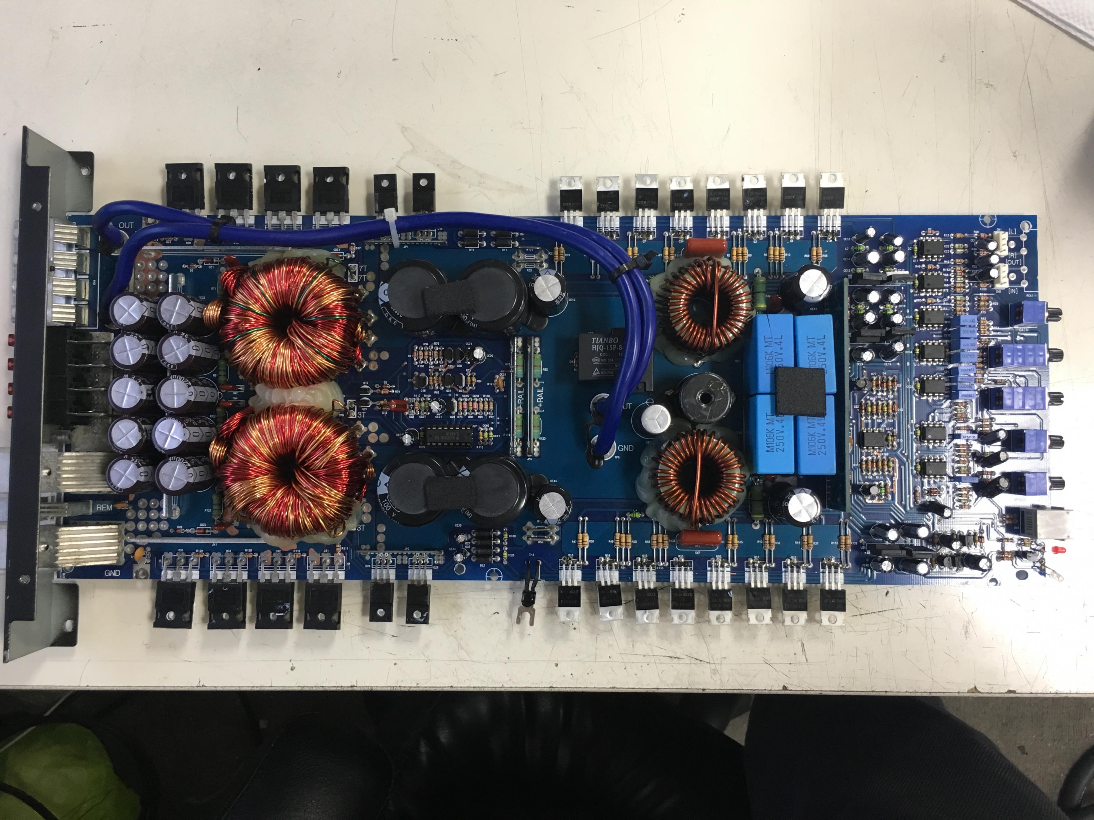

Hello, and thank you. Here is a photo of the amp. I was told by Sundown that they could sell me a replacement card, but not supply me with component data or schematics, so I may just purchase the card from them and see where it gets me, I am just reluctant to replace it without knowing why it burned up in the first place, was it due to another failure on the card or is there some menace on the board that could be lurking waiting to fry the next card I solder in?

Thank you for all the advice so far. Sundown just contacted me and told me that they are three months out from restocking these driver cards, so it looks like I will have to try my hand at repairing this one, unless someone has a card to sell me here.
Q7, 11, 19, 22 all measure fine using the diode test as well as all the rest of the transistors on the card. However I have a fried Q6, which got so hot it melted some of the solder and slid out of place. You can see the burn mess it is currently in the photo. R27 also measures as a short, and I have some strange discrepancies between the brown caps between the left and right side. C7 is sitting at 1500Ω and C10 is at 150Ω. Neither of them charge or discharge.
Could anyone please identify what Q5 and Q6 are, they are both labeled DK QK and I have tried to google them a few times without success.
So could anyone provide me with values of the following?
Q6
C7
C10

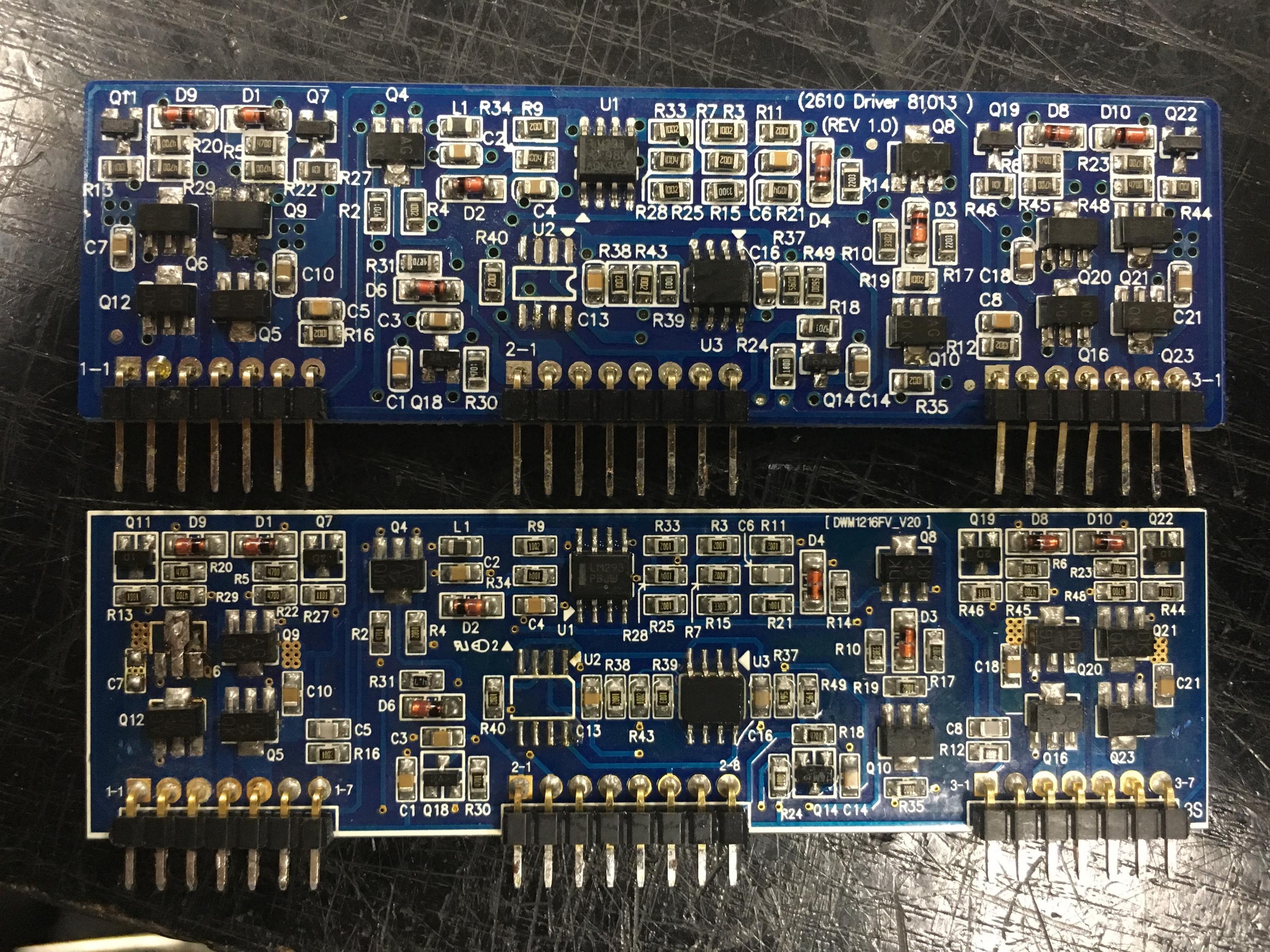

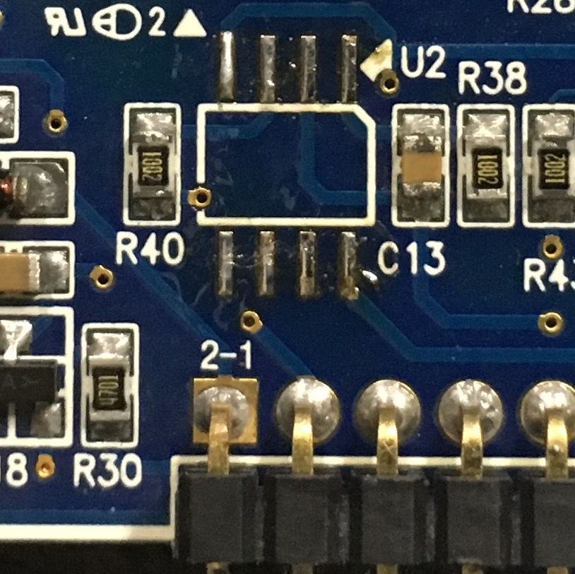

So I had bought another driver board and put it in the amp, still having lots of trouble. I eventually pulled the driver card after not seeing any nice square waves from it. I compared it with the one I originally pulled out and found that pins 5 and 6 of U2 of the new one are continuous with pin 2-4 on the card. I do not have this connection on the original one. I decided to repopulate the original, but I would like to test it out of the board because putting this in and out of the motherboard many times is starting to fatigue the vias. Does anyone have a test procedure for the driver card out of the amp?

The class D - type 8 page has a lot of helpful information. If your browser doesn't show all of the images, right-click the link in the directory and open in new tab.
There is virtually no way to get the boards in and out of the main board without damaging the vias unless all of the pins are PERFECTLY straight.
Tech Tips 10, item 4 my be helpful for troubleshooting.
TT5, item 20 will help you get the driver boards out with less chance of damaging the vias.
Pins 5 and 6 of the TL072 aren't used. They're tied to ground. This is OK.
