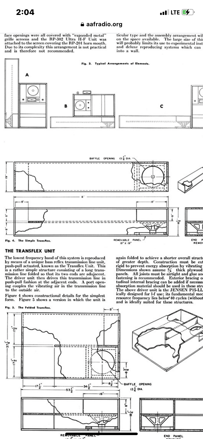

Any luck with the project I’m looking to make a 12” or 15” sundown audio E v4 or SA v2 in a tappped horn for outside movie nights and for some parties I probably would go for the SA v2 12 or 15 but I don’t have any tapped horn plans and don’t know how to get a plan im not grate with computers can any one please help thank you
simple potential idea:
Fold up a TL shape using the drivers ‘Sd’ (510 cm2 or 850) as the crossectional area throughout. If using the 48” (120 cm) dimension on a sheet of plywood the 1/4 wavelength Fb will be about 36 hz.
the second resonance will be at about 108 hz and then a deep cancelation notch thereafter Will end the bandwidth and make crossover easy?
