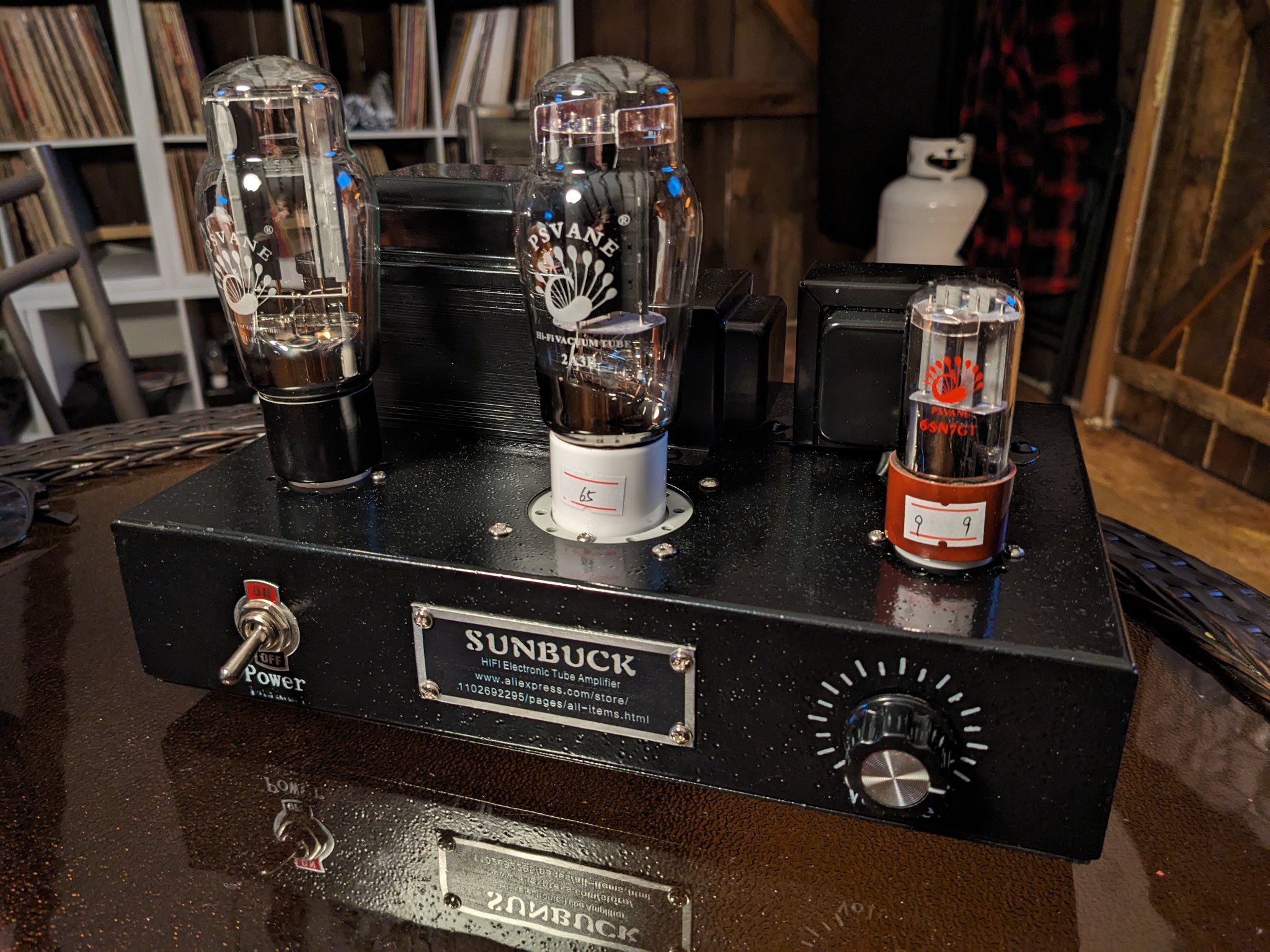

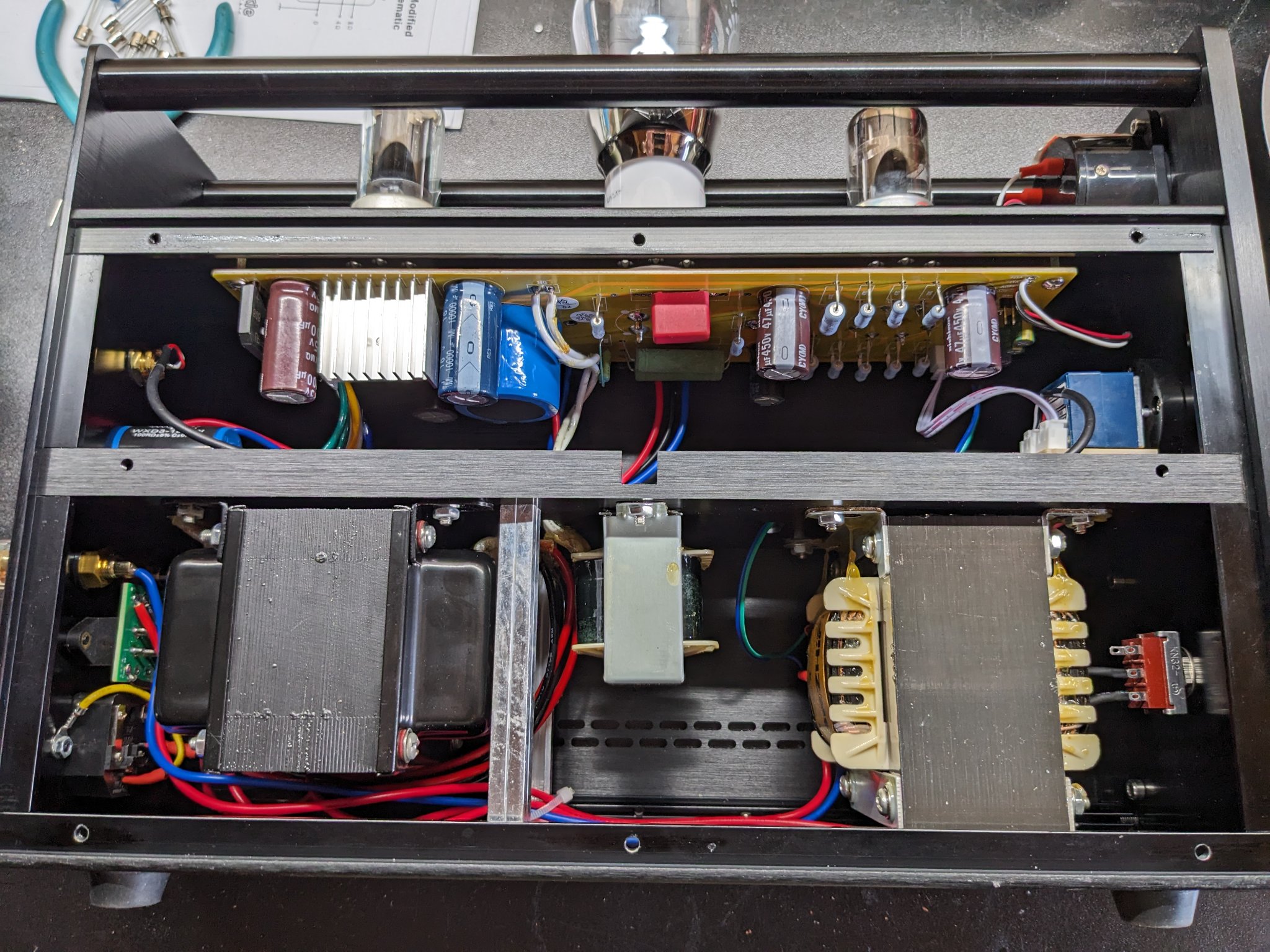

The output transformers seem tiny but these are 3.5 watt amplifiers and I'm just using them for the tweeters so I can't imagine that I'm anywhere near saturating them. They seem quite well put together and are in the same cabinets as the Wright Mono 8 amps that I have, but these guys are nicely ventilated. They couldn't be simpler inside and the solder joints look pretty good.

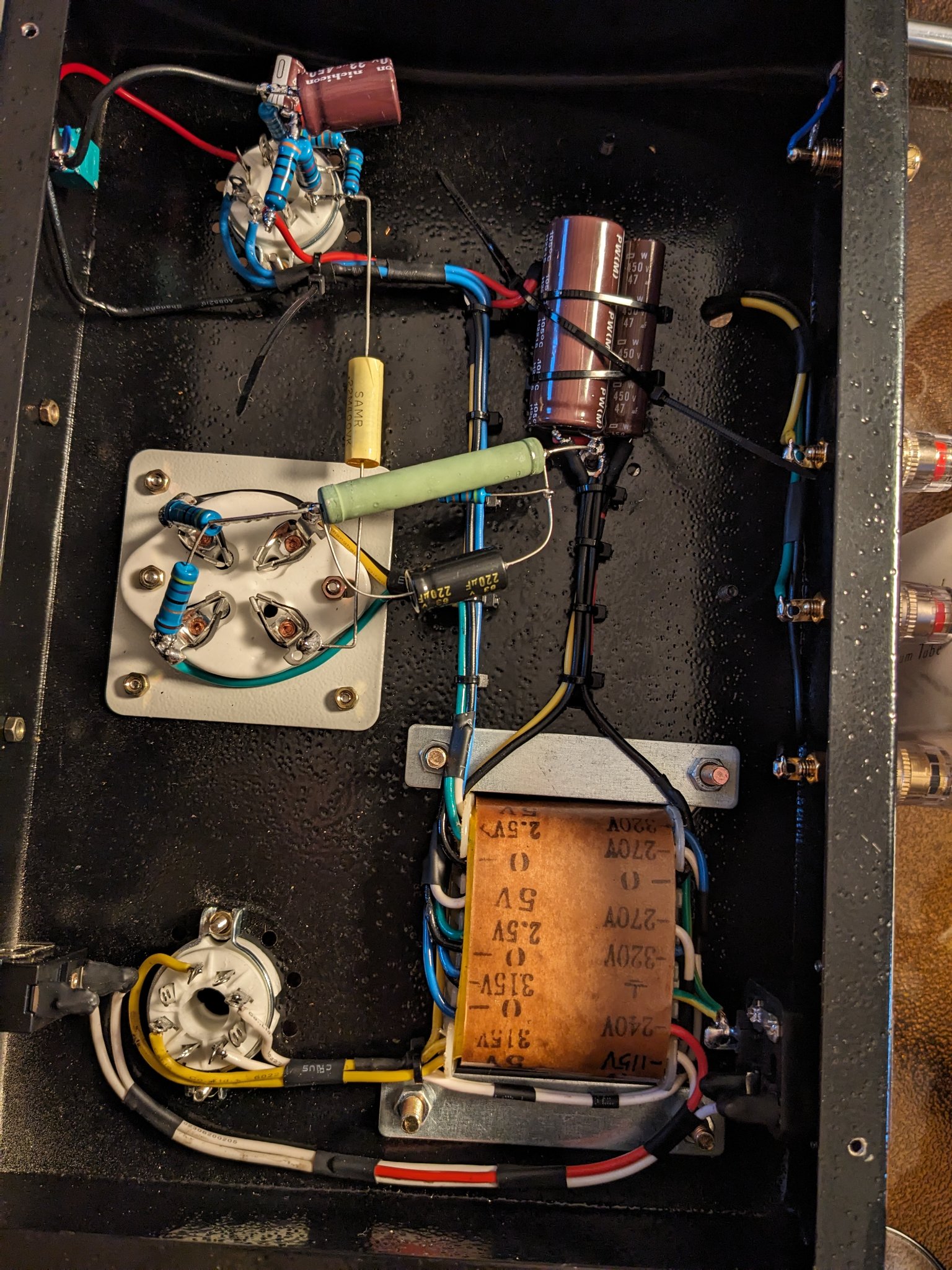

After the first night of listening I had decided that they are going to work well. I replaced the SAMR polypropylene coupling capacitors with some AuriCaps that I had on hand and now with 50 hours or so on them I'm very happy.

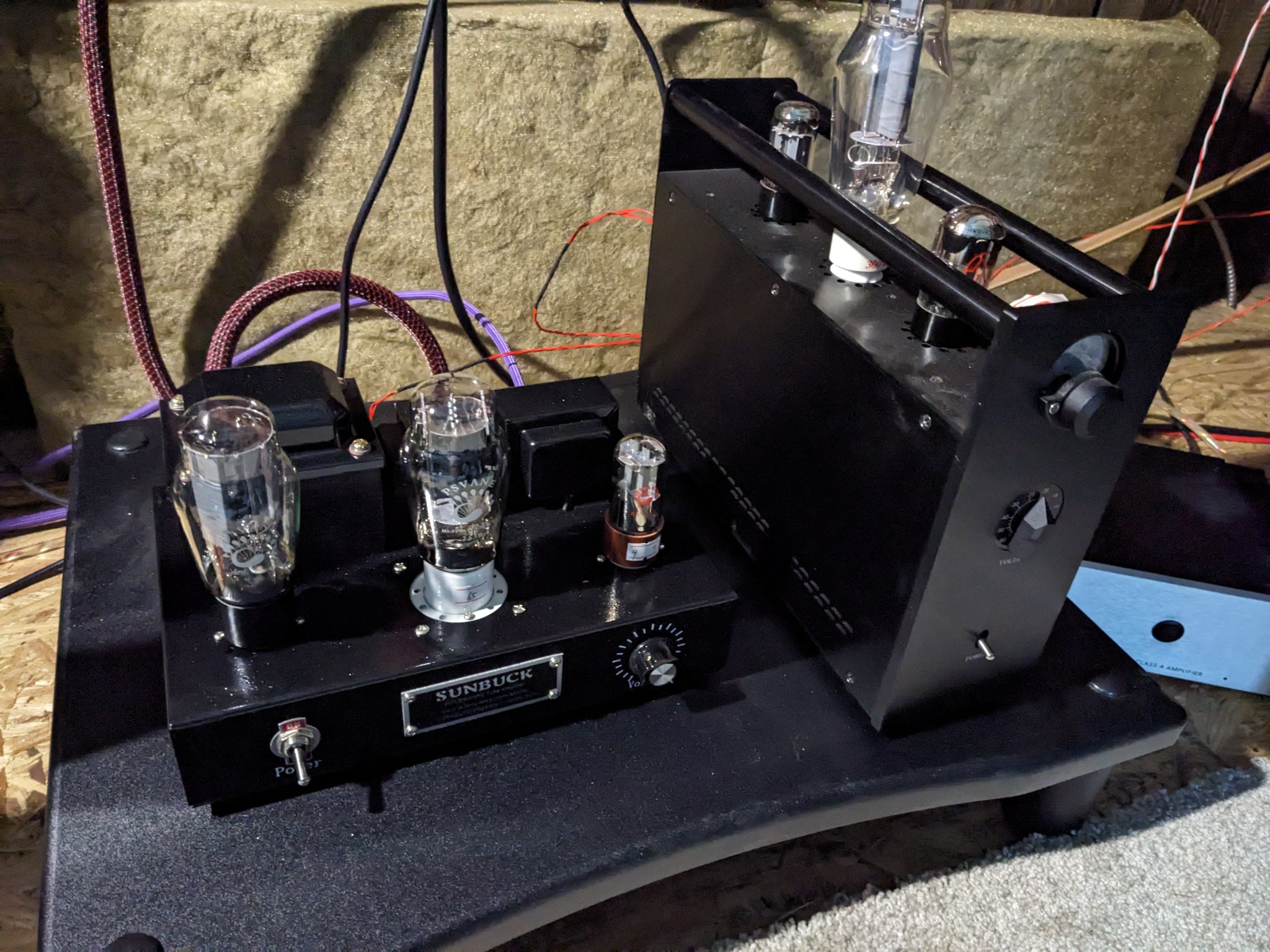

I had been using a pair of ACA amps as bridged monoblocks for the tweeter horns and these new 2A3 amps are a nice step in the right direction. They are more 3D and sweeter sounding but still a bit closed-in on top. As the tubes settle in the top octave is opening up nicely.
I got Chinese 300B amps last year with $150 worth of tubes included and they only came alive when I put in better tubes. I thought that I would need to get better 2A3s but at this point I'm not sure, the included tubes sound pretty wonderful.
