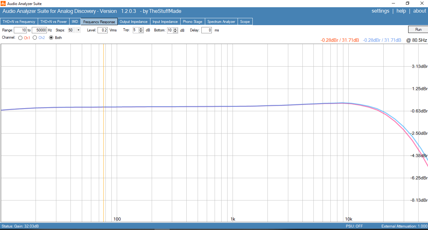

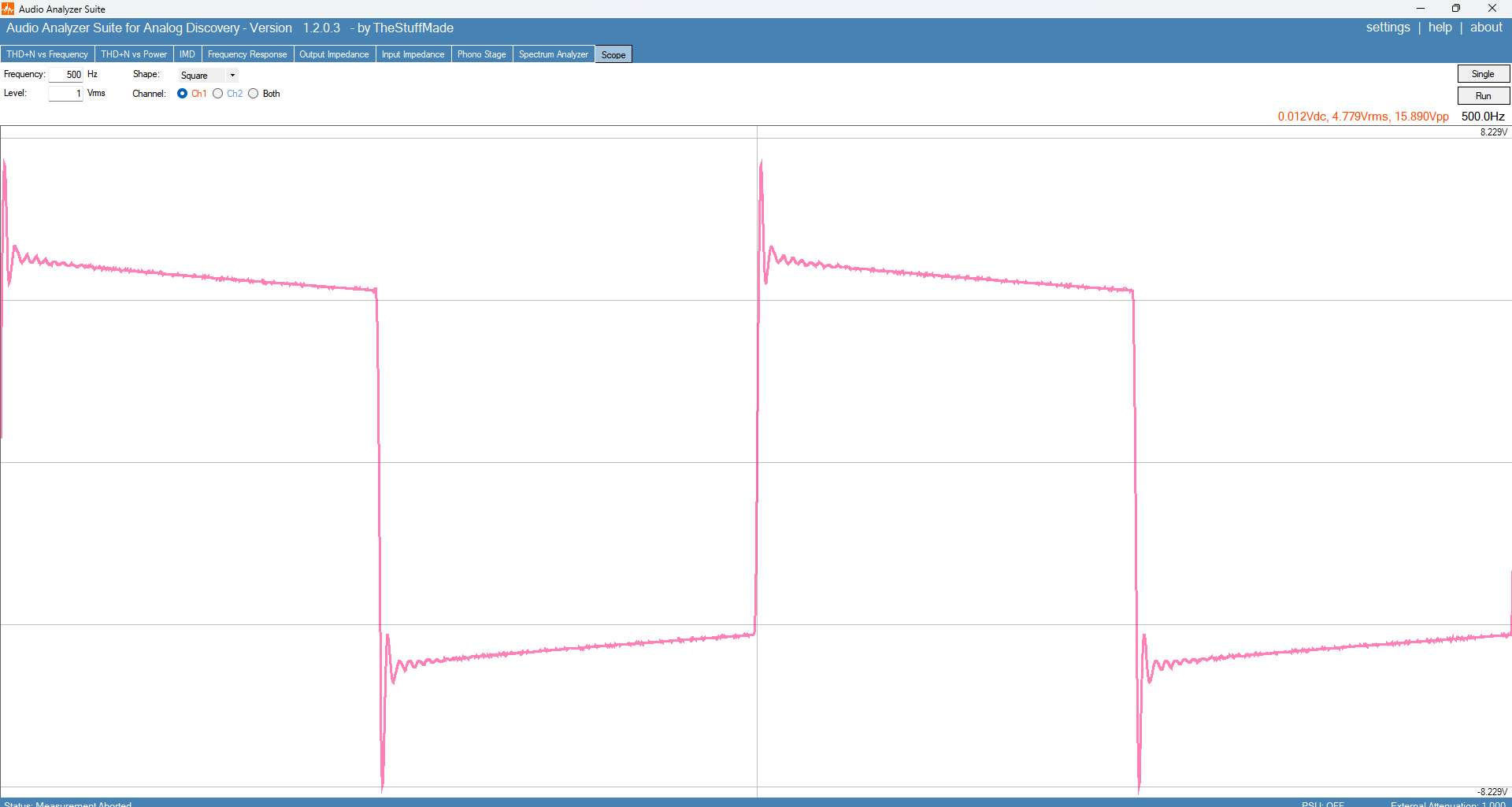

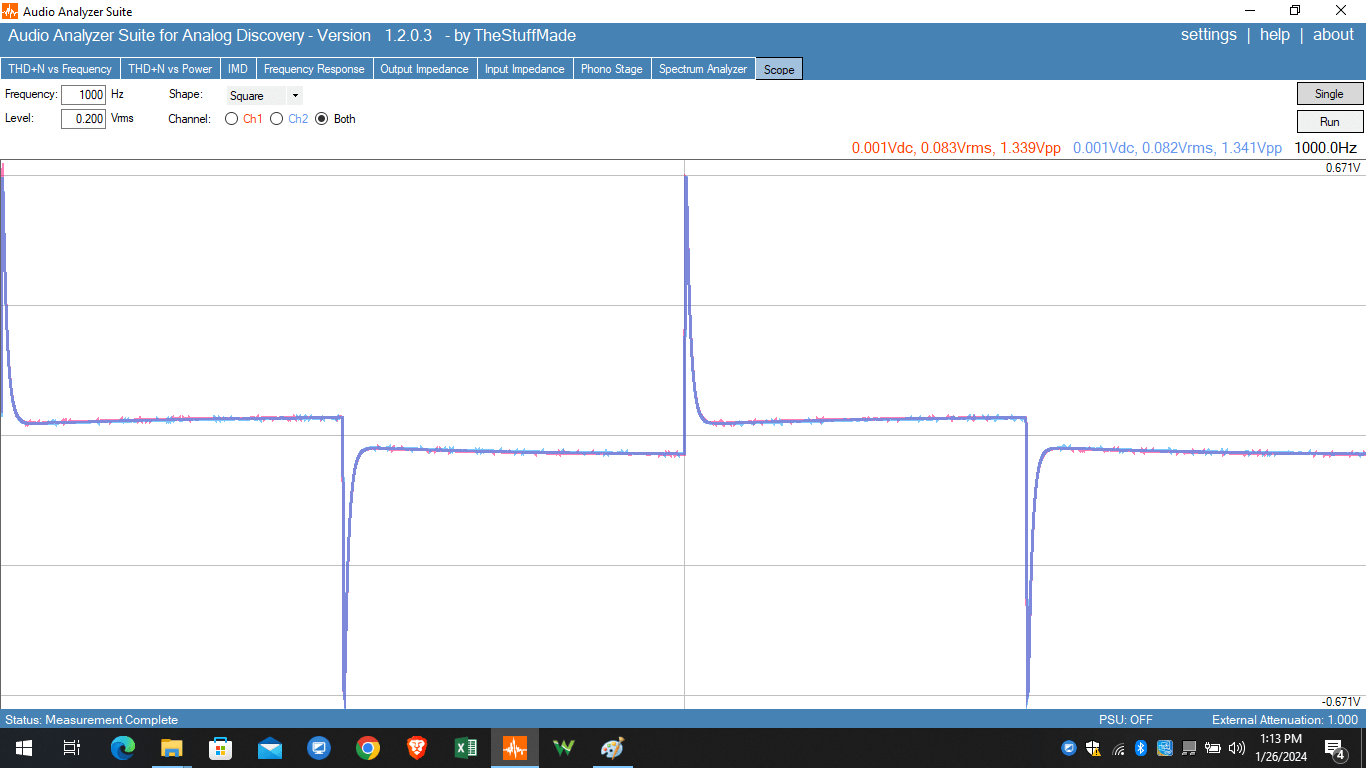

Sun Audio SV-300B PP - Overshoot on square wave test
Leave it alone or at least test it with sine waves, IMD, distortion, etc. Square wave testing is quite irrelevant, especially with no-feedback designs.

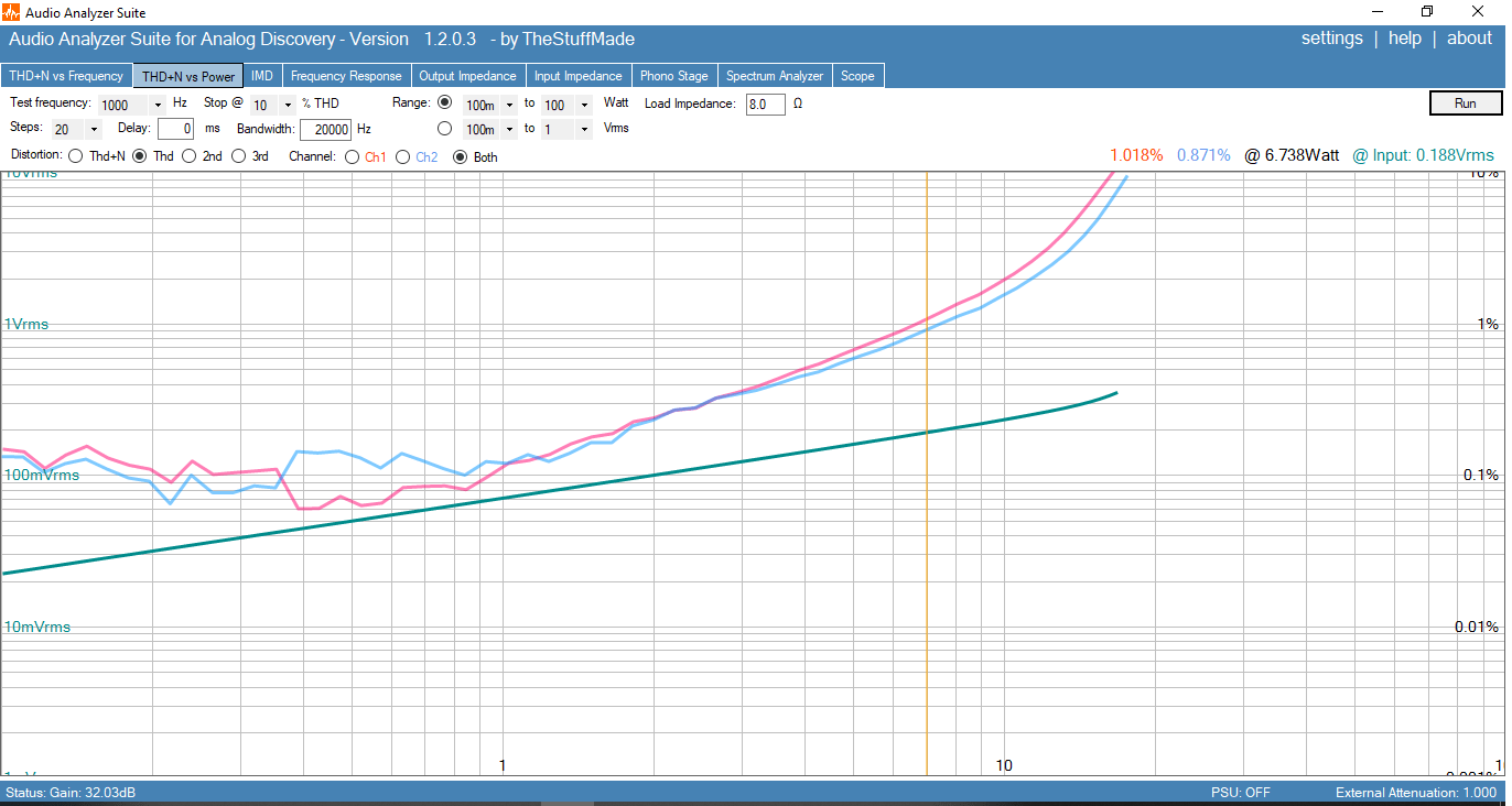

Thank you. On the other tests it seems to perform well indeed. I was just exploring the various tests on this new tool. I had seen an example of a valve amplifier performing a near-perfect square wave reproduction on this test, so assumed it was possible, but if this topology is inherently going to always behave this way and that's realistically not going to affect my musical enjoyment then I'll concentrate my energies elsewhere 👍 🙂
You do realize you are intentionally trying to further reduce the bandwidth (frequency response) of the amp because you don't like the look of a square wave (which you will not find in music)?
You should be aware that any square wave irregularity can be observed for the sinus wave also ... in this case a peak at about 35KHz , preatty big by the look of the overshoot . You can accept any crap outside audio band , or not , your choice .

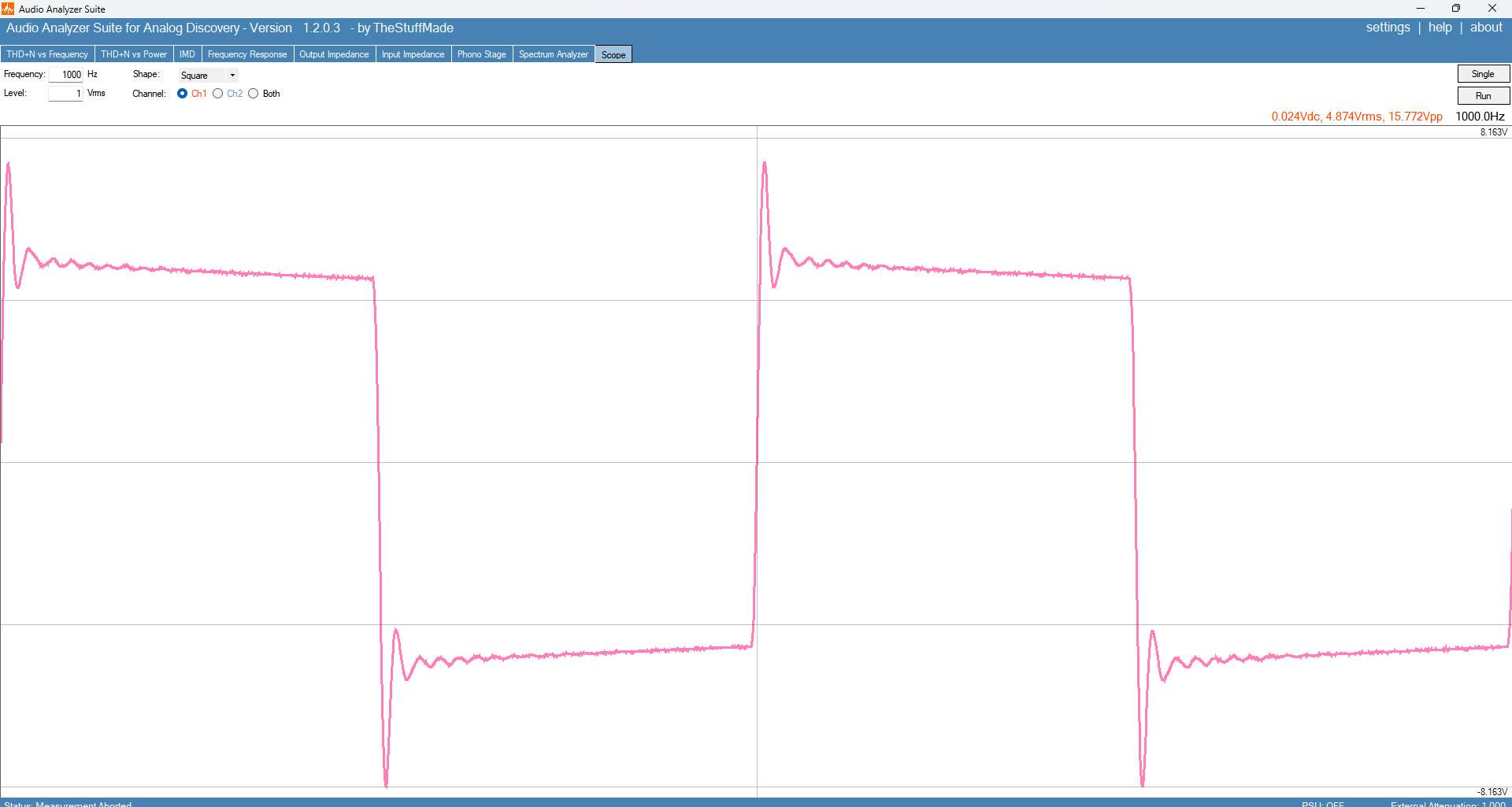

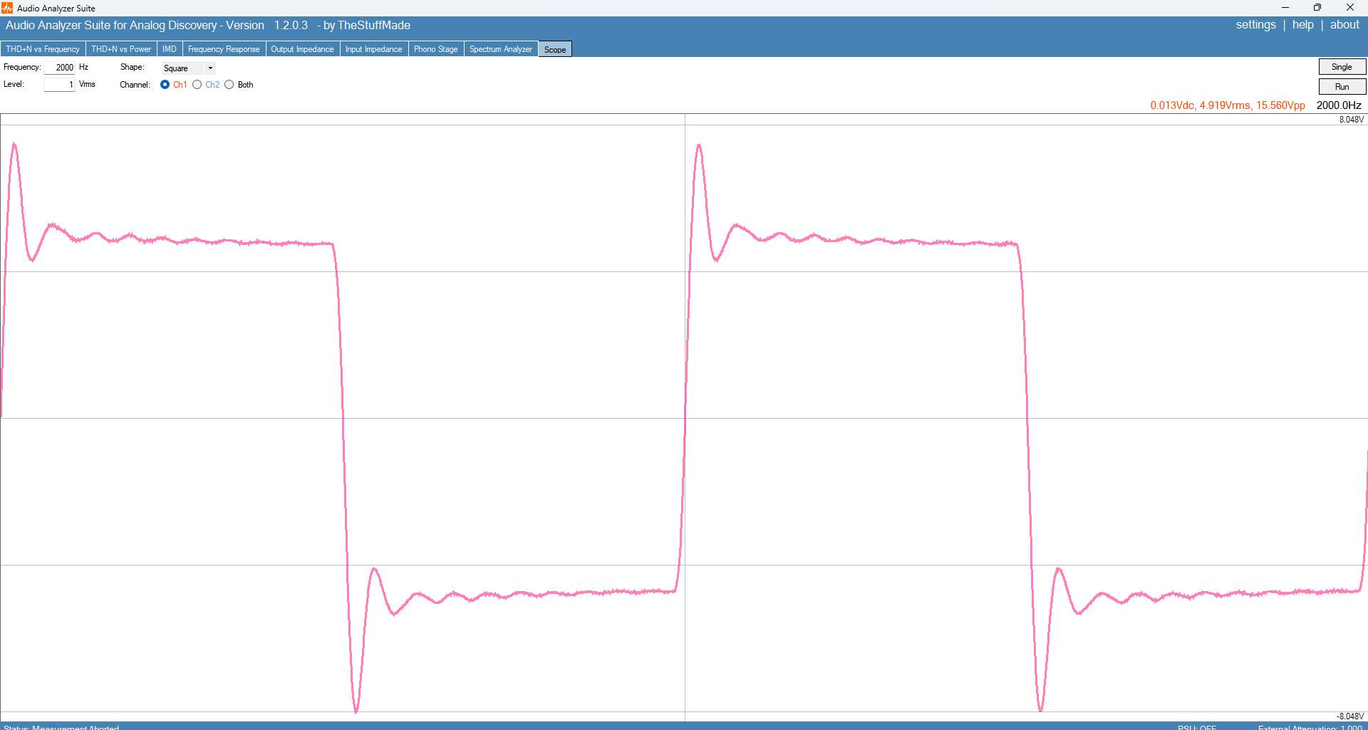

Resoldered a few spot that fixed 1/2 the problem. Still ringing at the left edge. What is the voltage rating for the cap at the NFB? Currently I am using 50v for testing.
After saw what dwjames did with grid stopper resistor, I realized I needed to try the vol. pot. up/down to find where it could stop ringing at the left edge. However, it didn't work out and the pot best is at 75% and below. As 6A3sUMMER's mention about NFB, so I kept adding 20pf at a time until 480pf. But at this value, the Frequency response is cut off a lot at 20Khz which I don't know it's good or bad. 1000pf looked perfect but frequency response cut off at 10khz so i guess it's not good.
The red channel is the one I am working on
Here are 3 that I think is good enough, Which one should I need?
1. Less frequency response cut off but still ringing at the bottom left.
2. More frequency response cut off at 20Khz but not sure if it's ok.
3. More frequency response cut off at 20Khz and no more ringing.

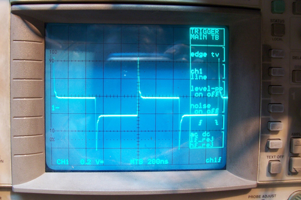

There's another way to approach that ringing. Restore C1 to it's original value. Now look at C4 and R7. These make up a low-pass filter, or "step-filter" as it is sometimes called. This is a standard feature in amps with global feedback. Try increasing C4 to 200pF and see if that reduces the ringing. The "step" filter actually limits the HF response. C1, or the "phase lead" cap in the feedback loop, is more intended to target a specific phase issue in the output transformer, than it is to limit the overall frequency response.
The next step is to check for stability. You can do that by dabbing a .1uF cap across the test load resistor and see if a 10kHz square wave holds up or collapses. If the amp goes into oscillation you will see it immediately.
Look at this Williamson schematic I developed (with some help!). You see a fairly steep low-pass filter in the front (around 40kHz) but a very light phase-lead cap across the feedback resistor. The amp is very stable and the bandwidth is flat well past 20kHz.
I bring up stability because a stable feedback amp will sound much better than one that flirts with oscillation.

Just coming back to this as I literally do find square waves in the music that I make and listen to. I'm sure for someone who only listens to classical and acoustic recordings this is true, but a lot of electronic music intentionally has all sorts of simple and complex waveforms going on.
I guess it's likely not an issue for my ears regardless, but it bothers me that this overshoot represents unwanted extra high frequency energy which my power stage and speakers are being asked to amplify and reproduce and that seems like a negative thing.
Would it be such a bad thing to snub/low pass this transformer secondary at 30khz for example, which should be totally out of the way of any valid red book musical signal?
Also, one test I didn't do with the scope was to see how things looked if I only applied the input signal to one half of the 6SN7. It really looks to me like this flick could be a phase issue with combining 2 waveforms with slightly different timings.
Sorry, but you 'literally' do not find square waves in your music. Play a square wave from your CD player and see what you get. It can't do it.
Overshoot is not "unwanted extra high frequency energy" - it is the absence of higher order harmonics from an infinitely fast rising/falling edge. Your CD player will exhibit what you perceive as nasty overshoot - you believe red book is putting out extra high frequency energy??? Then why the overshoot from your CD player? Start to understand this concept and you will start to understand what your amp is doing.
Or you can band aid a perceived problem by intentionally limiting bandwidth. It would not surprise me in the least that your brain will tell you it sounds better when the square wave is pretty.
And please, this thread needs to isolate the issue to an amp without negative feedback.

I think there's some confusion here about the difference between Gibb's Phenomenon (shown in post #48) and square-wave testing with a wide-bandwidth signal. Yes, CD players produce square waves like the one in #48 and that is indicative of the limited frequency response. But we test amplifiers with a wide-bandwidth signal in order to determine the amplifier's actual behavior. In that case, leading edge overshoot does indicate an excess of HF information, and ringing indicates resonances and/or phase shifts in the highs that can lead to oscillation. You can easily see this by running a Bode plot analysis.
Here's a 10kHz square wave and Bode plot for my Williamson amplifiers with 20dB feedback. First, a "standard" Williamson step filter of 4.7K ohms in series with 200pF capacitor, or about a 100kHz low-pass, with a phase-lead cap of around 150pF. Stability is not too good:
Here's the same amp with a much steeper step filter at the input, about 40kHz. There's still some rise at the leading edge but no ringing. This version is much more stable into a partially capacitive load. The HF resonance points are still there (needs better tuning!) but are pushed much further down.

I got the idea and figured out the best with your help.
grovergardner
I will try your suggestion later and don't want to hijack dwjames's thread too much. So far, it's working great now.
