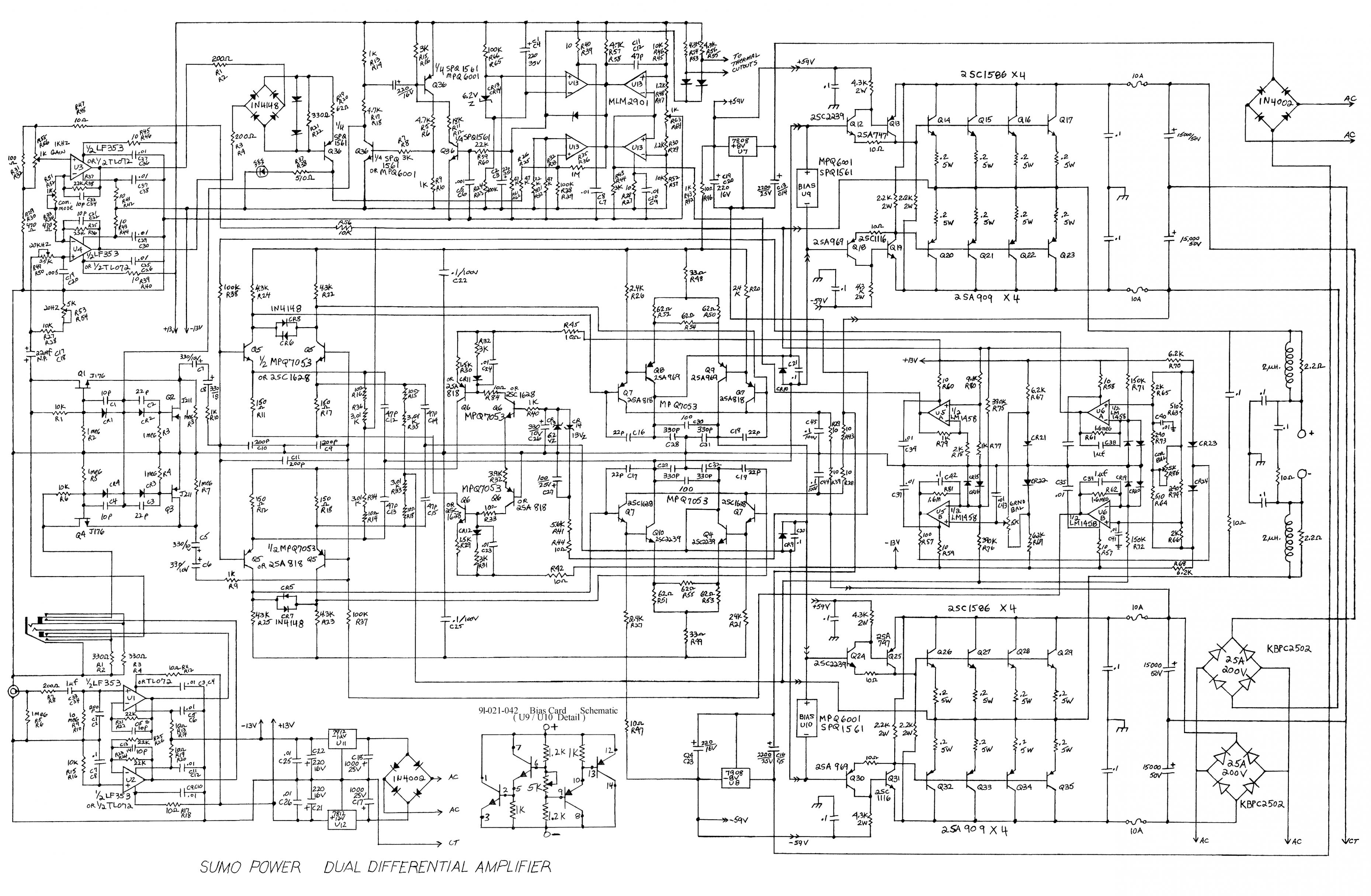

Sumo The Power Schematic
I worked on one of these once. Huge pain in the rear. Massively heavy, built monaco <sp> style. the entire chassis is built around the HUGE power transformer. Each channel is a pair of amps in bridged mode with lots of complicated servo circuits etc.
When it worked, it worked great, tons of power, but when it blew, i took out a pair of brand new JBL 15" woofers POOF! what a waste..
Best of luck, i never was able to find a schematic way back when.

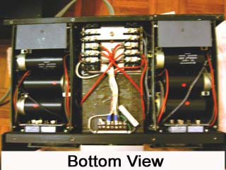

I rebuilt one of these about a year and a half ago. It sounds
like yours has the same problem as mine did...full DC on one channel. Measure it with a DVM on the outputs. It will be about 100vDC. The designer of this amplifier is James Bongiorno. You can contact him via the Yahoo group "SAE_Talk. If you search that forum you'll find many posts about the Power. (Many of them mine). James will not give out the schematics ( if anybody HAS one, I'd be willing to pay $100 for it). The other posts here are correct: It is a monocoque construction. The op-amps can be upgraded and topics on SAE-Talk cover this. Each channel is a pair of amps in bridged mode with lots of complicated servo circuits. The "transformer growl" you hear is from the full DC on one channel. Mine did it too.
Essentially what you can do to start is this: If you have one good channel, use it as a reference and compare the voltages to the bad channel. Start at the power supply and move outward. The design is fairly straight forward until you get to the servo boards. These are the boards that sit on top of the heatsinks on each channel.
I found this amplifier to be excellent sounding, even better than "The Nine" (another Sumo design) and MUCH BETTER than an Adcom 555 II. It is now in my main system. Good Luck

sumo the power... the schematic has gone!
Hi every one! just an update: Some years ago I sold the amplifier to somebody in to the States I sent the schematics too! and for my misfortune the copy I got prior to ship the amplifier, got lost after moving home. Sorry.
However , seems like everyone faces the same problem. DC voltage at the output terminal, sometimes it is intermittent, and when it apears of course it comes accompanied by a good barbecue of Speakers!
Well in my case a pair of early collective Altec Lansing 605 speakers were burnt out!😡 my big mistake, never should connect them to this amplifier , a 15 watts amplifier would be enough back then!
So, I found the problem were related with the CLAMPS of the AC on transformer. The were dirty and from my humble point of view, a real cause of a potential failure, -no complex FMEAS were used back then-. In my advise remove the clamps and solder the wires to the board , that's how I solved the problem. In the other hand , I took the opportunty to upgrade the amplifer replacing the OP amps for a better ones, options are: NE5532, TLE2082 (not suitable for all sections due BiFet technology), LM4562 (the one I used to improve it) Nowadays the are a lot of OP amps very suitable for upgrade like ADs, LMEs, TLEs, OPAs, LTs and so on. Change the signal and decoupling electrolitics for OSCON and Nichicon audio grade, believe me the final result kicks all super mega buck amplifers into the market!! Good luck!! cheers!!

I just received my second "THE POWER" last week which came in three seperate boxes as the seller didn't want hurt his back trying to ship it in one piece. He had wanted to part it out but I was able to get all of it before he had a chance to sell any of it. This was "Computeruser's" amp at one time.
Everybody familiar with this amp knows about the intermittent problem with DC on the speaker terminals. Mtubes seems to think he figured it out by removing the "CLAMPS" and soldering the wires directly to the board. The "CLAMPS" I am assuming are the quick disconnects on the low current power supply board, correct? The high current connections are by barrier strip. The other problem described by Computeruser are the intermittent/bad TO-66 collector connections, basically Pem Nuts, on the one of the drive boards.
In checking out this new one I found a piece of wire insulation in the connector that supplies +12VDC to the right drive board. This +12VDC supplies power to the DC Servo opamps so maybe that's the problem with the one. We'll see.
My first one works OK but occasionally pops the 10A fuses on the output boards, in fact they were blown when I received it. It's tried to blow up the woofers in my Dynaudio speakers but they are pretty tough drivers.
