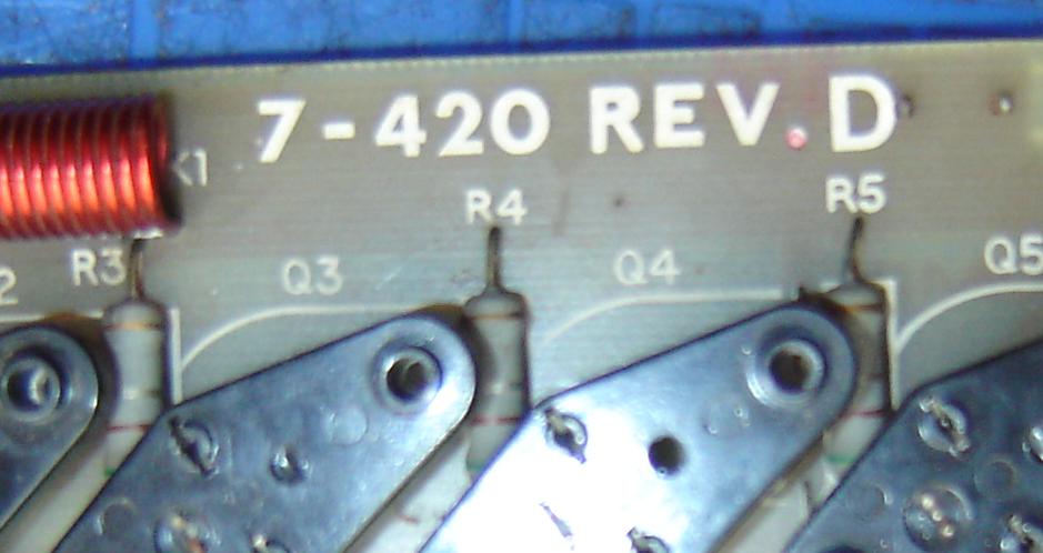

IN MY "SUMO NINE" have 9 Q. Three mpsu55, Two Tip31c, i don't know the last four. Thank for any imformation of it
(7-420 REV.D)
(7-420 REV.D)

hi
thank for reply
It have 2 devices 'Tip31C' and 3 devices 'Mpsu55,MPSu56'
( the same nine plus rev.C )
and "last four devices ?" I can't to define
I will take photograph soon
bye

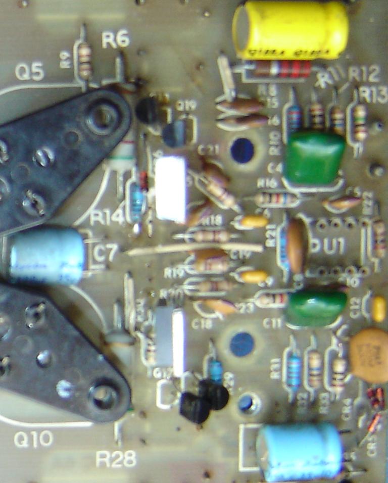

Hi Odysseyvn, All
thanks for the pics.
I do not see the op-amp in your board (I see only the
little holes). May be the four devices are a discrete
replacement of the LF412.
If so, I am very curious about how your Amp sounds.
And, I admit it, I am also a little envious.
Try asking to J.Bongiorno in the SAE_Talk forum.

Hi fscarpa58
thank you
No, it have LF412, I will replace by 'BB OPA2134'
This AMP sound very impression

odysseyvn said:Here is it'picture. Q16,Q17,Q18,Q19 near Tip31C
can any one give the name or the part of four devices
thank for all advice
You have the board, odysseyvn.
why don't you trace down the schematic of your unit?
I did it last year with my unit as you certainly have seen
on the thread. It is a long job but, with a little patience and
the aid of my schematic, you can give us all a great piece of info.
