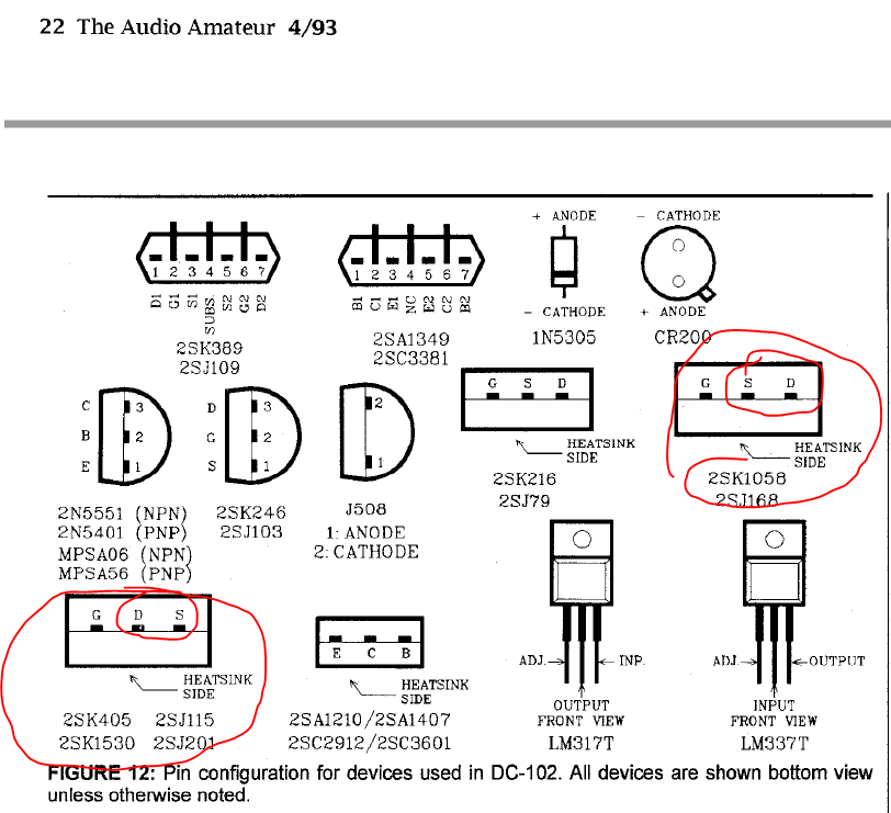

Do not try to change Hitachi's for Toshiba's...Hitachi's are lateral mosfets, Toshiba's are vertical mosfets - totally different devices and you will be not able to bias them properly.
But there is the light...you can buy proper lateral mosfets from Profusion ECX10N20/ECX10P20 see Lateral MOSFETs | Profusion

Hmmm...we are both wrong...😱Hitachi's are vertical mosfet (I did not pay enough attention to the Id vs Vgs graph for 2SJ115, from a distance they seems to have zero temco at about 100mA similar to the other laterals, but here it is 1000mA (1A) not 100mA as I thought in the first instance. Similar Id vs Vgs graph from 2SK405 datasheet (zero tempco about 4A) confirms that it is a vertical mosfet.
Hitachi's and Toshiba's have the same pinout G D S, they are the same type of mosfet (verticals) so they can replace each other with careful biasing.

Toshiba ONLY made verticals.
Hitachi made both laterals AND verticals.
Hitachi verticals were not (often) used in audio amps (at least that I've been able to identify).
Hitachi laterals have a different pinout from Hitachi verticals/Toshiba verticals. See attached picture of pinouts from old Borbely amp project.
I assume (i know, i know, my mistake 🙂 ) that when someone mentions Hitachi MOSFETs in regards to audio, they are referring to lateral technology.
Laterals and verticals are not (easily) interchangeable.
That's the warning I want to express.
