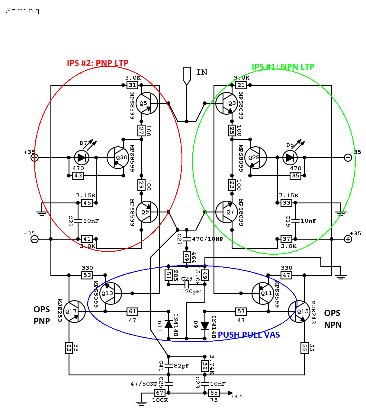

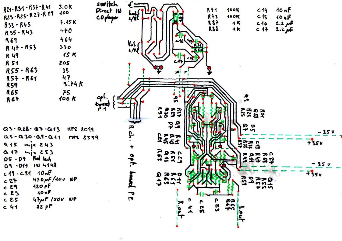

finding no diagram online, I copied one channel of my preamp.

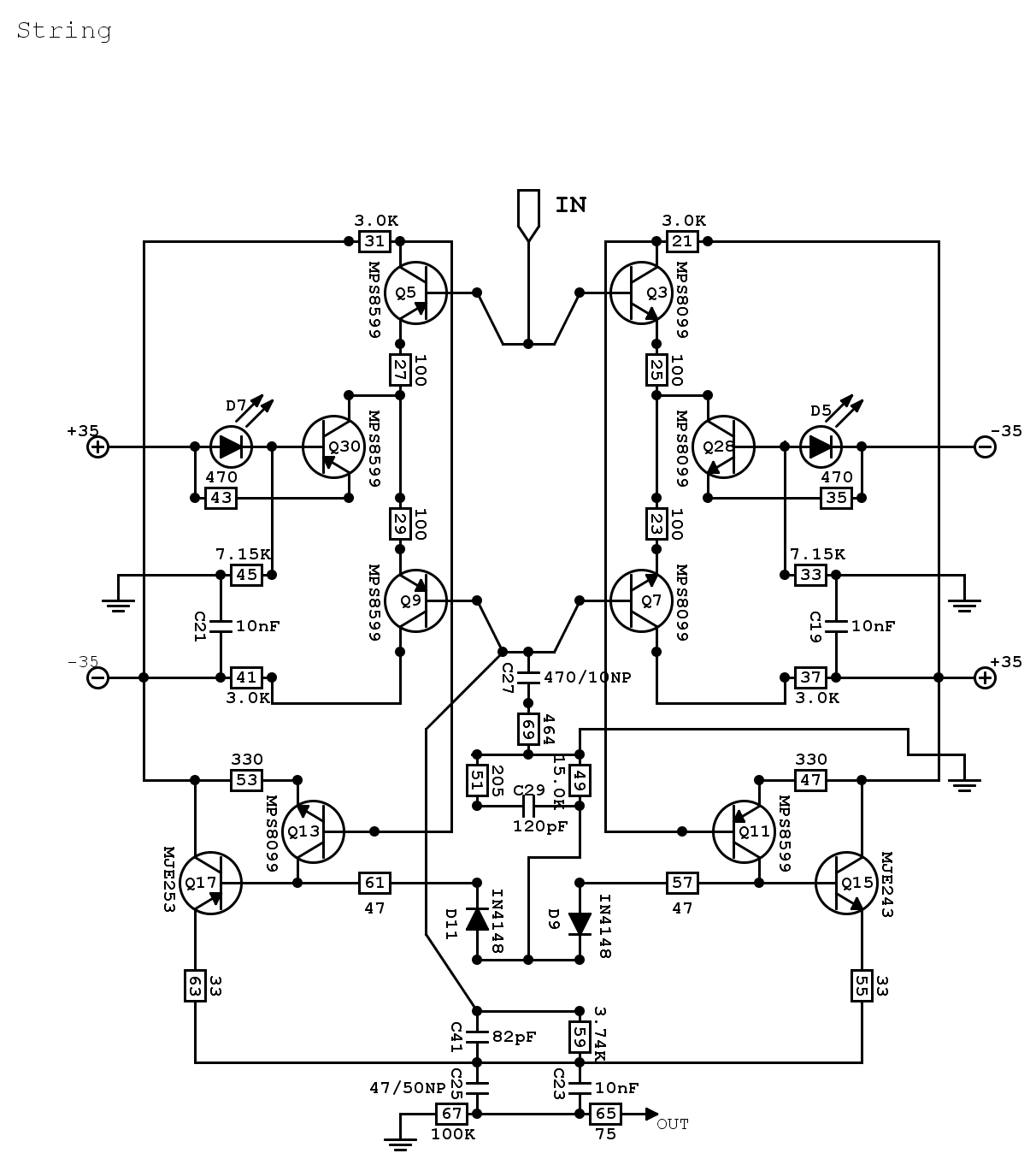

See this beautiful drawing, and schema (my first, done with software:drink:), although this is not the diy, it could be.
Where are the :king: of electronics?
Please tell me if the modification is possible.

I don't see an easy way to get fully differential outputs "at the same time" (second to last paragraph in the owner's manual page) using fewer than 10 additional transistors. You'll need to build one NFB loop incorporating the positive output, and another NFB loop incorporating the negative output.
The obvious way to get two NFB loops is to build two of these Sumo 10-transistor discrete opamps. The first opamp operates at gain= +9.06 and the second operates at gain= -9.06. (R59 + R69)/R69
Hello transistormarkj,
So from what you say, they would have another board for balanced release.
I thought it was doable with it, anyway, without help, I would not come there, I do not have enough knowledge.
It's very simple, it will remain as it was thought, by the way, it works very well, but rather that my amp has an interface problem.
