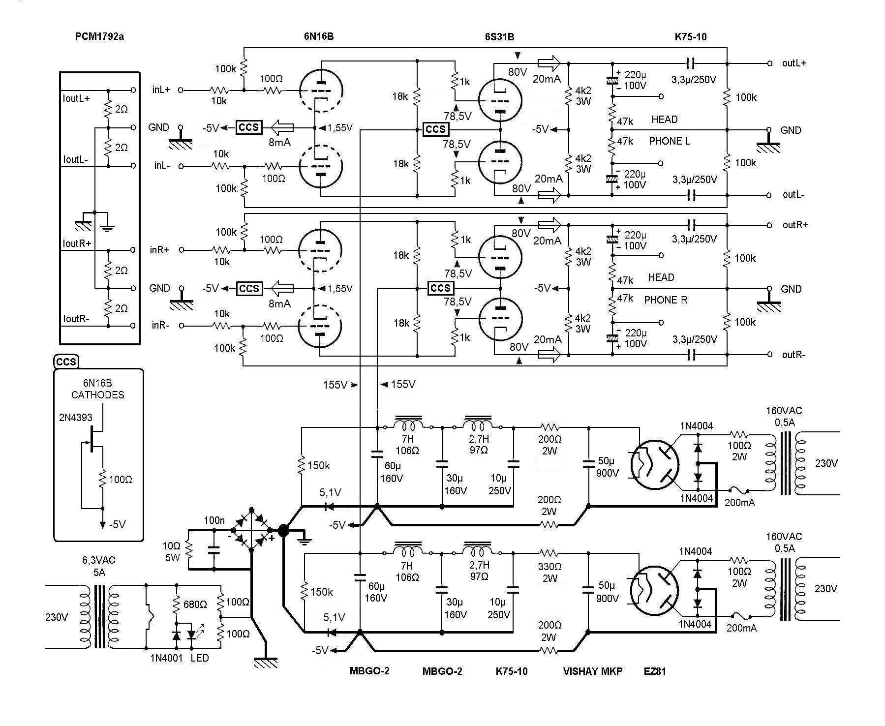

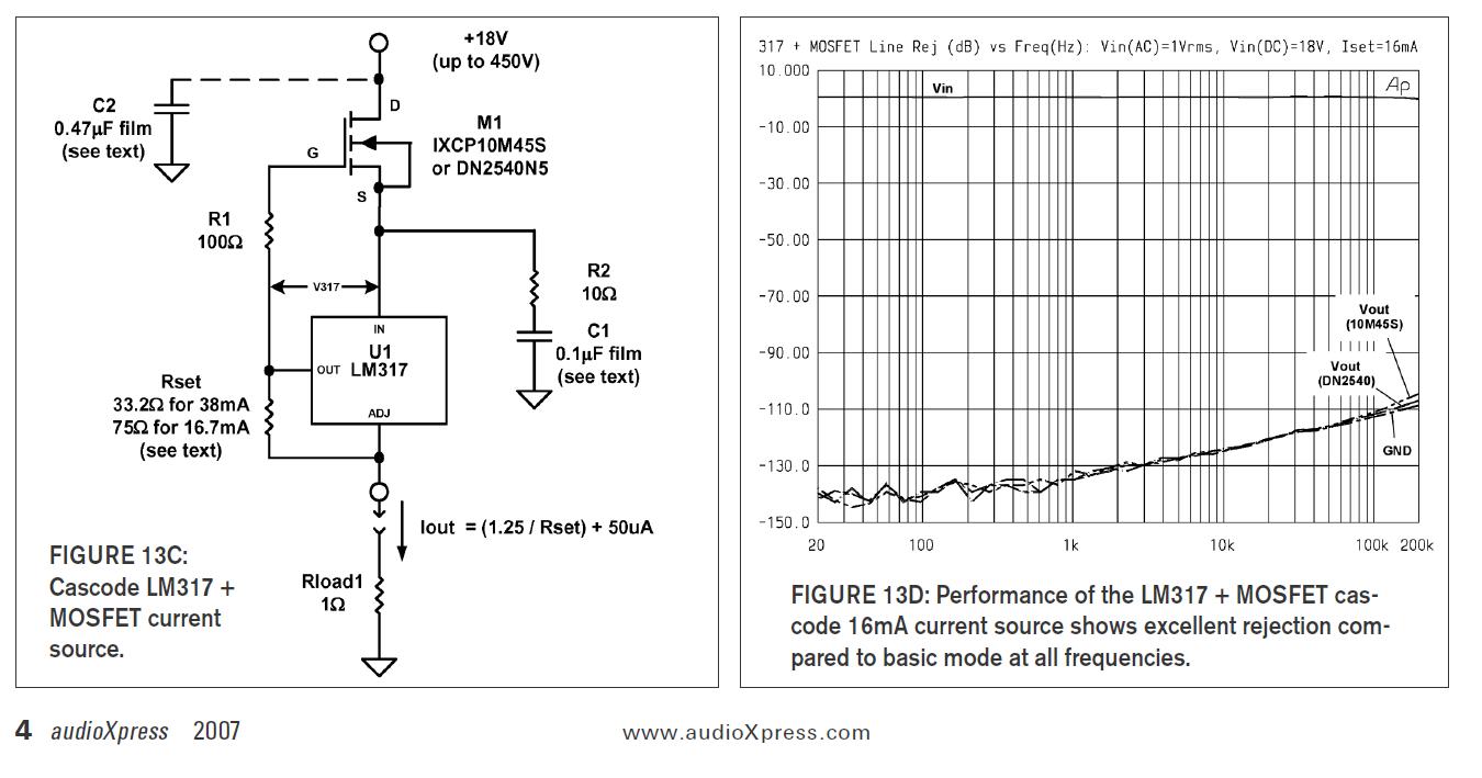

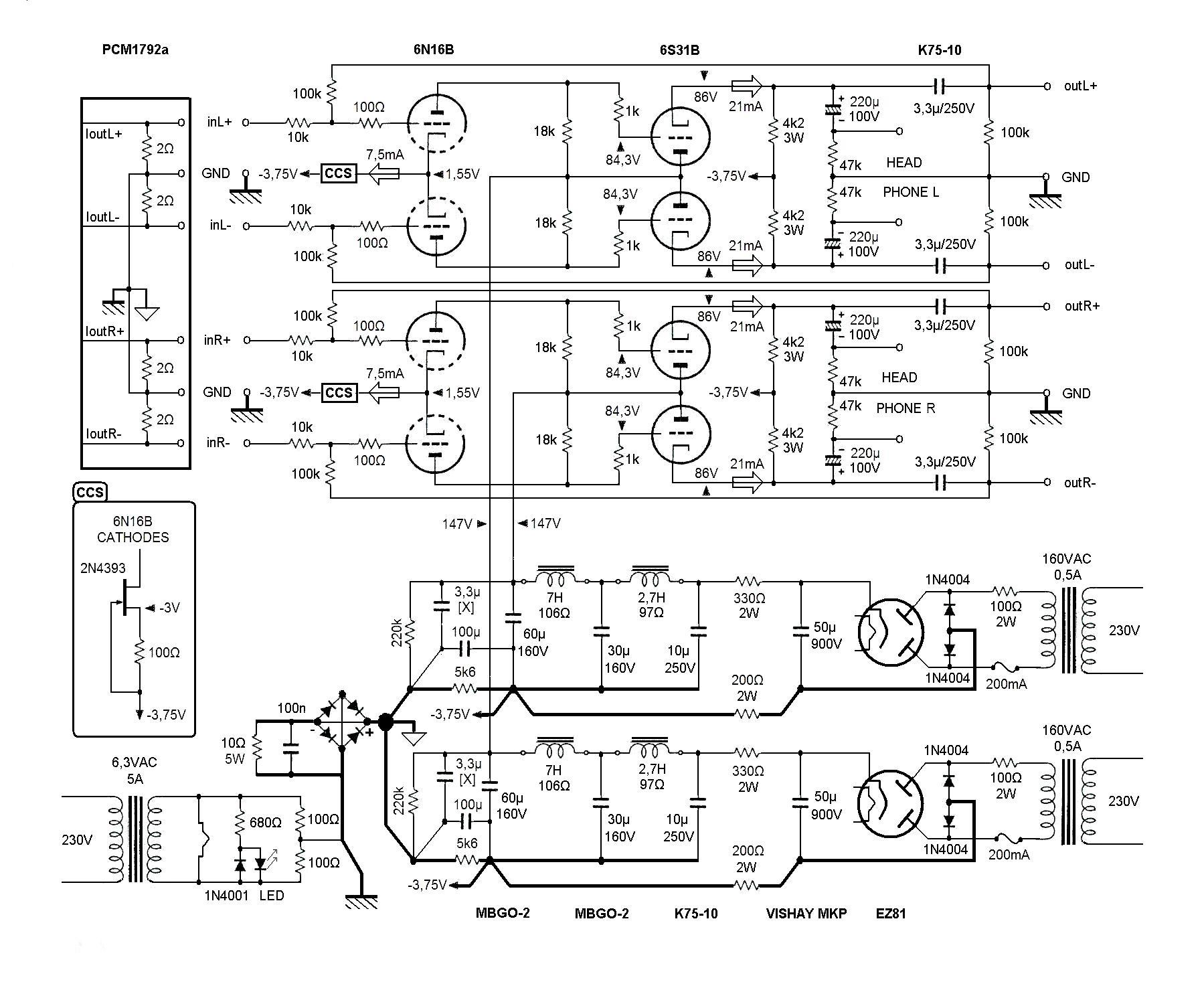

I'll be following this thread as I like pcm1794a and 6n16b. Actually, what I use now is pcm1792a, the software control version, on a asus stx ii sound card. One chip in stereo mode though. I have taken the output directly from the chip via a 2 ohm I/V resistor to feed the tubes grid. First schematic shows the current revision of the tube output stage. Plenty of gain allowed to apply nfb but I think it does breathing oscillation now. I can't measure it. It didn't start like this and have some more ideas for it - second schematic. A CCS on top of the cathode followers - J. Broskie's trick - hopefully will make the buffer stage something like a PP OPT, summing the differential signal while retaining balanced output. Perhaps nfb won't be necessary then. Third schematic shows the CCS I'm planning to use, found here http://waltjung.org/PDFs/Sources_101_P2.pdf

Neat. I was thinking of throwing in some feedback, but the more I look, the more I think I want local loops around each stage. As of right now I'm thinking of just having individual cathode resistors under each cathode on the LTP (on top of the CCS) to reduce gain and give a little more linearity, and then I'll just run it straight to the Heretical buffers. Assuming I use something like 33R I/V resistors, the PCM1794 will give 7.8mA peak with the 10k ref resistor... I should get 0.2574V at each grid, which assuming a gain of 25 max for the 6N16B, will give me 12.5x per triode, which gives 3.2175v peak per phase, 6.435v peak-to-peak/4.5Vrms... I can reduce or raise the value of the I/V resistors as needed to change output level. Assuming the cathode degeneration and real world losses, even if we get that cut in half I'll still be happy. If I add an additional LTP before the buffer I would think that global NFB would be necessary to keep the gain from being excessive...
As it stands right now, I'm looking at (per chip) two differential pairs, and a pair of cathode followers per channel, for three bottles per side. This will give balanced output, and I can always add an RCA jack for each output for single ended use, but I have a spare set of XLR jacks to give it balanced output capability. I have a volume control LCDuino project going too, and I think that I'll put the Edcors in there with a motor pot for both volume control and Balanced to SE signal conversion options.
I'm pencilling in 47R as the max I'd like to use for now, back when had access to nice audio test equipment I found that once you go much higher you start to get a smidge more (But still pretty negligible) THD, but it was still exceedingly low, and not much worse than an opamp implementation would run on my eval board at the time, but all my testing was single chip stereo, so it should be even better going dual mono.

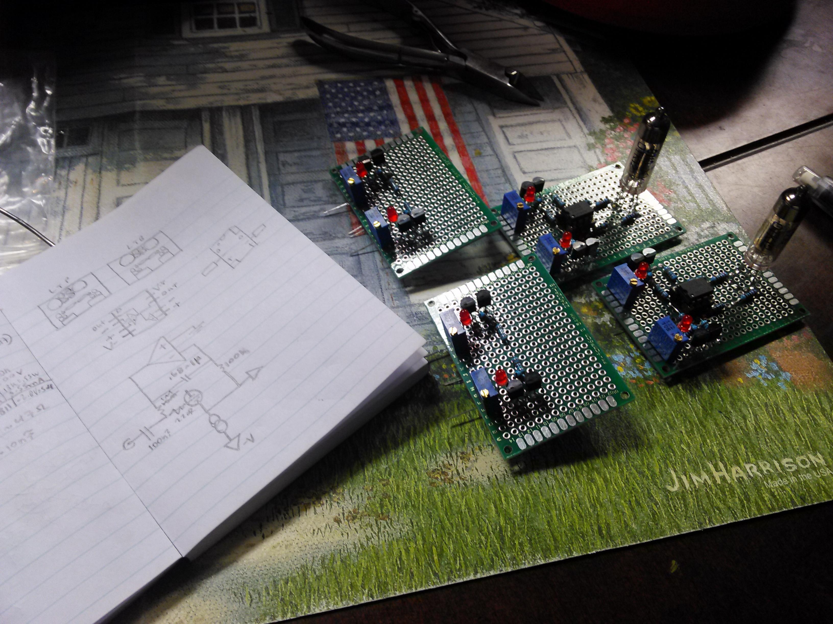

Well, started up on the boards. Doing each pair of LTP/CCS circuits on a single board, and a pair of cathode follower/CCS each on single boards as well, for two boards per channel in addition to the DAC and PSU boards.
attachment.php
Gotta order some more caps and put in headers for off-board connections (PSU, signal) but the buffer modules are pretty much done.
