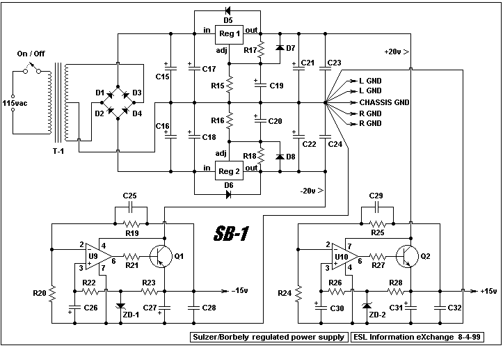

The zeners are 15 volt. 12 volt would work too.
The transistors are anything you want depending on
how much power you need. I think i used tip41 and tip42...
