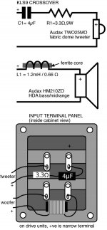

If they are Bi-amped...the capacitors could still cause an issue.
(Bi-amping with a conventional crossover, is next to pointless, and isnt active amplification.)
Replace the capacitors, its pennies to fix.

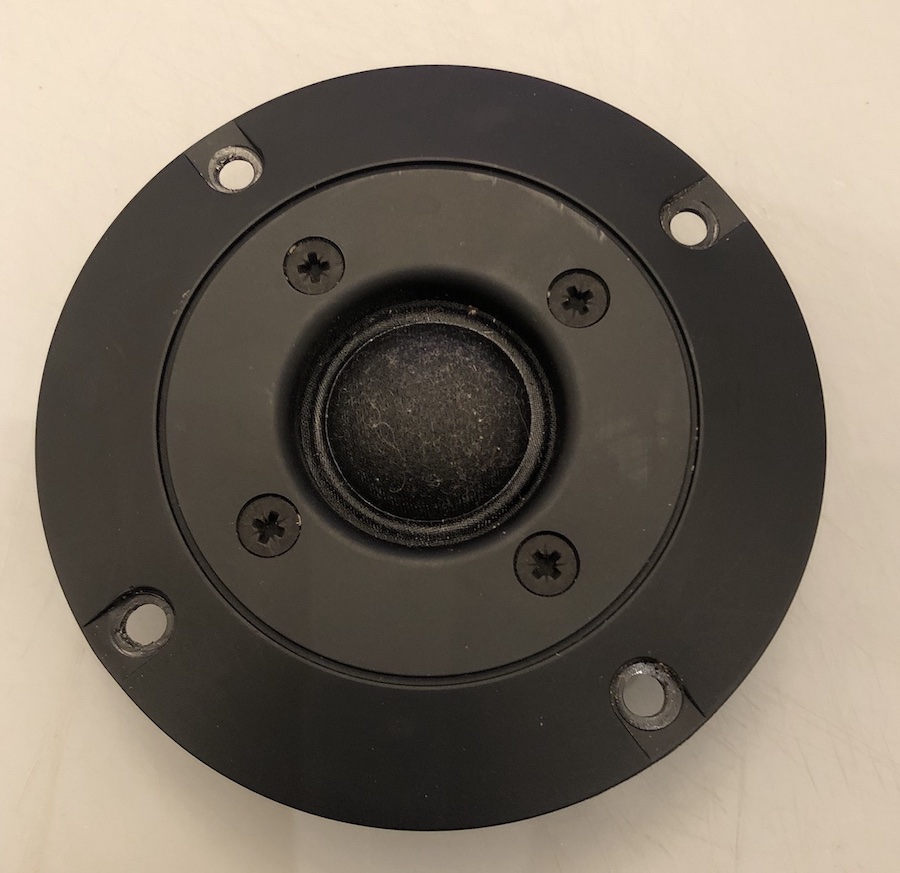

Tweeters have arrived and have been installed. I'll look to dismantle one of the old ones and put photos up if people are interested.
Jonathan
Jonathan
I've just seen your update, Jonathan. Thanks for doing that.
Photos of the dismantling procedure would be useful for future reference, if its not to late to take them!

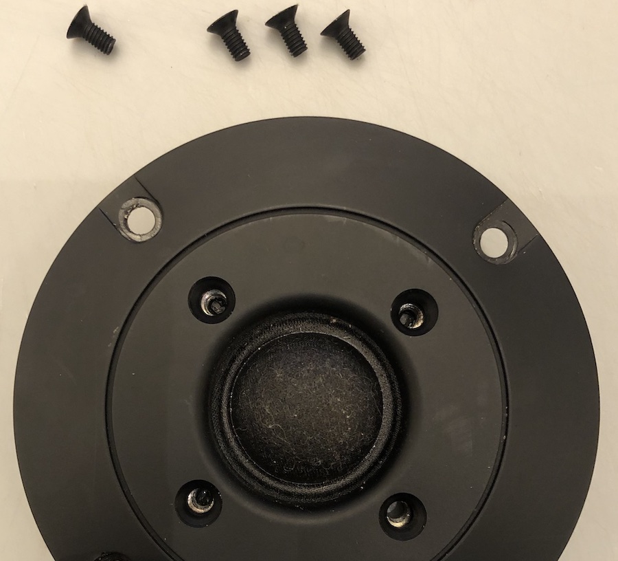

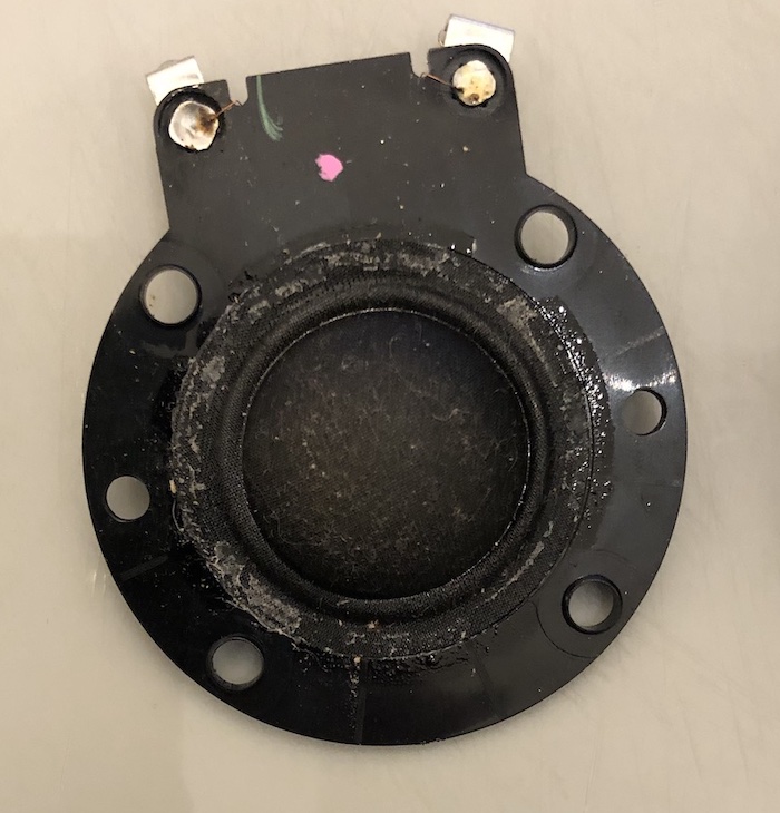

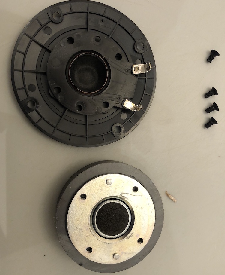

I have now dismantled the dead tweeter. The old one is held together by 4 small Phillips type screws. The new replacement ones that I have ordered and fitted use an Alan bolt.
Having removed the screws, I expected the centre part to come away, but in fact the whole top section separates from the magnet. The voice coil was held to the top section by some mild glue - prised away easily. I could not find anything obviously wrong with the coil, aside from some debris inside.
Reassembly is easy, provided you remember to align the dimples on the top of the magnet with the holes on the reverse of the coil mount.
Hope this helps someone in the future.
Jonathan
