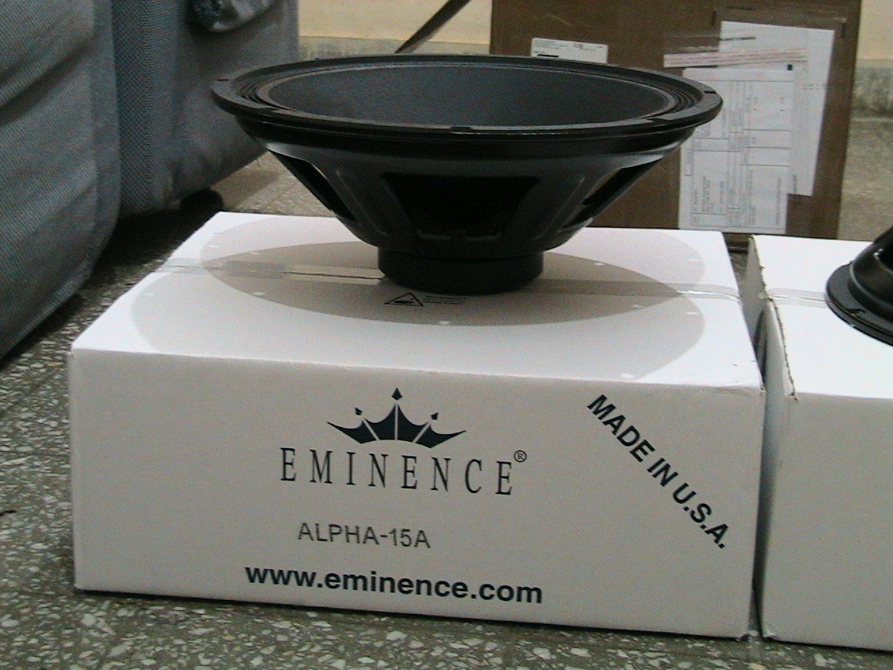

I received the Eminence alpha 15a yesterday in excellent condition. The
replaced Fostex is on its way.

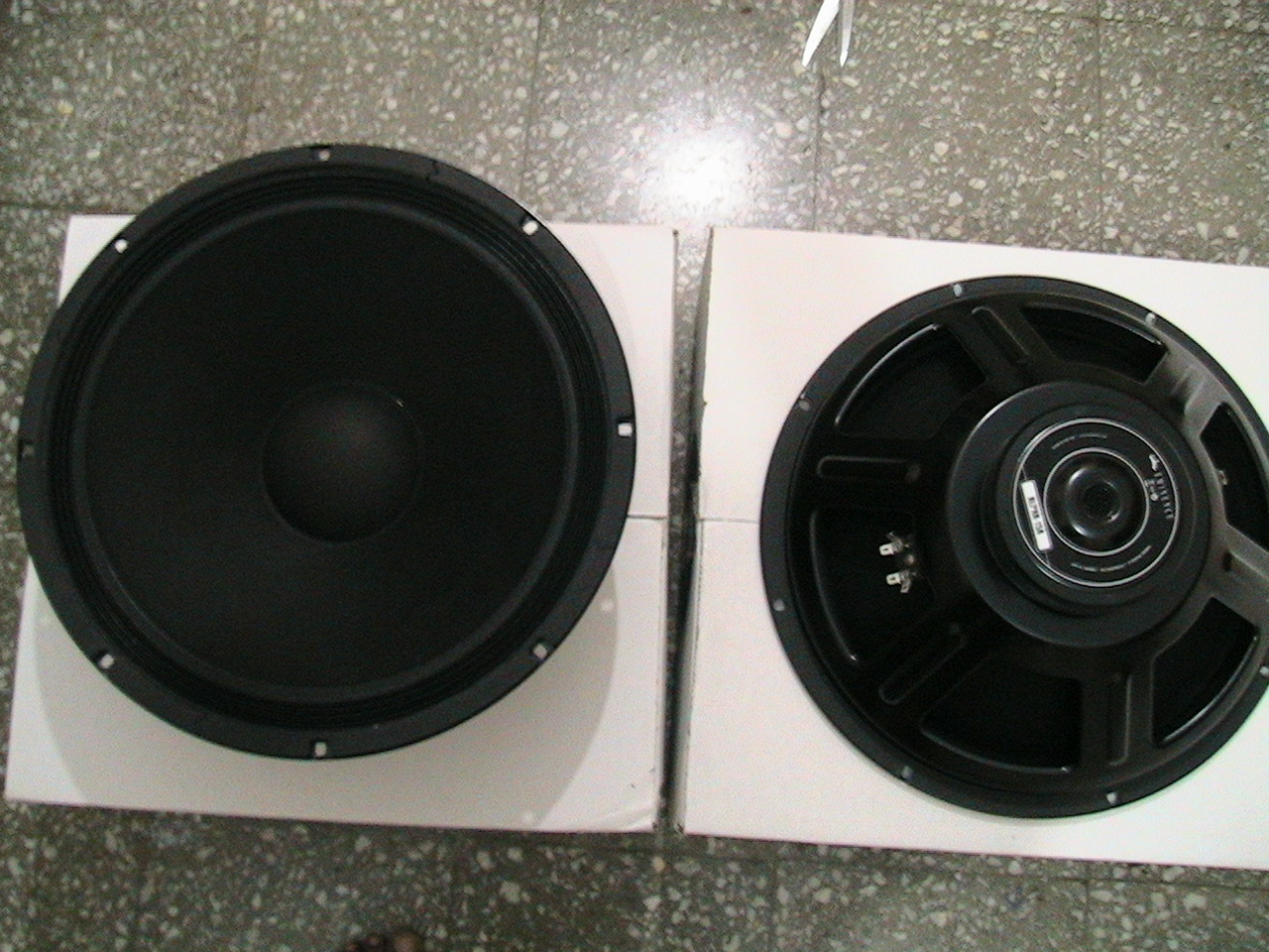

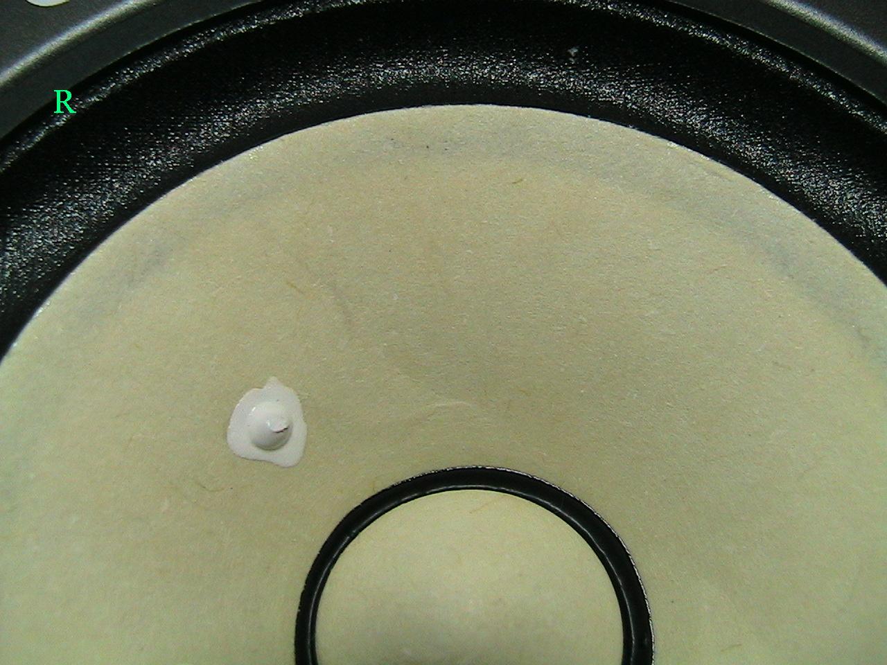

Replaced fostex damaged again
I received the replacement of the fostex fe103en from madisound.
This was also damaged (most likely by some custom official). I attach
some pictures of the damaged driver and also of the undamaged
driver. Can someone kindly tell me if the damaged one will still work?
The investigation regarding the fostex drivers damage is ON by both
madisound and fedex courier.
Some pictures of the eminence driver are also attached.
Best regards
Roushon

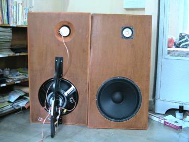

Finally the beast is back on its feet and roaring on the King's OB. Will post the pics
of the OB soon as I designed the back support of the baffle differently.

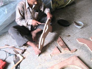

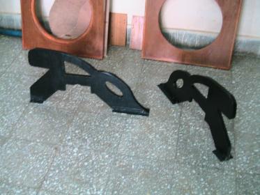

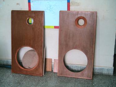

photos
The baffle is 5 degree tilted towards back. The polish was not good as I did not
find a competent carpenter. But he did a good job in cutting and making the back support.
Roushon
Roushon

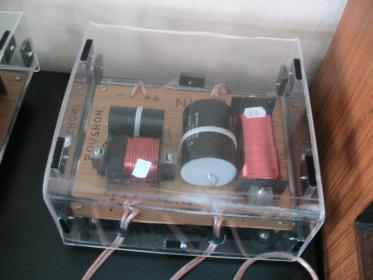

Two questions
Now that I know somebody shows interest in my project I can ask a couple of questions.
1. In second order crossover the tweeter needs to be connected in reverse polarity, but
in the MJK's notes it is maintaining polarity. Is it because the fostex is a full range driver?
2. Due to lack of availability I replaced the 9mH inductor by 10mH and the 68mfd cap by
70mfd. Is it OK?
Thanks and regards
Roushon
70mfd. Is it OK?
Thanks and regards
Roushon
answers
I believe the answer to question one is "correct." However, I am no where near an expert on this.
Question two... it depends. I built mine with the H-frame, but ordered the parts for the plain baffle before I discovered this option. I left mine with the 9mH and 68mfd and haven't looked back. The 15A is an interesting animal. I did some research when I realized my "mistake" and found a lot of variables among people using it. One person thought it was too muddy X-ing at 200Hz, so he lowered it to 125Hz. Another person runs it with no X-over at all and just raves about the natural sound of his. I think it comes down to room acoustics and personal tastes. Running mine X-ing at 200Hz is just plain delightful to my ears in my living room.
I work in a concert hall (just got home from work @ 11:30pm) and I really like the balance I get between the FR and the 15A in my living room. I listened to an orchestra tonight perform Beethoven's 3rd piano concerto and Mahler's 4th Symphony in our big concert hall, and when I get home and listen to these speakers the balance of the bass frequencies is spot on. Most of what I hear coming over the radio, or on other people's systems, is an EQ curve that is really heavily skewed towards the bass regions. After a couple of weeks of listening to these with a more realistic balance, I actually reset the EQ on my car stereo pulling down the bass.
Hope this helps!
Hope this helps!

I just saw the pictures of your H-frame OB in your profile. Nice painting and
the system.
Regards
Roushon.
EXPLENDID !!!
Since you've made such rear holder and you aren't going to make it heavier
by adding wings , why don't you put three spikes to hold the cabinet !?
just guessing ...I don't know if particular benefits may arise or not.
Surely the wings will do (smthtg)
EXPLENDID !!!
Hi Pico!
It is nice to see you back. I also thought of adding spikes, but
not sure if the gap between the baffle and the floor will affect the sound.
I did see baffles on the net which has spikes. May be I will try it...
Thanks and Regards
Roushon
It is now very long time since I logged in last. How are everyone doing? Giving life to this thread again as my Open Baffle is dead. It was
kept unused for some time and termites have sneaked in (Mumbai weather is very humid). It looks the same except the weight, it is hollow from inside. I am really sad. Fortunately the drivers are in perfect condition. I need to look for better materials for the baffle. Searching the net. There are many suggestions.
1. Plywood, 2. mix of plywood, MDF board, 3. mix of plywood, MDF board and acrylic, 4. only acrylic.....even sand filled...
Only acrylic sounds good. But what should be the thickness?
Help me with the best possible...
Regards
Roushon.
