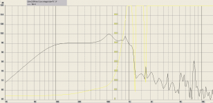

So I finaly got around to fiddling with my 2-way Synergy horn SH95 clone employing the Faital HF146 along with twice Faital 8 FE200.
Here's what I don't get in relation to the Synergy patent:
You must not cross any lower then the flare rate dictates
With 90x55 this translates to CD flare rate ¨1250Hz
- Looks as if the B&Cs 8 NDL are crossed way lower then this, my guess is ~900Hz
Another thing that I can't wrap my head around is the flare rate of the mids:
700Hz (a~192cm) which translates into a flare rate of ~475Hz
Apparently this means that the SH95 doesn't follow the Synergy patent at all, that is, the mids doesn't really benefit from horn loading below 475Hz
I've been trying to follow the Synergy guidelines stricktly but I'm confused😕

I wouldn't assume the commercial speakers were designed before or necessarily per the entire patent.

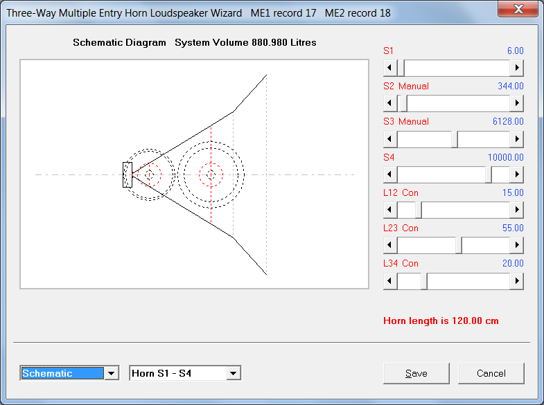

Use Hornresp to model, it can include all the features of offset (Synergy style) horns as well as the bass reflex aspects.If you model a "regular" 6th order band-pass it seems that the front chamber volume turns out much to big....

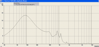

With the Faital 8FE200's 80 Hz Fs, using the bass reflex output you should be able to get a Fb in the 80-100 Hz range, at which point co-location of the sub woofers is not required for good imaging, and the subs can be placed for optimum room response.

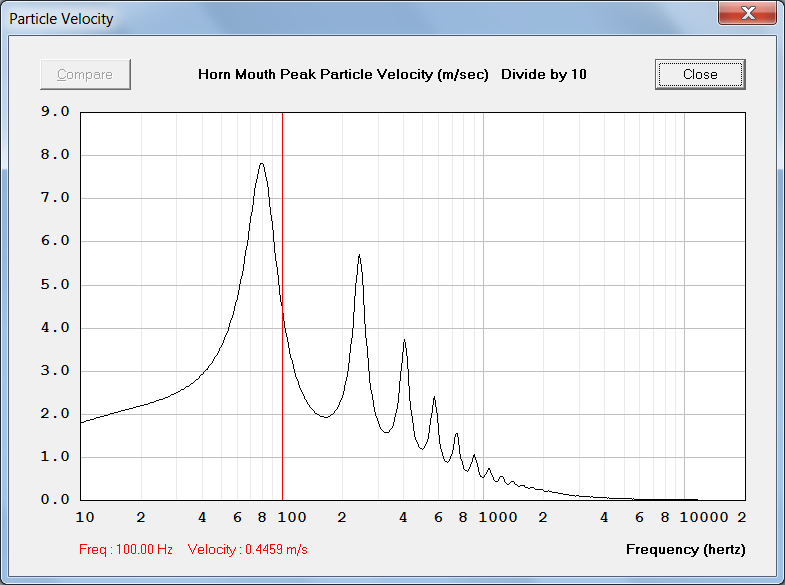

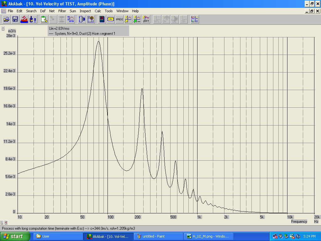

I know hornresp, but I normally model in Akabak, as it's more acourate when it comes to port velocity?
In my experience Hornresp and AkAbak port tube volume velocities (and therefore particle velocities) are identical, provided that end correction assumptions are similar.
Attachment 1 shows AkAbak volume velocity where cross-sectional area = 0.035 m2.
At 100 Hz:
Volume velocity = 15.6 * 10 ^-3 m3/s
Particle velocity = volume velocity / cross-sectional area
Particle velocity = 15.6 * 10 ^-3 / 0.035 m/s
Particle velocity = 0.4457 m/s
Attachment 2 shows the equivalent Hornresp particle velocity result.
The 0.0002 difference is due to the 15.6 coefficient in the Akabak volume velocity value being rounded to one decimal place.
How are you measuring the port tube air particle velocity, to be able to say whether a simulation prediction is accurate or not?
Are you measuring at the port tube inlet, or the port tube outlet?

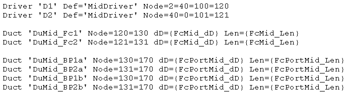

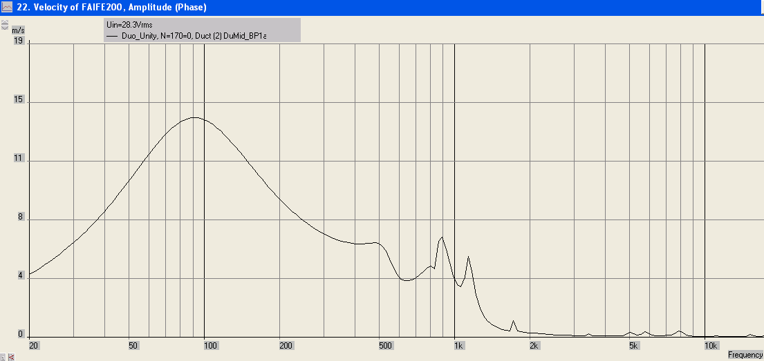

Hi David,
Thank you for your input.
That's a good question. Attached is script and port velocity sims at node 130 and 170. They show identical velocity, Am I measuring at inlet an outlet?
