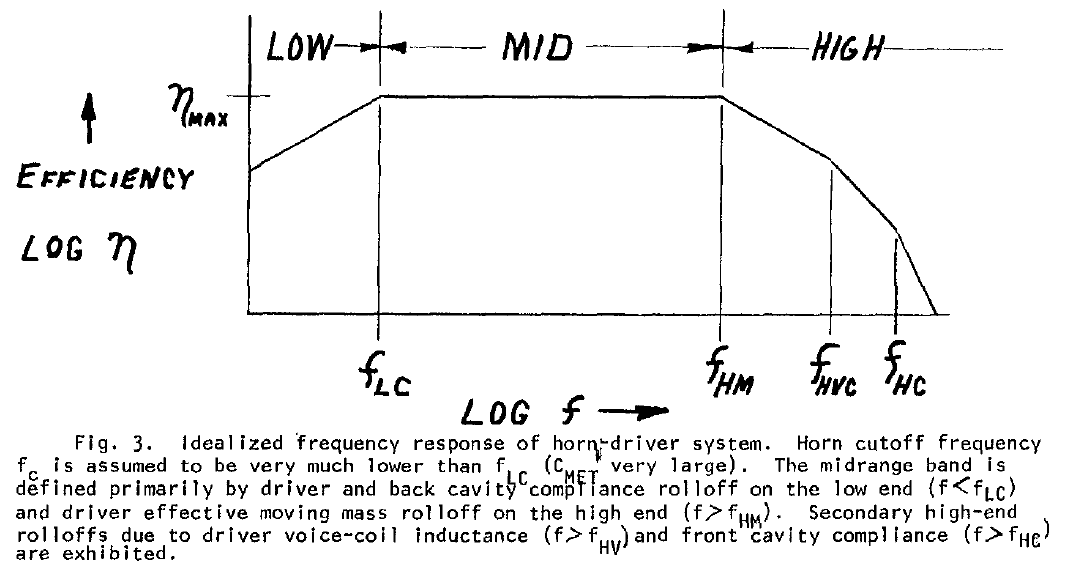

poor fidelity because it is full of distortion products and is not a faithful reproduction of the original signal
When you say distortion products, do you mean harmonic distortion? Below 1kHz I still have lots of panel vibrations because I am using thin foam core to prototype and it has not been braced. Above 1kHz, which I believe is above the mechanical resonance modes of the material, the harmonic distortion is quite low at circa <0.5% THD.
I hear what you are saying about the upper cutoff of a horn as described by the masters of horn design. What do you mean by
Tractrix beams to a point of non-usability at approximately 20 times it's flare rate ?

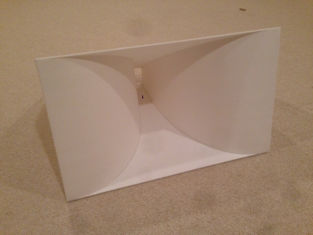

It's interesting how folks who haven't tried a 5MR450NDY and who haven't coupled it to a tractrix with a 2.78 in square throat that is 22 in long x 28 in wide x 17 in tall with a sealed 5.25 liter back chamber, who haven't made measurements, who haven't listened to this particular setup in person, continue to say it doesn't work. I have been down the BLH road already. I have built other horns and have seen the limitations you describe. For some reason, this particular driver seems to work exceedingly well. There is clear 15khz reaching my ears and my mic even 4m away and it sounds clean. Less than 0.5% HD. Not sure why I am at a fork in the road, I think I found a road that for some reason wasn't open before because we did not have this driver before.
That horn looks fairly decent to me. Between 6k-9k it looks like there's some nastiness with the polar response, but from 3k-6k it looks like fairly constant directivity and then it widens out to omni below there. Exactly what you'd expect. Of course you have that problem at 1.4k in the response. It looks like below 6k you're about -6dB at 30 degrees, so 60 degrees overall. That's a moderately tight beam, but very useable if you set the system up right. Looks like you'd want a super tweeter above that - something with matching DI at the crossover ideally.
Figuring out where it's loading - look at the acoustic impedance predicted by hornresp. Otherwise you can measure it, but that's not as easy. Using a horn where the driver's power response is falling is not a bad thing. JLH et al do it all the time with their Unity / Synergy horns - most compression drivers have their power response rolling off above ~4kHz. You just need to make sure your driver isn't going into breakup. Easiest way to do that is to look at the frequency response of the raw driver (not on the horn) and look for big dips and peaks. Looking at the plot in the manufacturer's data sheet, it looks extremely smoothed, so I wouldn't pay too much attention to that. A better way would be to measure your horn using boinks and see if the boinks stretch on much longer in time than the input signal. See linkwitzlab.com for details. Or you could look at an energy time curve, but I always have less luck with those.

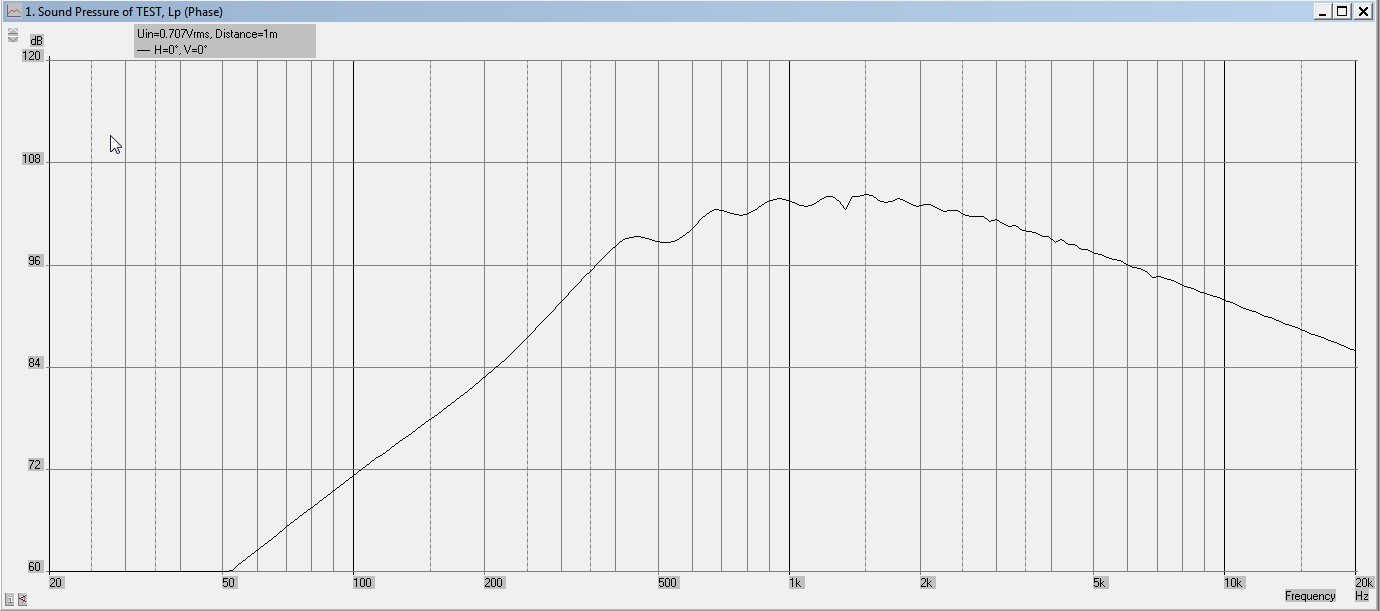

Thanks for the constructive comments and glad that you think there is some potential here rather than dismissing it. The manufacturer's frequency response data actually seems quite accurate and matches what I measured. Another member actually superimposed them on the other thread. For a driver that has a very stiff cone, stiff suspension, and huge Nd motor, would not horn loading it, reduce excursion below what it would be in a regular sealed alignment? And would this not further reduce HD due to small displacements?
Here is manufacturer's and my measurements superimposed:

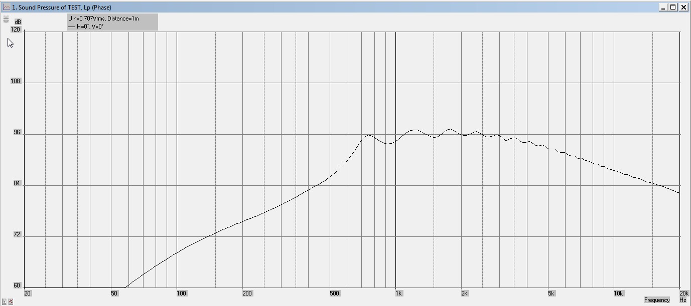

I have fill in that horn with the 5MR450NDY speaker on hornresp and export to akabak for extend frequenty sim, and iot looks that it do fall off above 3 kiloherz.
I do not understand for such speaker with a big motor that qts is fairly high, heavy cone? then it can not go wel untill 15 kilohertz but the measure let see output there.
Horn need light cone, big motor and low qts, 0.20 is very good.
