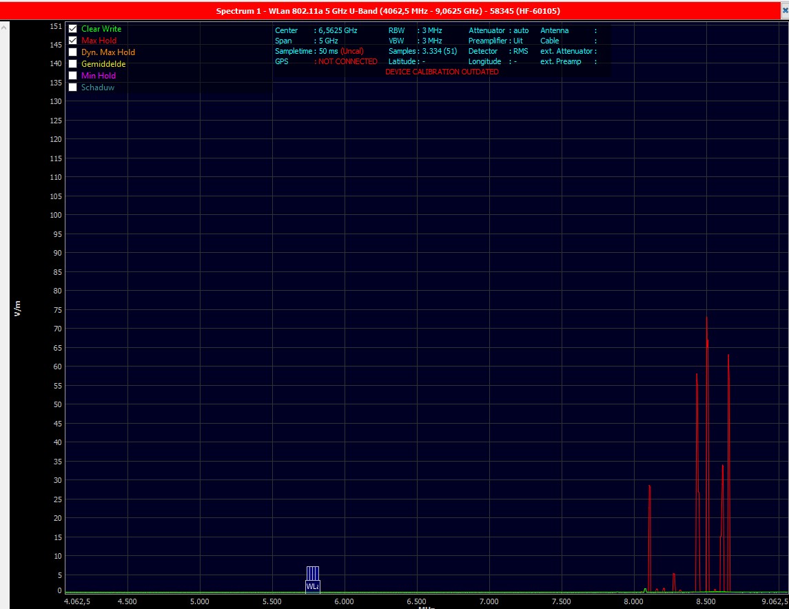

Offtopic but my nabure do like it to radiate me with a radar transmitter, I did measure 71 volts/meter or 13,3 watts on 8.5 gigahertz, that is reason of al the interference on equiptent and my headage of noisy ears.
not someting to be happy about as sensitive person, and so she try to get my out of my house, she do not like me, the only reason.
tomorrow I go take staps. big ones.
regards kees

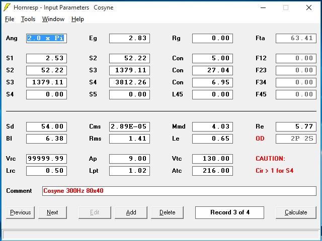

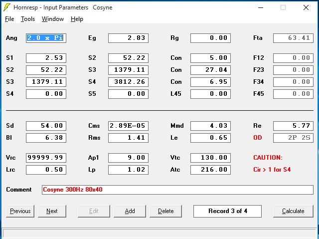

Downloaded and updated to the latest version of Hornresp but can't seem to bring up the Ap1/Lpt combo, no matter how many times I double click.
Oddly, I can only get these two sets of combinations, Ap1/LP and Ap/Lpt.
What am I missing?
What am I missing?
Hi InOtIn,
A slight change was made to the port label names some time ago. The current names are as given in the Help file:
Ap - Vented rear chamber port cross-sectional area (sq cm).
Lpt - Vented rear chamber port tube length (cm).
Ap1 - Throat port or throat adaptor entry cross-sectional area (sq cm).
Lp - Throat chamber port or throat adaptor length (cm).
Kind regards,
David
