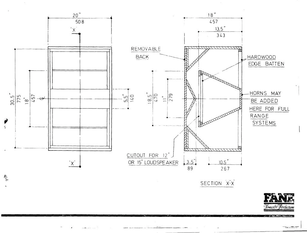

They fit snugly into a folded 'W' bin. 24"W x 28"D x 36"H. You face the speaker at the rear sheet of 1" Birch Pine mounted in the 'W'. Standard design by Gauss Loudspeakers, circa 1970. Taken on board by many manufacturers.
Here is an example used for 15" speakers, just increase the size BUT it is important to use hardwood ply.

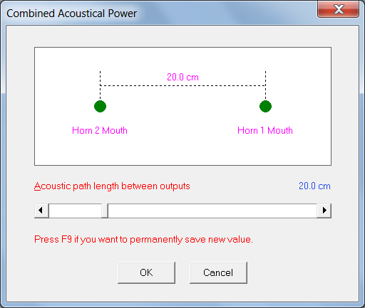

Thats good to know, thanks. Now I'm really keen to use Hornresp. Is there a guide for getting Hornresp to model an H-frame for dummies?
I bumble around in Hornresp but cant find where to load the path difference. Read the guide and searched the net and still stuck. I played around with the Hornresp wizard until I got an H-baffle shape using the setting below. Played in the Tools but still couldn't find the path difference box. 😕
After calculating the acoustical power response, select Tools > Output > Combined.
Also see this post:
http://www.diyaudio.com/forums/subwoofers/119854-hornresp-833.html#post5452029
Thanks David - I got it now, my mistake was not clicking on the "Combined" function - I saw the Combined was pre-selected so didnt click on it and searched elsewhere.
