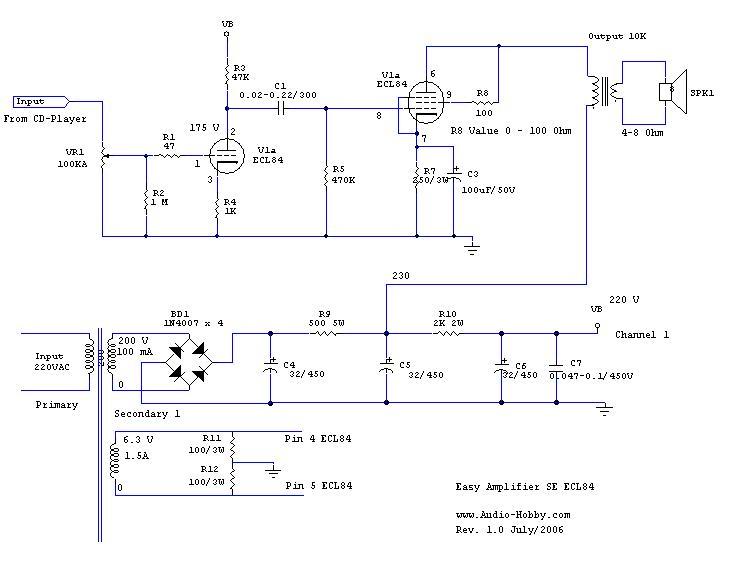

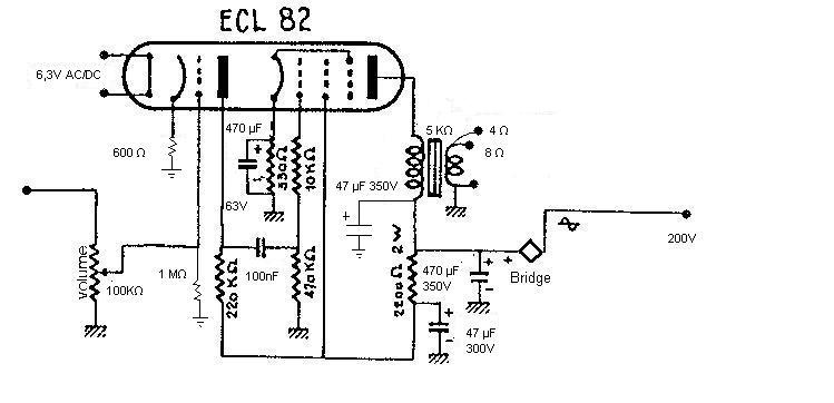

is the ECL84 interchageable with the ECL82? What I meant to ask was, to make a SE ECL84 amp (I have 4 of these tubes) Can I take an ECL82 based circuit and use it?
Thanks for any help!
No, they are significantly different tubes (both sections of each tube differ) !
There are ECL84/PCL84 schematics avaliable online, have a look at them.

Can anyone link me up with a Schematic for a ECL84 amp? Other than the one in this thread?

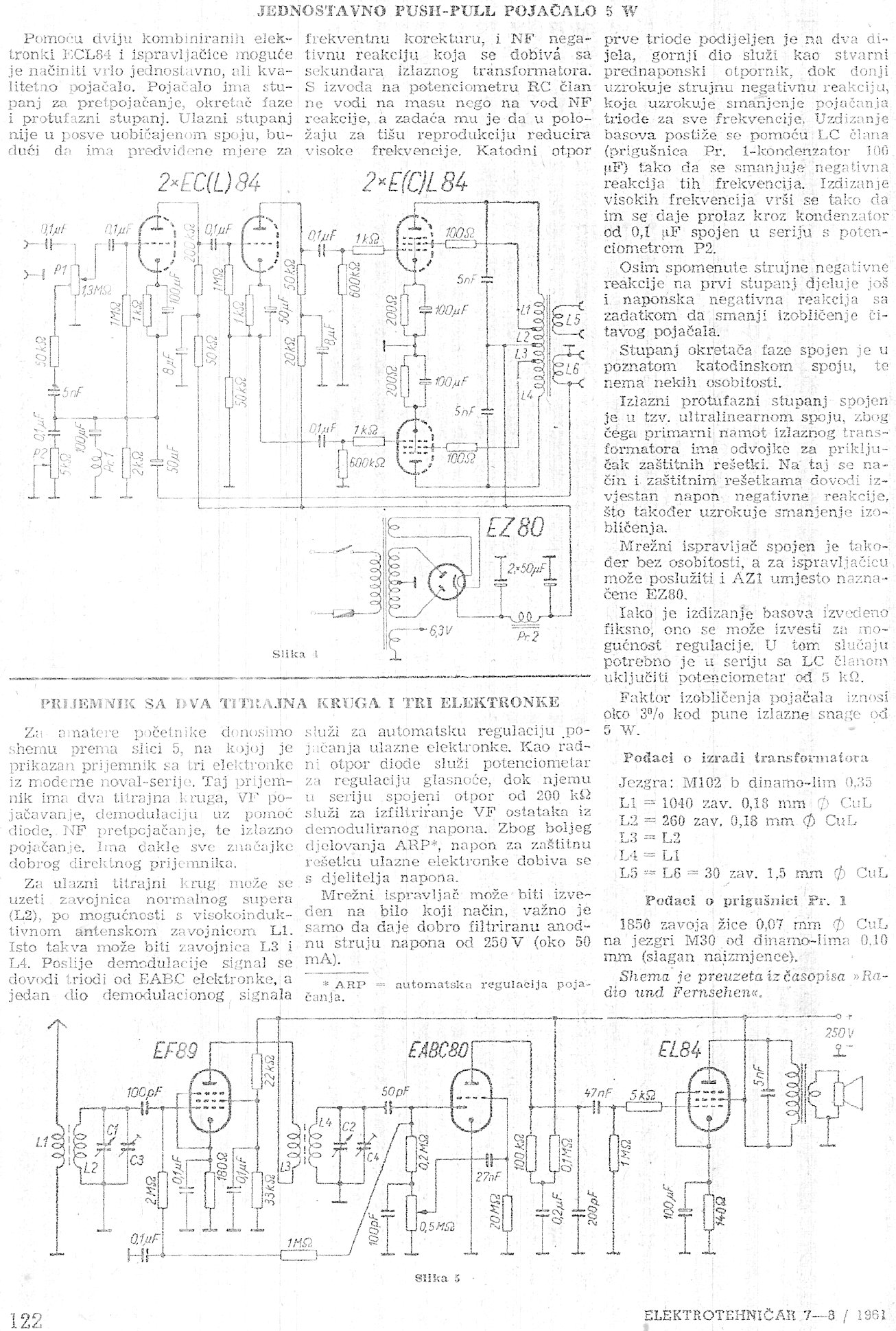

The 6DX8/ECL84 was used for audio purposes in Australia during the 1960's. The local Philips subsidiary published a valve data book which included this information:
Much more recently I have been using push-pull 6DX8's in a 2-watt guitar amplifier.

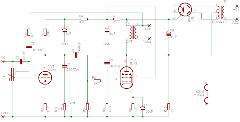

I believe I posted the schematic I built on a breadboard, it should be optimised a bit but it is a starting point. I intended to do just that but then changed my choice of tube to PCL805 about halfway through due to parafeed connection and consequently low Va (as mentioned in another thread).
