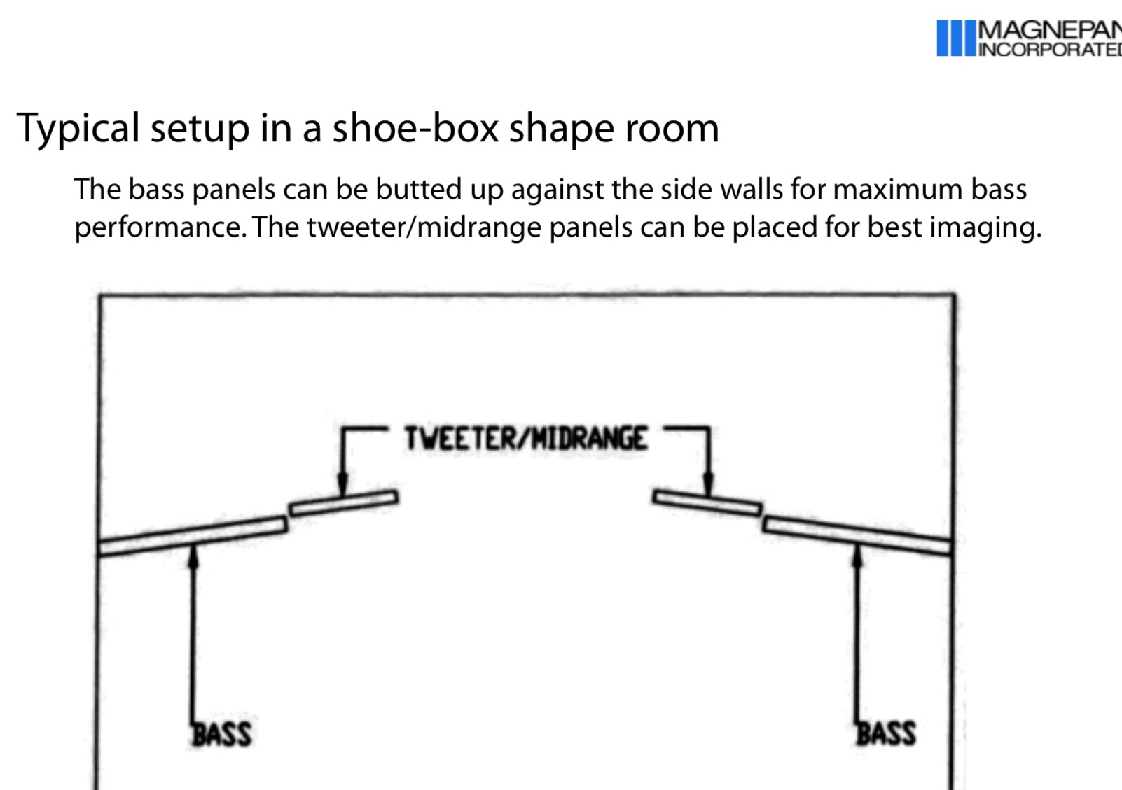

I wouldn't expect bass below 40Hz either with MG1.6's but with 2 dedicated bass panels, I expects more from the Tympani's.
Have you tried this trick ? You will gain some low end for sure. Magnepan recommends this for the 30.1.
I have them set up like this but about 5 feet from the side walls. Best I can given the room.
