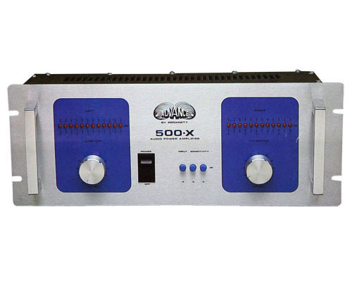

hello to everyone. I follow the forum and greatly appreciate the high level of discussion. This is my first post in the forum. I am rebuilding an amplifier of 80 years, and would like suggestions to replace all the transistors and other components that result in improvement for most current devices. I would be very grateful for any help. Attached goes the photo of the "thing" andtechnical data are:
Sorry about the english.
POWER: 400 Watts RMS p / channel (4 ohms)
P 250 WATTS RMS / channel (8 ohms)
. FREQUENCY RESPONSE: 10 Hz to 80 kHz - 3 dB
. Intermodulation Distortion: Less than 0.02%
. THD 100 W @ 4 Ω: less than 0.01%
. Damping Factor: 300 at 1 kHz (8 ohms)
. NOT BALANCED INPUT IMPEDANCE: 30 K ohms
. Input Sensitivity: 1.23 volts (+ 4 dB)
. Signal to Noise: Better than 95 dB
. MINIMUM LOAD IMPEDANCE: 4 OHMS
. CIRCUIT CLASS: AB
. WEIGHT: 20.2 Kg
. DIMENSIONS: L: 19 "A: 7" - 4U P: 14 "
. POWER: 115 / 230 VOLTS
. 115 VOLTS MAXIMUM CONSUMPTION: 1400 WATTS

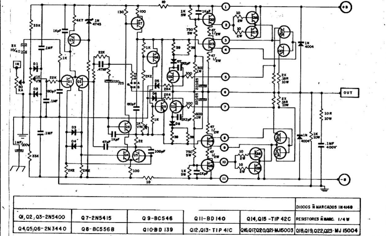

Welcome. I doubt if your amp is 80 years old, transistors weren't invented until 1958. Usually when I rework an amp over 25 years old, I replace the electrolytic caps and the tin plated RCA connectors. Band use amps can have worn out banana jacks or 1/4 phone jacks. On amps with a fan, I replace it with a long life model. Of course, general cleaning of dust dirt and new filters is good practice, especially the heat sinks. I use water and a paper towel, sometimes a little bathroom cleanser like scrubbing bubbles, but I put it on the paper towel. A pick is required to scrape around the tiny components.
For example, the 47 uf cap near Q4 and the 100 uf cap near Q5 are probably electrolytic. You may have other larger more seriously dried up caps in the power supply near the transformer. All these caps will have a plus on one lead, or a minus sign in balls pointing to the minus lead. Most consumer products were built with 1000 hour rated caps sealed with rubber (electrolytic caps have water in them). A T and M prefer to measure the caps for value & ESR before replacing, but the meter to do that is $150 or $90 kit. I just replace them, they are not very expensive. If the amp is working now, replace 1 or two parts at a time and test that it sounds okay or better after that, to prove your solder joint and parts quality.If not backup and rework, or rethink. I buy all the electrolytic caps at once, to save on freight, which is much as 100 small caps. You can buy 3000-8000 hour rated caps if you try, these will last longer than 25 years perhaps. Farnell.com has the hours rating in the selector table, other vendor like mouser link to the manufacturer's datasheet, which you have to read. They stock a lot of cheap short life caps, so it takes some work to screen them out. Also, surplus caps on E-bay etc may be long into their shelf life, or even past it. I buy surplus film and ceramic caps, but not electrolytic caps.
The transistors tend not to be defective unless the amp has been abused by shorted speaker wires, bad fan, or a shorted capacitor. If the amp is dead, another set of test and measurement skills is required, report back.

Hello Indianajo. Sorry for the mistake. The amplifier was manufactured in 1980. I would likesuggestions to replace the old 2N5400, 2n5415, BD139, BD140 transistors by more current, lower noise, or better technical characteristics. The output of MJ15xx were destroyed .. I already bought these in FARNELL (On Semiconductor). I got the electrolyte source, are of the GIGAELCO low ESR, temperature of 105C. The diodes are replaced by a bridge 50A/1000v. Thanks for the post and any help is welcome.
After an output transistor meltdown, I have been informed that bringing it up gradually with light bulbs in series with the power cord, or in my case, a switchless 1500 watt room heater, is important for not stressing the O.T.'s. When I didn't, I blew another PNP O.T that had passed the double diode test, and it took out a new opposite NPN transistor. I had a lot of 1n4148's etc blown in my most recent transistor amp, and another leaky one just damaged an op amp, so in future after a meltdown I'm going to test them backwards with a 19VDC source and measure the current with the DVM, instead of using the DVM ohms scale which is 9v max. After the amp doesn't put DC out on the speaker hot line (I had a lot of trouble with that, burned PCB lands) then you can check your idle current on the O.T. emmiter resistors. My amp is reading 30 mv on .5 ohm emmiter resistors, so I guess a cold idle current of 15 ma is okay. I put terminal strips on the amp to make this measurement convenient from the t
Search under the parts forum for the 10 favorite BJT transistors. Mooly had a great list. I tend to buy whatever transistors farnell has on sale with enough Vceo and current rating, as my biggest noise
generator is still my op amp mixer I use to boost the magnetic phono and mix the FM radio with the CD player. With the mixer powered down, the ST120 amp is quieter than the fans I put on it. I used NTE49, NTE50, NTE249, and NTE60 transistors, all NPN, because that is what the stocking distributor had in town in 1985 when I repaired the amp. They are a bit pricey, and nothing special except for the high Vceo (the st120 runs 80 V Vcc) It is quiet enough now, the fan at the factory across the street 100 m away is noisier.
op.
Your emmiter resistors appear to be 0.1 ohm, so matching of the output transistors is probably important.
The experts on here say matching the saturated on voltage is more important than matching the gain. You may have to build a jig to do that, using a dvm. I don't have to on this amp I'm repairing, it has 0.5 ohm emmiter resistors and the service manual says it is designed to not require O.T. matching.

Hello Indianajo and llwhtt. Sorry about the delay, I was researching Dynaco ST416. Thanks for the tips. The emitter resistors are 0.1 ohm actually, I take care to combine the output transistors. I saw the NTE60/61 replacement as an option to MJ15xxx. But the output transistors are in a configuration feature that improves its response, so I thought about keeping them. llwht I didn't know the similarity between the schemes. Thank you! The amplifier does not have the pre of Dynaco. It hasn't output inductor and other small circuits, but the channel follows the same configuration. I'll look more closely at the changes and inform. It was of great help. Sorry about the English.

Yes the amplifier circuit is the same minus the "Dynaguard" and part of the power supply which is for the ICs. Since this is a James Bongiorno design you could start by following his recommendations, replace all pf sized ceramic compensation capacitors with like value Silvered Micas and replace the ceramic bypasses with same value film capacitors. Most of the transistors in your amp are much more recent than when the ST416 was made and are still available new. Many of the original Dynaco semis are long gone. That output stage was used in Ampzillas and SAEs of the period. Another simple upgrade would be to replace the 5-10% carbon resistors with 1% metal films. Also replace all of the small electrolytic capacitors with Panasonics or Nichicons.

Good morning. The mica capacitors are very expensive. Each capacitor is more expensive than the output transistors. What other could I use instead? Can I use the film in place of all ceramic tile?

Mostly ceramic caps are used for the low self inductance which allows them to suppress Radio Frequencies (RF). For example the 0.1 uf cap on the output, and the 1000 pf cap near Q6. These both should be ceramic or mica. Film caps are mostly wound, with a medium self inductance. There are new technology stacked film caps for switched mode power supplies, I don't know how the self inductance rates against ceramic caps. You must make sure Sony used no COG dielectric ceramics, which is temperature sensitive. Another thing you can do can reduce Z5U ceramic non-linearity is increase the voltage rating to the 50V maximum. If your ceramic caps don't have explicit voltage ratings but have a letter after the capacitance, then check the letter against the voltage ratings in the manufacturers datasheet. I've used some 50V aerovox gold ceramic caps in place of tantalum caps as input couplers, and with a <1.3V signal they sound quite acceptable. The original tantalum caps were low value, and the replacement tantalum caps had a frying pan noise.

Hello Indianajo. I will then keep the ceramic capacitors, mica are unfortunately very expensive. I will rely on the project over the ST416, the type and voltages of each capacitor. The amplifier is not in good condition, and I'm literally rebuilding. Some circuit boards, I'll have to rebuild. The amplifier has damaged tracks on the circuit boards of the output. I'll redo it. The board of the soft start is with moisture, and the relay does not look good. All capacitors have approximately 30 years. The transistors can not be trusted, some resistors do not keep the original values when measured (were heated). So I'll rebuild it entirely.

Heat damaged carbon comp resistors are frequently over value. I replace them with metal film resistors from multicomp or vishay at farnell. these have been made in India so far and on value. Metal film resistors are quieter than carbon comp in higher values (100k and over).
When replacing burnt circuit traces, I lift the component leads at the end and wrap the wire around the lead to get a good mechanical bond before soldering.
You'll need a couple of big resistors to test the amp output when done to prove it is not putting out DC. So buy them now and check the output of the power transformer with the resistors and a DVM AC meter. There is no point in spending money on components if the power transformer is damaged. I use 225 watt resistors, 10 ohm variable tap ones for 8 ohm mainly amps and 5 ohm fixed value ones for 4 ohm mainly amps.
I found NJW21194 transistors were $2.50 cheaper than MJ15003 at farnell. I used MJ21195 for PNP because it saved $1 each. I don't buy transistors on E-bay, too many fakes around.
