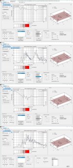

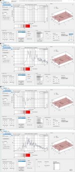

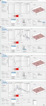

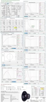

Alpair7_Gen.3_+_Reckhorn D-165
Hi grakka,All
FYI:
b🙂
Hi grakka,All
FYI:
b🙂
3_Alpair-7-gen3_Reckhorn D-165 in Sealed~6.5 liter-Box - Stereo Setup+Sub 1- 2-3 and 4.JPG592.9 KB · Views: 236
2_Alpair-7-gen3_Reckhorn D-165_ in Sealed~6.5 liter-Box - Stereo Setup+Sub 1 and 2.JPG583.5 KB · Views: 233
1_Alpair-7-gen3_Reckhorn D-165_ in Sealed~6.5 liter-Box-Stereo Setup.JPG584.8 KB · Views: 238
c_Alpair7_Gen.3_BW2-70Hz_Reckhorn D-165_HOLMImpulse-sum.JPG809.3 KB · Views: 232

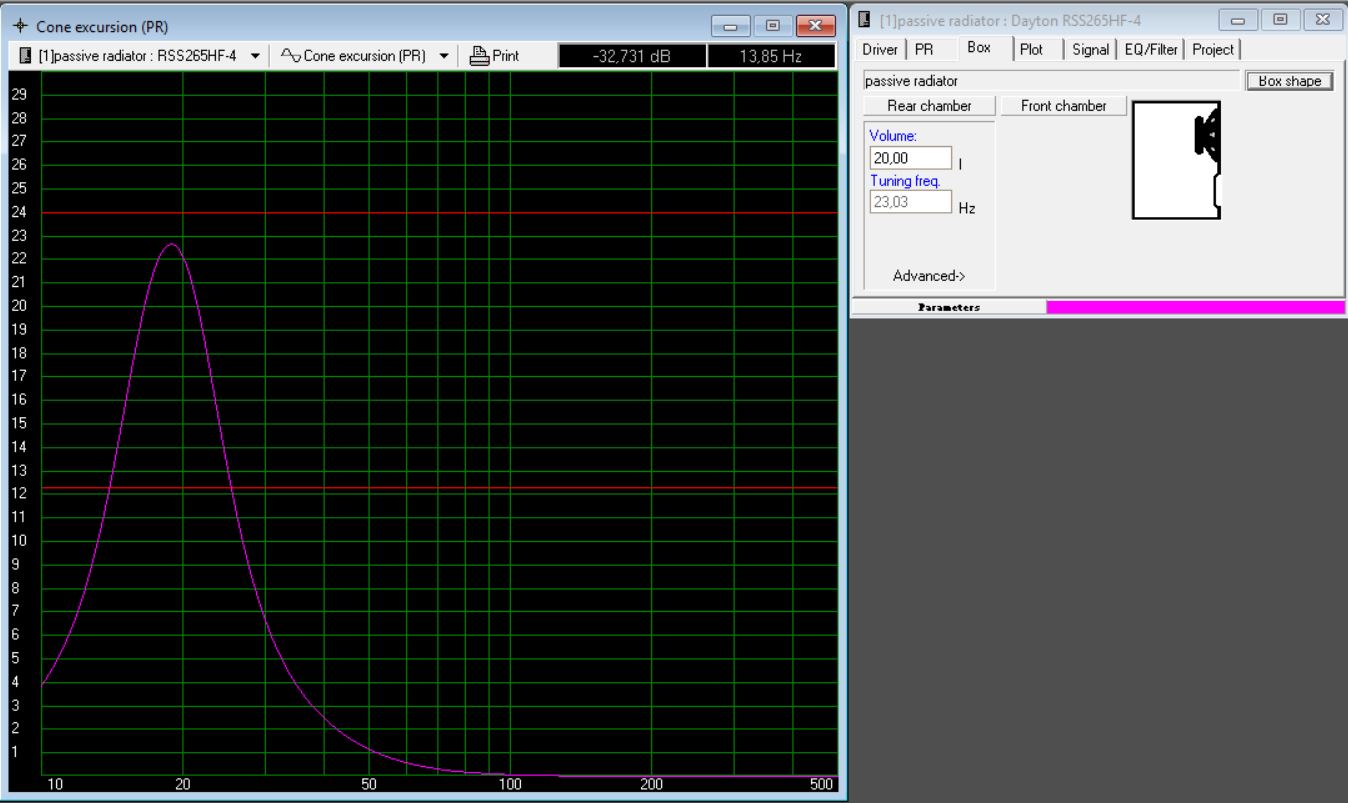

I've been thinking of maybe using a PR after reading about the Digger8 sub and Swope sub, they seems to be quite great subs both of them with PRs.
Made some calculations on the RSS265HF-4 and RSS265-PR in a 20L sealed box with 5 disks on the PR, 2nd order highpass filter with +6db at 20-23hz and about 80-100w power.
Please have a look at the WinISD simulations. How about the delay and impedance?
